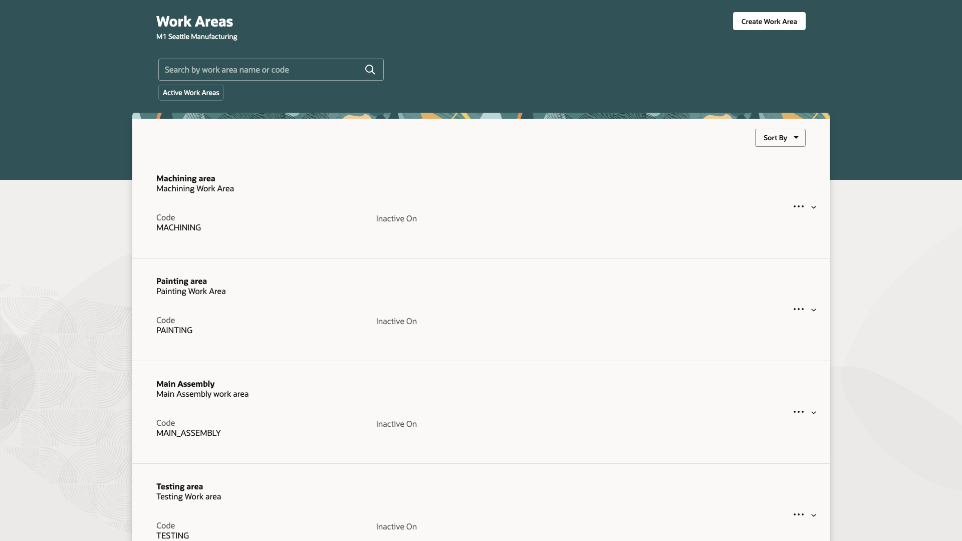

- Faster search and filter work area – Use keywords and filters to quickly find a work area to review and edit

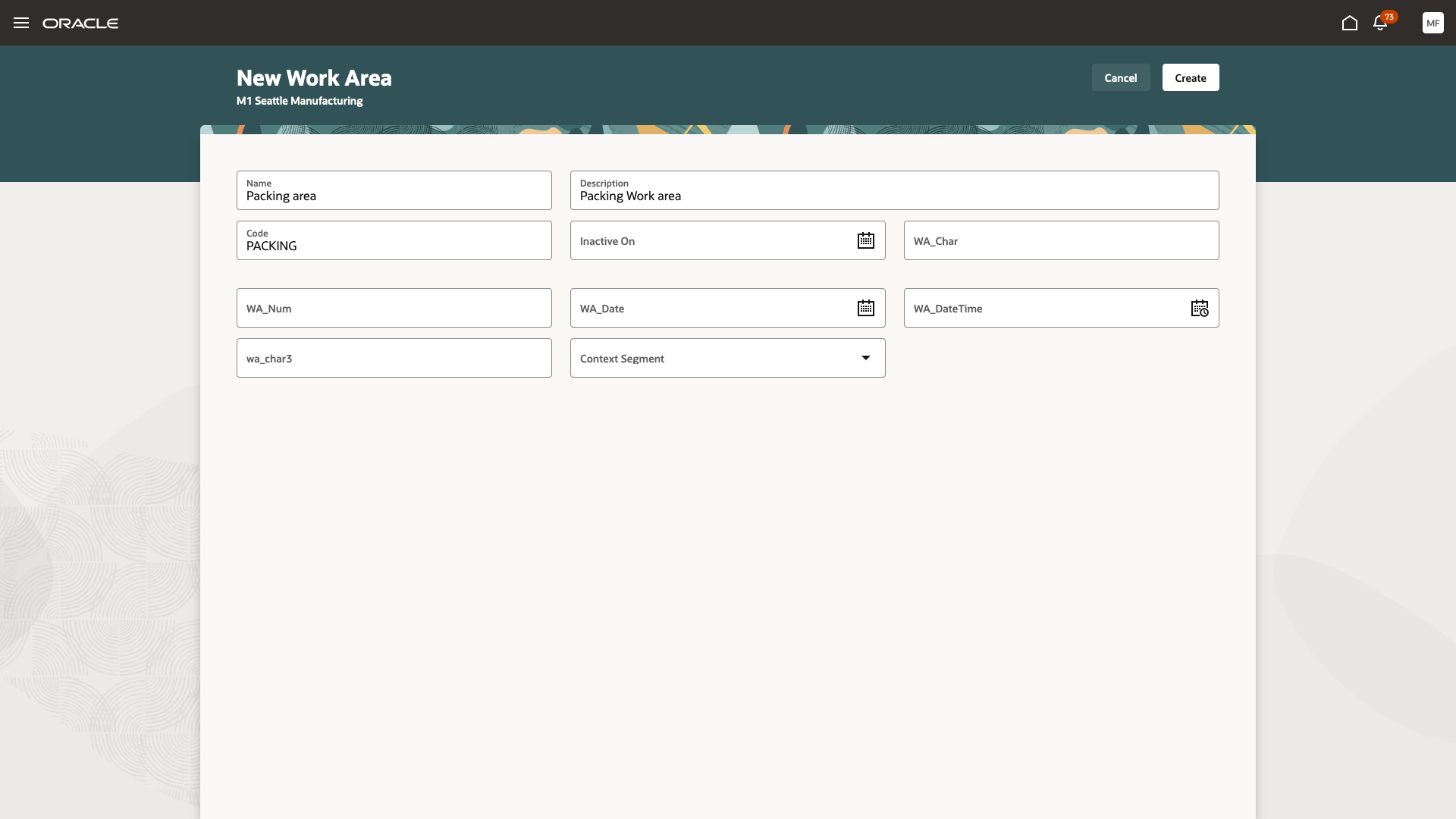

- Quickly create a work area – Enter the work area information on a single page

The Manage Work Areas task now launches with Redwood user experience. The page displays the work areas for a given organization. Here you can search by work area name or code and filter to see active work areas. You can use the Create Work Area button to create a new work area. You can edit an existing work area by using the overflow actions menu.
Search and Filter Page for Work Areas Using Redwood User Experience
Create Work Areas Using Redwood User Experience
Using a Redwood page, the definition and maintenance of work areas become streamlined tasks with a modern, responsive layout.

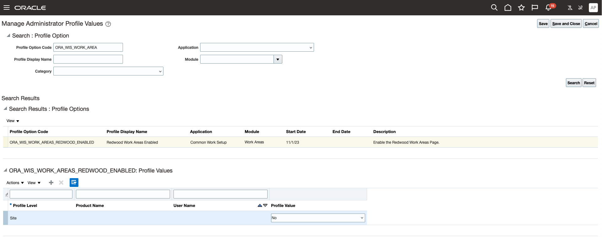

The Redwood user experience is enabled by default for searching, creating, and editing work areas based on the Redwood Work Areas Enabled profile option. Follow these steps if you decide to disable this feature:
- In the Setup and Maintenance work area, search for and select the Manage Administrator Profile Values task.
- On the Manage Administrator Profile Values page, search for and select the ORA_WIS_WORK_AREAS_REDWOOD_ENABLED profile option code.
- In the Profile Values section, set the Site level to No. The default value of the profile option is Yes.
- Click Save and Close. Changes in the profile value will affect users the next time they sign in.
Profile Option to Enable or Disable Work Areas Redwood User Experience
