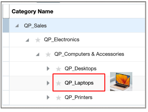

Go to the Product Information Management work area, then set up the category's hierarchy and assign the ABC Laptop item to the QP_Laptops category. For example:

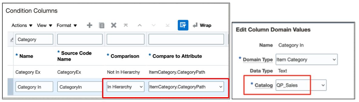

Use the Manage Matrix Classes page to set up your pricing matrix. Use these values:
| Attribute | Value |
| Comparison | In Hierarchy |
| Compare to Attribute | ItemCategory.CategoryPath |
| Domain Type | Item Category |
| Catalog | QP_Sales |
For example:

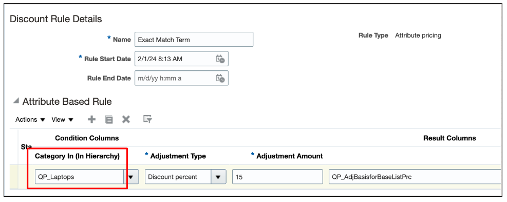

Create your rule on a discount list. Use the Category In condition that you created earlier in this procedure. In this example, every item that's in the Laptops category is eligible for a 15% discount. Set these values:
| Attribute | Value |
| Category In | QP_Laptops |
| Adjustment Type | Discount Percent |
| Adjustment Amount | 15 |
For example:

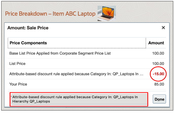

Test your work. Go to the Order Management work area, create a sales order, add your item to an order line, then examine the price breakdown. Notice that the breakdown says:
Attribute-based discount rule applied because Category In: QP_Laptops In Hierarchy QP_Laptops
For example:

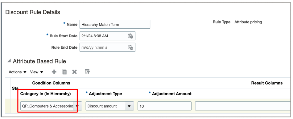

You can set up your rule so it uses a parent category as a condition. For example, if the Laptops category is a child of the parent Computers & Accessories category, then apply a 10% discount on the ABC Laptop item:
Set Up Your Rule So It Uses a Parent Category As a Condition

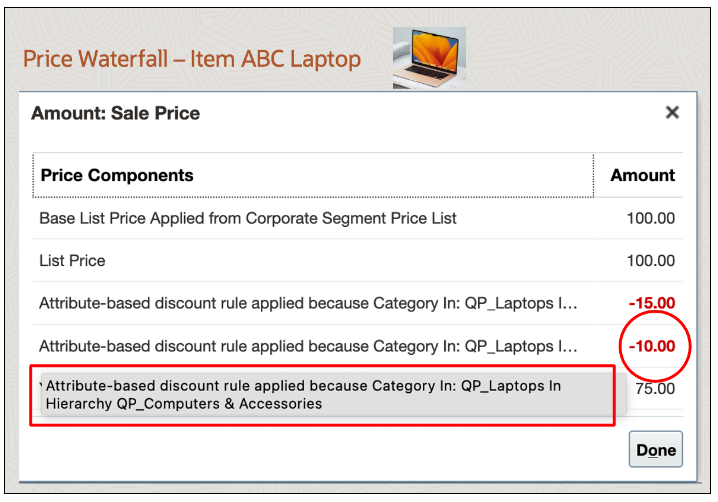

Attribute-based discount rule applied because Category In: QP_Laptops In Hierarchy QP_Computers & Accessories
For example:
Notice What the Breakdown Says

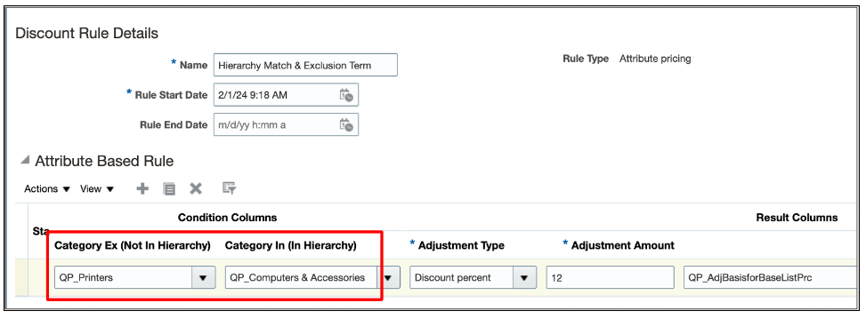

Assume you have a discount rule for Computers & Accessories and you need to exclude the Printers category. You need to apply a 12% discount on the ABC Laptop item, but don't apply a discount on the ABC Printer item.
Set these values:
| Attribute | Value |
| Category Ex | QP_Printers |
| Category In | QP_Computers & Accessories |
For example:
Exclude a Category
