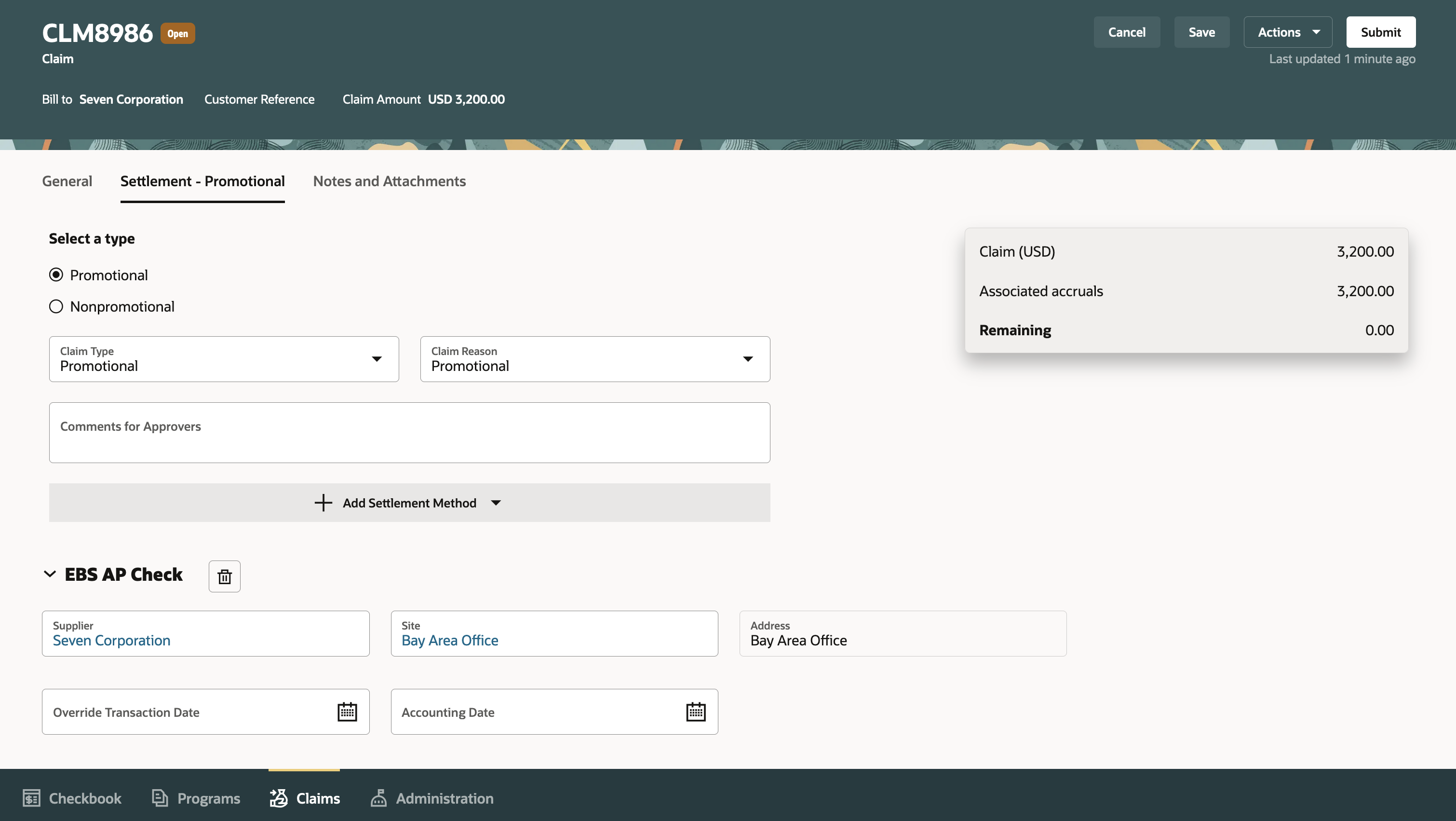

EBS AP Check as a Custom Settlement Method

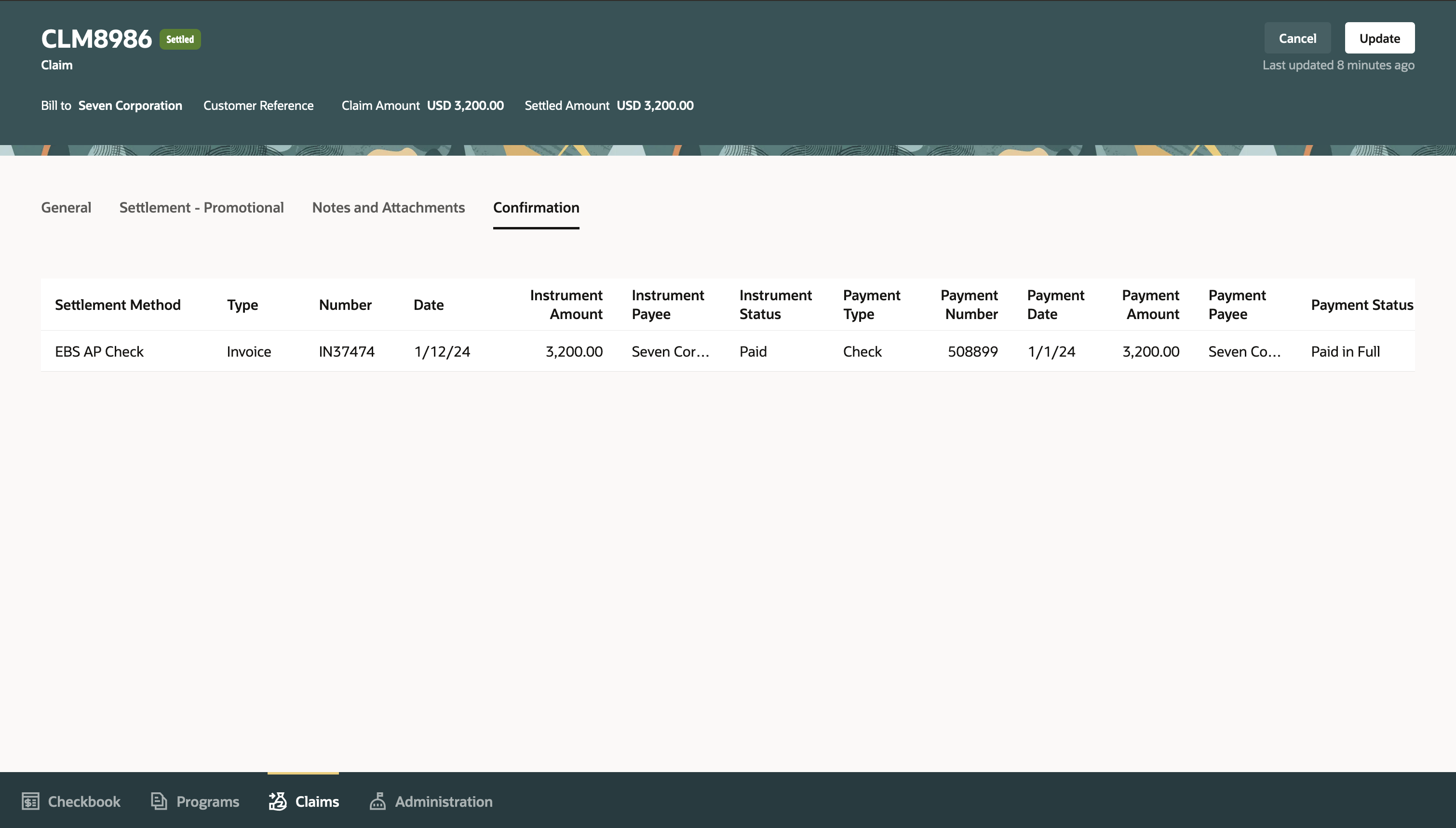

Confirmation of Claim Settlement by Custom Settlement Method

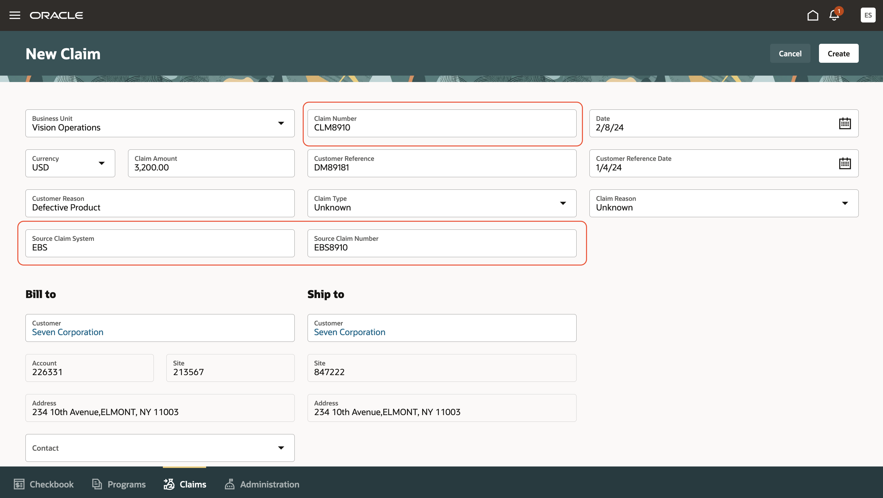

If you don't want the application to generate a claim number, you can provide one for a manual claim. Two additional source fields have been added to manual claims UI to capture the source system, and the claim number from the source system.
Manual Claim with 2 Source Fields and Editable Claim Number

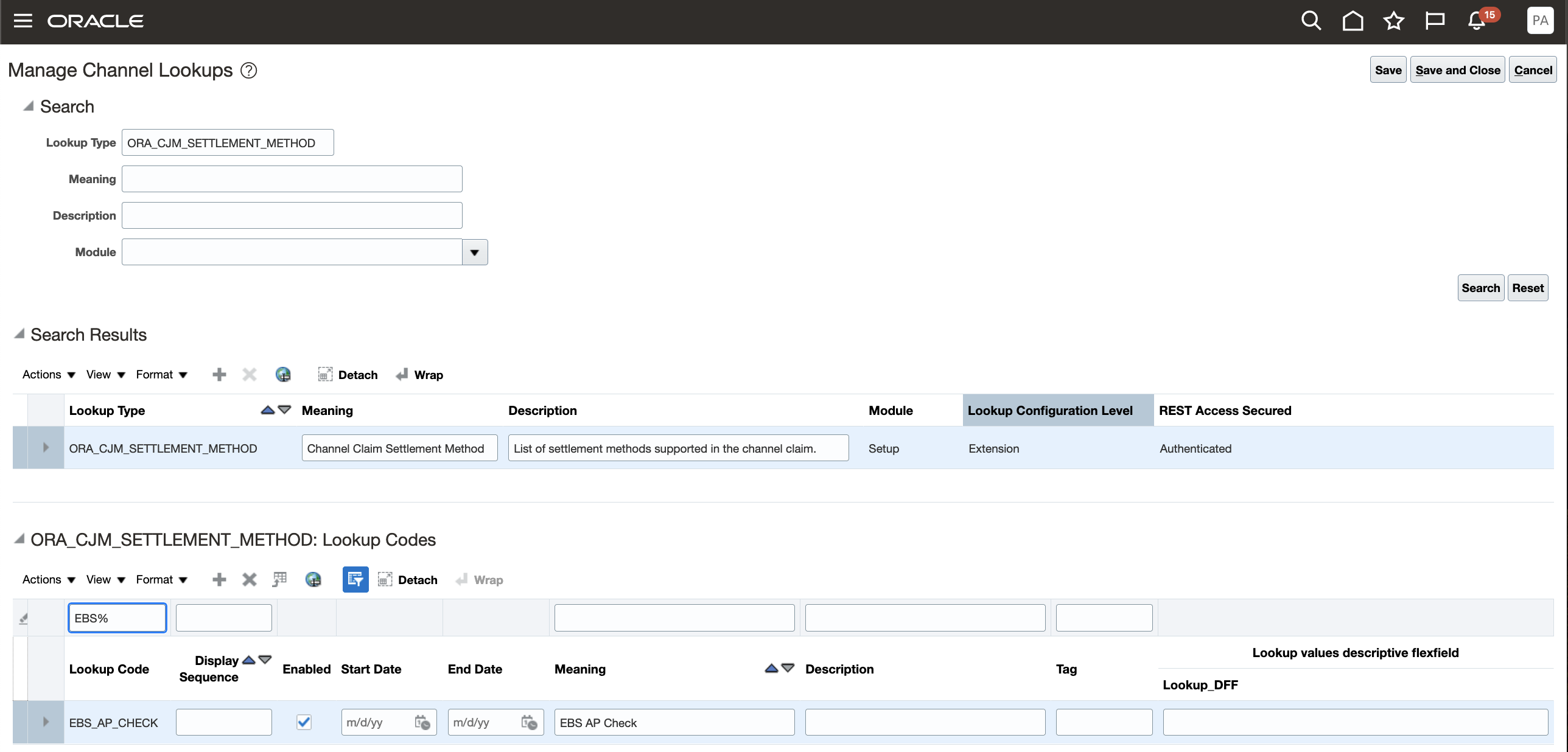

  1. Add a new custom settlement method to the ORA_CJM_SETTLEMENT_METHOD lookup.
  • In the Setup and Maintenance work area, go the the Manage Channel Lookups in the Channel Revenue Management functional area.
  • Search for lookup type, ORA_CJM_SETTLEMENT_METHOD.
  • Add a new lookup code representing the new settlement method.

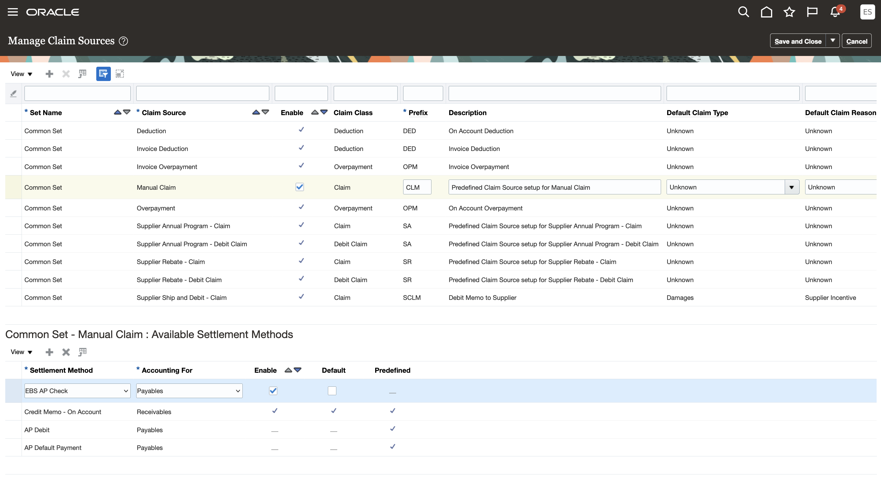

  1. Configure custom settlement method under its applicable claim source.
  • In the Setup and Maintenance work area, go to the Manage Claim Sources task in the Channel Revenue Management functional area.
  • Select an applicable claim source, and add a custom settlement method.
