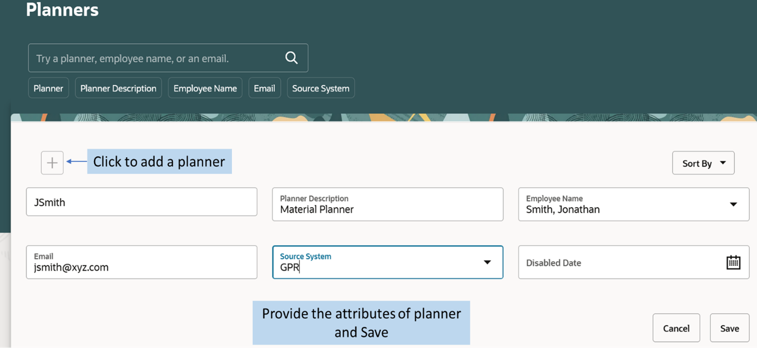

You can specify an employee of your enterprise as a supply chain planner in your enterprise and associate them to an item at the organization level.
You can add, update, or delete a planner using the new Redwood Planners page.
Add a planner
Add a Planner

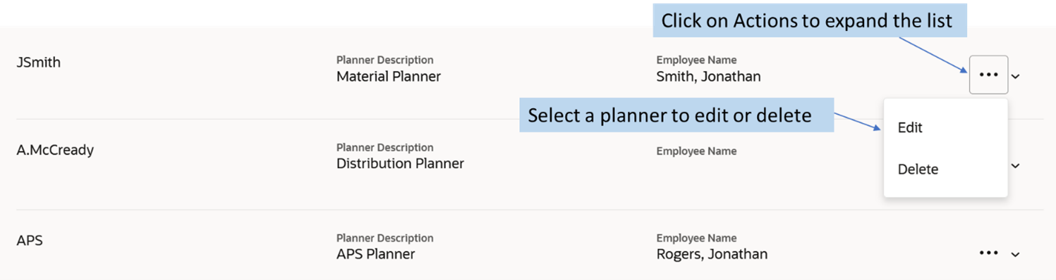

Use the new Redwood Planners page to edit or delete a planner. Select a planner and then click the Actions icon to edit or delete a planner.
Edit or delete a planner
Edit or Delete a Planner

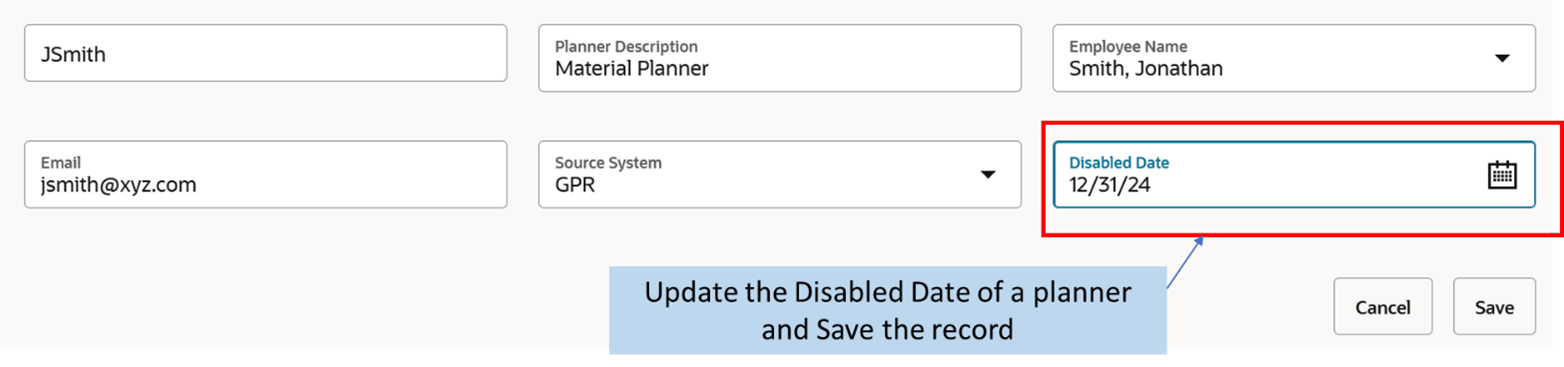

You can edit the attributes of a planner such as Source System and Disabled Date. Each planner is defined in the context of a specific source system.
Edit a planner
Edit a Planner

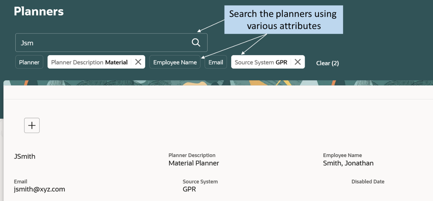

You can search and filter planners using a planner attribute value or simply start typing the attribute value. A minimum of three characters is required for the page to start showing matching results. The search is case insensitive.
Search planners
Search for Planners

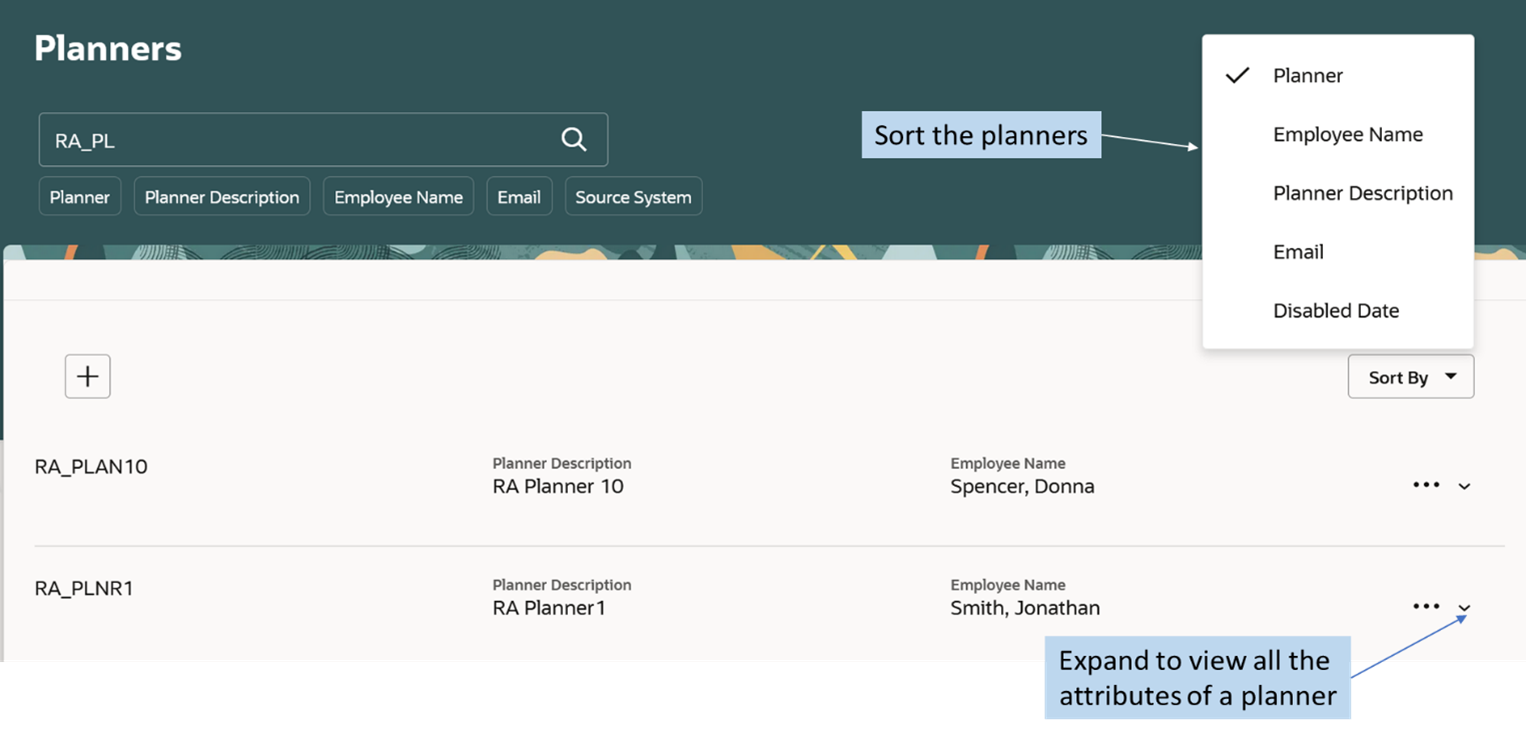

You can also sort planners based on any attribute. The sort type is ascending.
Sort planners
Sort Planners

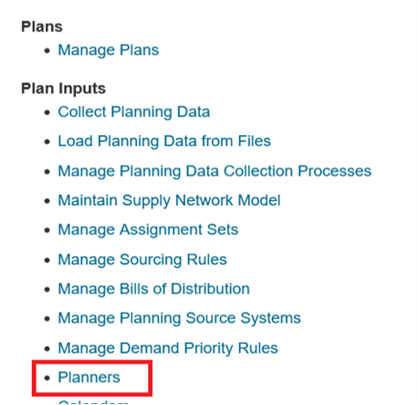

Click the Planners option to open the Redwood page in a new browser window.
