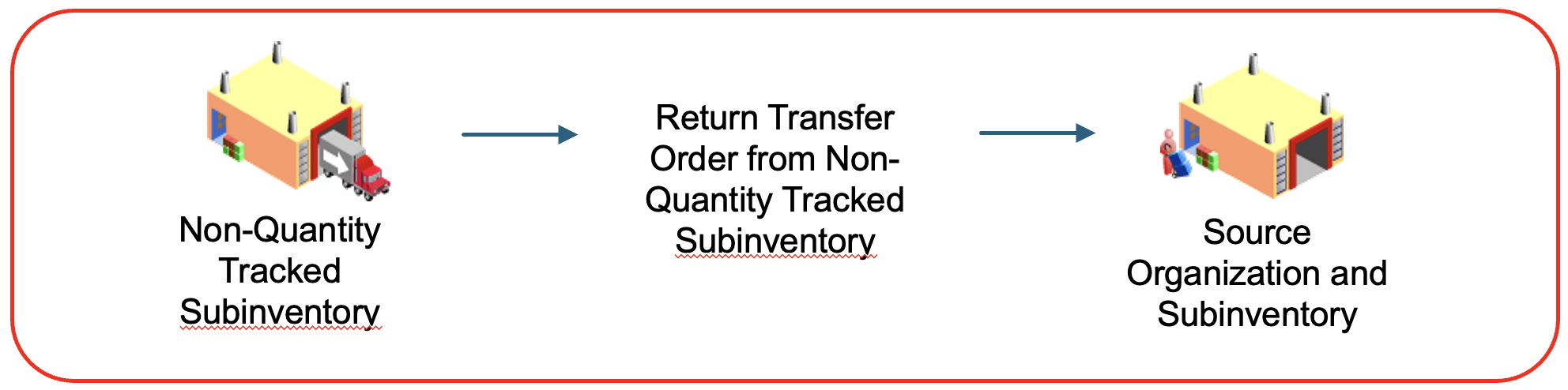

Return Transfer Order
This feature allows you to return transfer orders back to the original source subinventory associated with the transfer order. For example, a transfer order is shipped from inventory organization A to inventory organization B, and the transfer order is received into a subinventory that's not quantity tracked. You can now return the transfer order back to the source inventory organization. When returning the transfer order, you have visibility to the forward flow transfer order for which you are retuning against. This feature also allows you to return material from a subinventory that's not quantity tracked back to a supplier.

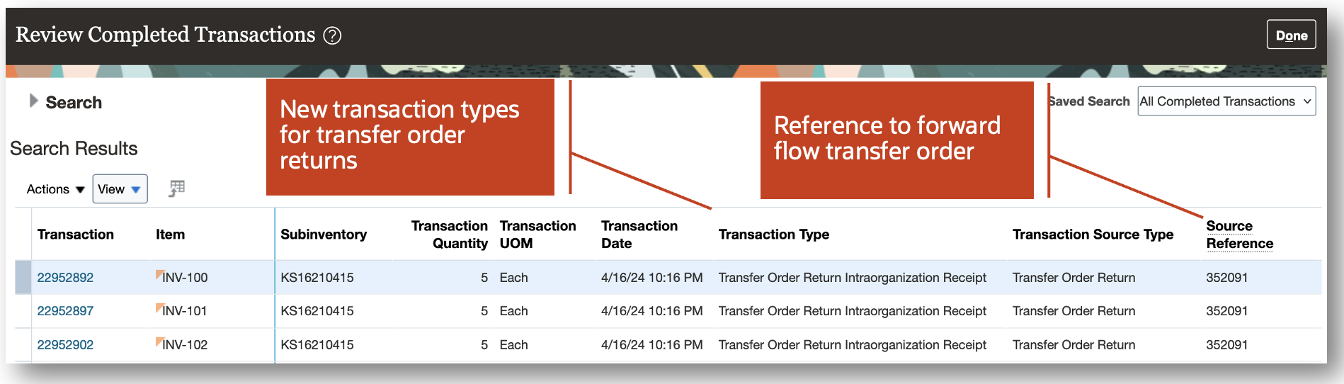

The following new transaction types have been introduced to support returning transfer orders from a subinventory that's not quantity tracked.
- Transfer Order Return Intraorganization Receipt
- Transfer Order Return Intraorganization Shipment
- Transfer Order Return Intraorganization Transfer
Review Completed Transactions
This feature provides you with more accurate cost tracking and more efficient material control by allowing you to create receipt returns for goods that are received into a subinventory that's not quantity tracked.

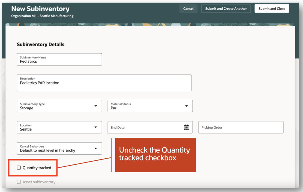

You can configure a subinventory as not quantity tracked by following these steps:
- Navigate to the Setup and Maintenance work area.
- Select the Configure Subinventories task under the Inventory Management functional area.
- To edit the Quantity Tracked checkbox, you must select a material status of Active: Not available for Netting, ATP, and reservations.
