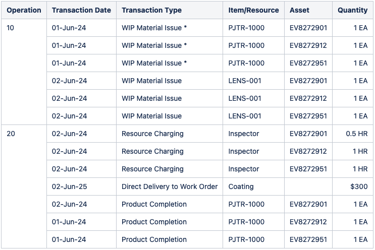

Example: Transactions created for a work order
* The WIP Material Issue transactions of the assets happen automatically after you release the work order.
| Item/Resource | Cost (USD) |
| PJTR-1000 | 1000 |
| LENS-001 | 250 |
| Inspector | 100 |

Total cost of inputs = $4300
Product completion cost = $1433.33 (4300/3)
