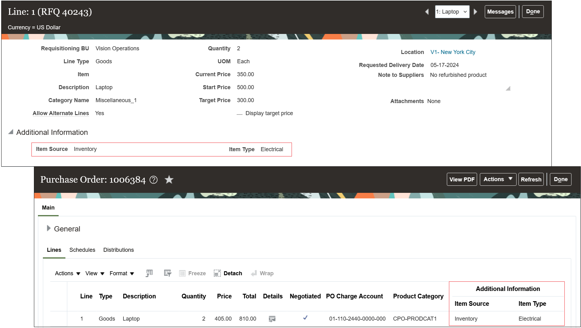

You can now pass descriptive flexfield (DFF) values from the negotiation to the purchasing documents during award. The DFF values on the negotiation header are passed to the purchasing document header and from the negotiation line to the purchasing document line.
Values for the following DFF can be passed from the negotiation to the outcome purchase order, or purchase agreement.
  • Name: Supplier Negotiation Headers
    • Description: Fields for capturing additional information on the supplier negotiation header. These are internal DFF values that aren't visible to suppliers.
  • Name: Supplier Negotiation Headers for Suppliers
    • Fields for capturing additional information on the supplier negotiation header that are displayed to both internal and external parties.
  • Name: Supplier Negotiation Lines
    • Description: Fields for capturing additional information on the supplier negotiation line.
Copy Negotiation Header DFF to Purchase Order Header
Copy Negotiation Line DFF to Purchase Order Line
Descriptive Flexfields are used to track additional information important and unique to the business that would otherwise not be captured. Automatic transfer of DFF values can eliminate manual work to bridge the gap between negotiations and purchase documents.

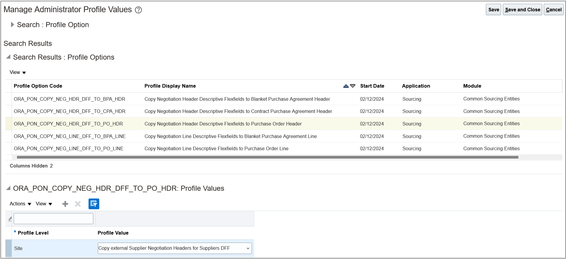

Steps to Enable
In the Setup and Maintenance work area go to the Manage Administrator Profile Values task, you must enable these profile options to copy the DFF values:
Profile Option Code: ORA_PON_COPY_NEG_HDR_DFF_TO_PO_HDR
Name: Copy Negotiation Header Descriptive Flexfields to Purchase Order Header
Description: Enable descriptive flexfields to be copied from an awarded negotiation header to the outcome purchase order header.
Values:
  • No
  • Copy internal Supplier Negotiation Headers DFF
  • Copy external Supplier Negotiation Headers for Suppliers DFF
Profile Option Code: ORA_PON_COPY_NEG_LINE_DFF_TO_PO_LINE
Name: Copy Negotiation Line Descriptive Flexfields to Purchase Order Line
Description: Enable descriptive flexfields to be copied from an awarded negotiation line to the corresponding purchase order line.
Values:
  • Yes
  • No
Profile Option Code: ORA_PON_COPY_NEG_HDR_DFF_TO_BPA_HDR
Name: Copy Negotiation Header Descriptive Flexfields to Blanket Purchase Agreement Header
Description: Enable descriptive flexfields to be copied from an awarded negotiation header to the outcome blanket purchase agreement header.
Values:
  • No
Profile Option Code: ORA_PON_COPY_NEG_LINE_DFF_TO_BPA_LINE
Name: Copy Negotiation Line Descriptive Flexfields to Blanket Purchase Agreement Line
Description: Enable descriptive flexfields to be copied from an awarded negotiation line to the corresponding blanket purchase agreement line.
Values:
  • Yes
  • No
Profile Option Code: ORA_PON_COPY_NEG_HDR_DFF_TO_CPA_HDR
Name: Copy Negotiation Header Descriptive Flexfields to Contract Purchase Agreement Header
Description: Enable descriptive flexfields to be copied from an awarded negotiation header to the outcome contract purchase agreement header.
Values:
  • No
Setup - Profile Options
