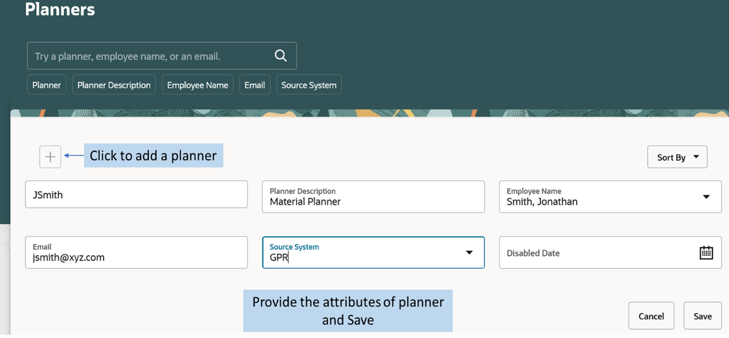

You can add, update, or delete a planner using the new Redwood Planners page.
Add a Planner

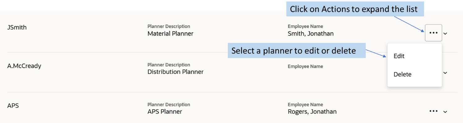

Use the new Redwood Planners page to edit or delete a planner. Select a planner and then click the Actions icon to edit or delete a planner.
Edit or Delete a Planner

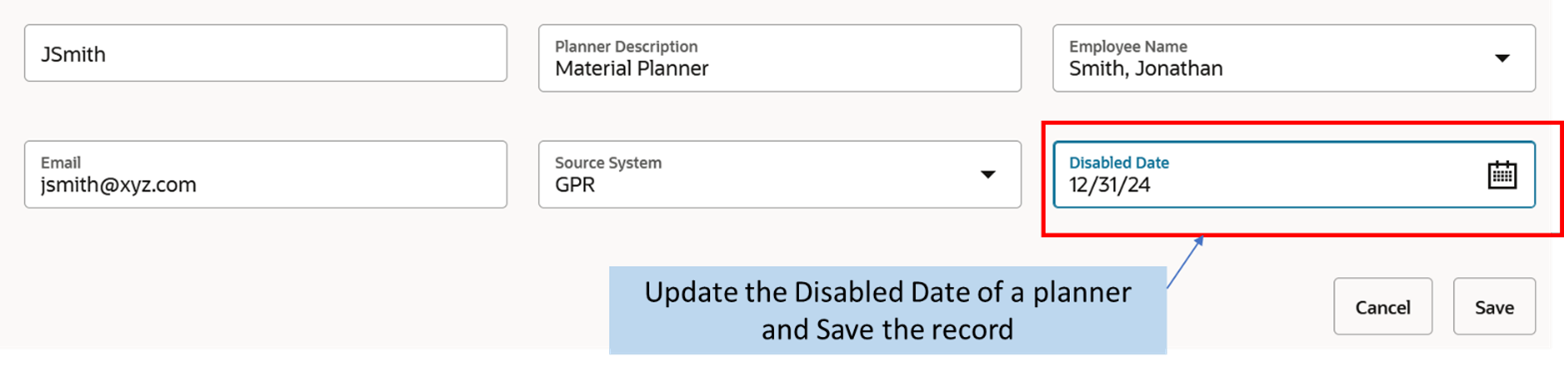

You can edit the attributes of a planner such as Source System and Disabled Date. Each planner is defined in the context of a specific source system.
Edit a Planner

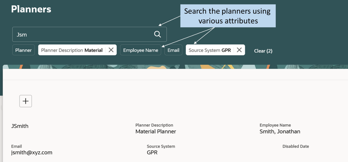

You can search and filter planners using a planner attribute value or simply start typing the attribute value. A minimum of three characters is required for the page to start showing matching results. The search is case insensitive.
Search for Planners

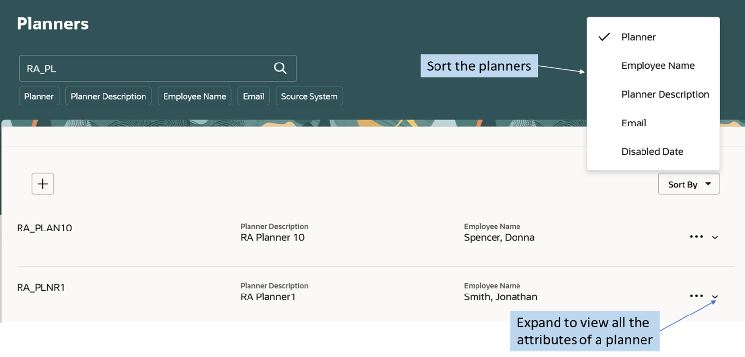

You can also sort planners based on any attribute. The sort type is ascending.
Sort Planners

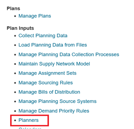

The Redwood Planners page is available in the following work areas:
- Supply Planning
- Demand & Supply Planning
- Backlog Management
- Demand Management
- Planning Central
- Replenishment Planning
- Sales & Operations Planning

After you set the profile option value to Yes, sign-in again. The Redwood Planners page is displayed in the Task panel.
Redwood Planner Page
Click the Planners option to open the Redwood page in a new browser window.
