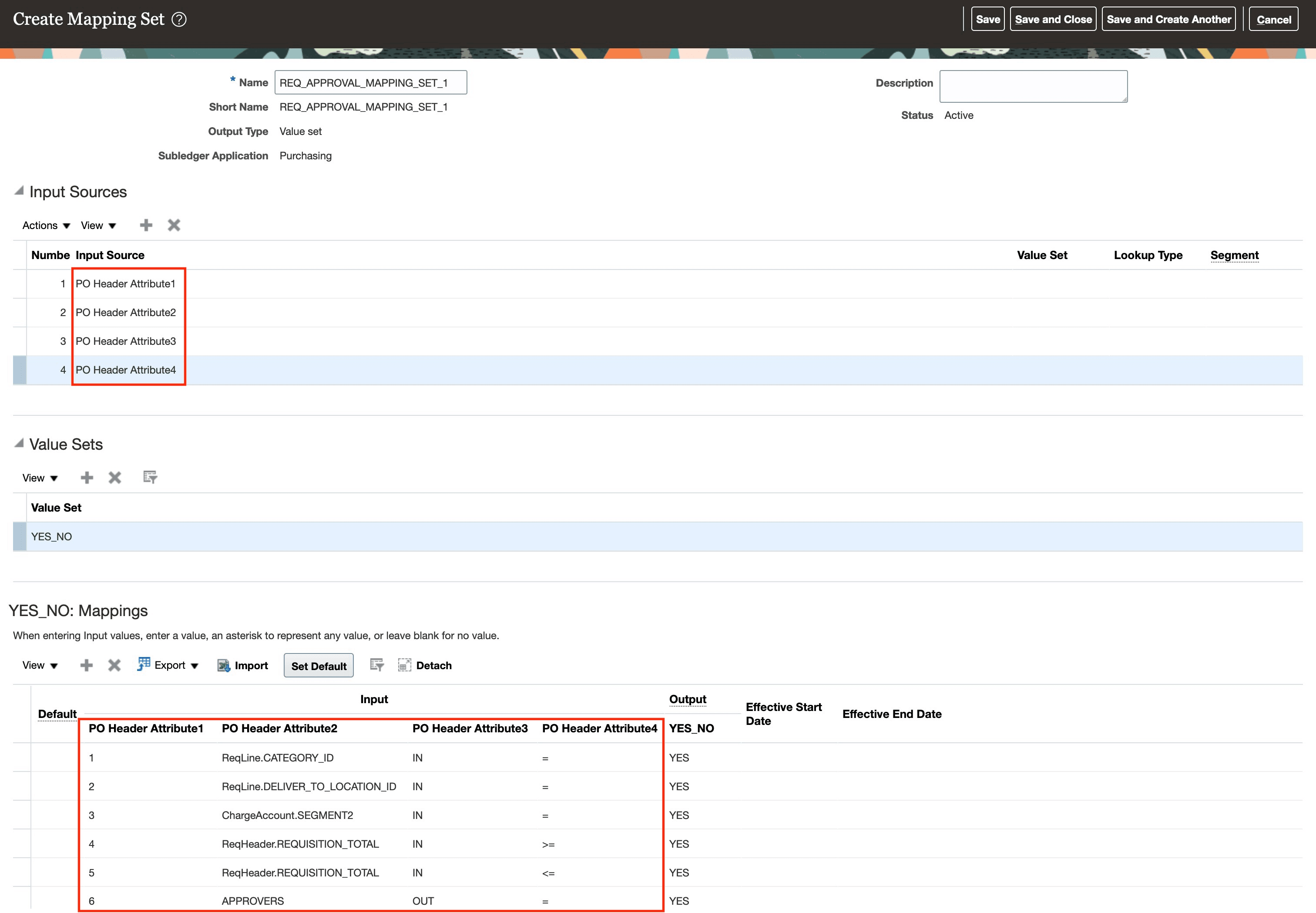

REQ_APPROVAL_MAPPING_SET_1
To define this mapping set, select 4 input sources from the list of available input sources. The input sources represent these columns:
  • PO Header Attribute1: Indicates the sequence in which the attributes specified in this mapping will be mapped with the corresponding data values are specified in the REQ_APPROVAL_DATA_SET_X mapping set.

Here's the screen capture that illustrates how you can create a requisition approval mapping set:
REQ_APPROVAL_MAPPING_SET_1 Mapping Set
REQ_APPROVAL_MAPPING_SET_1 Mapping Set for Named Approvers

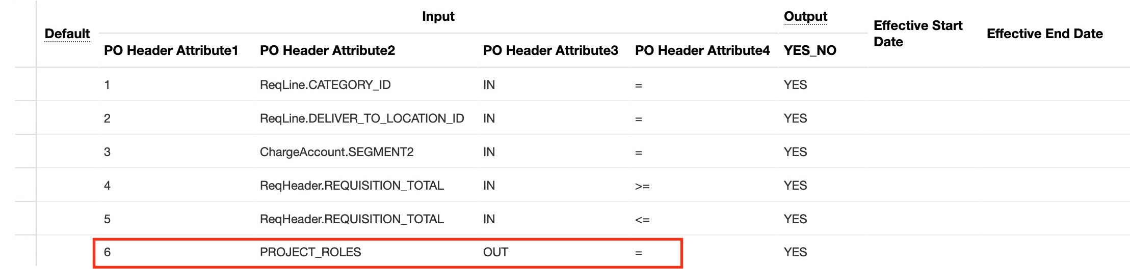

To route requisitions to specific roles of the project associated with the requisition distribution, specify PROJECT_ROLES in the output row in the place of APPROVERS.

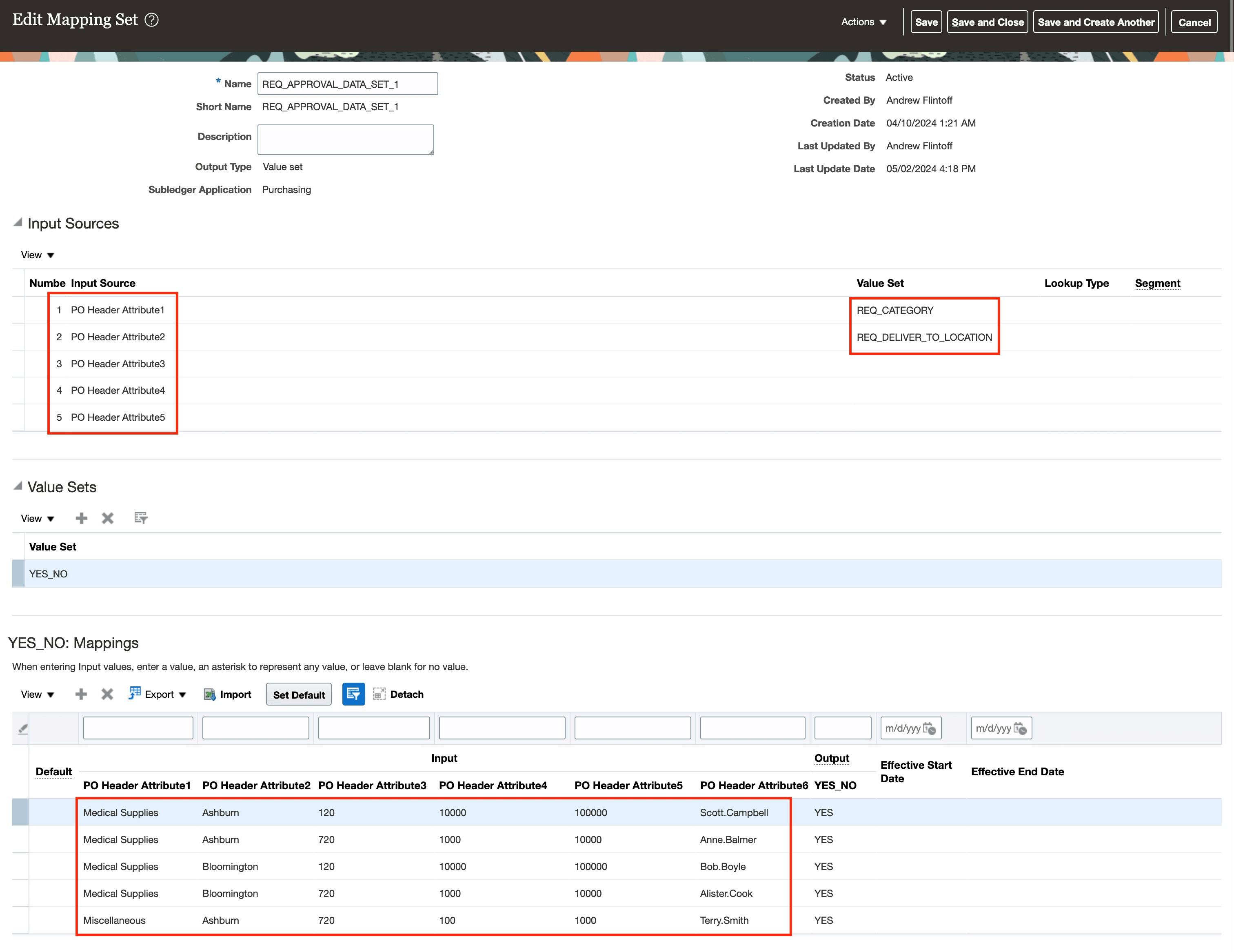

REQ_APPROVAL_DATA_SET_1
To define this mapping set, you must select the same number of input sources as the number of approval attributes you configured in the REQ_APPROVAL_MAPPING_SET_1 mapping set. In this case, you must select 6 input sources because the REQ_APPROVAL_MAPPING_SET_1 has 6 approval attributes. You can enter the attribute values in terms of an Id (unique identifier), alternatively, you can configure value sets to enter data using user-friendly values (business keys).
REQ_APPROVAL_DATA_SET_1 Mapping Set
REQ_APPROVAL_DATA_SET_1 Mapping Set for Named Approvers

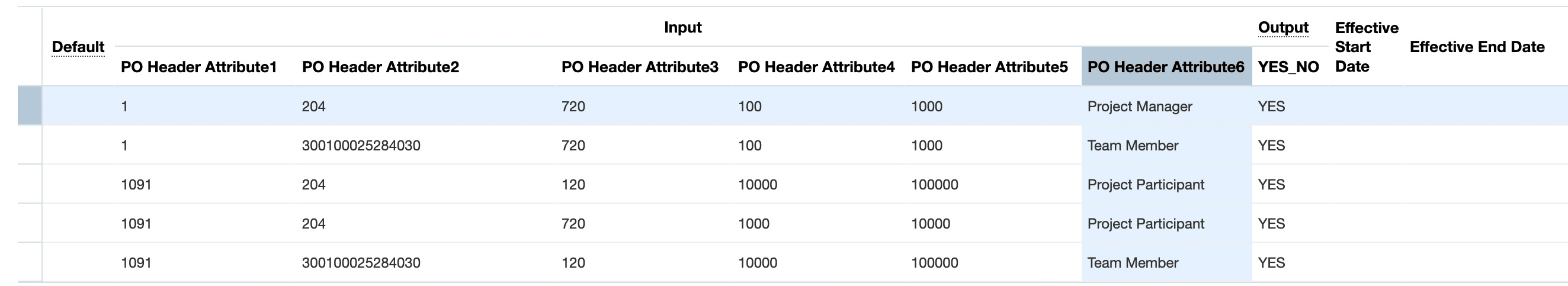

When using PROJECT_ROLES as the output, you must specify the project role name in the REQ_APPROVAL_DATA_SET_1. The requisition is routed to all users assigned to the project role.
REQ_APPROVAL_DATA_SET_1 Mapping Set For Project Roles As Approvers
REQ_APPROVAL_DATA_SET_1 Mapping Set for Project Roles as Approvers

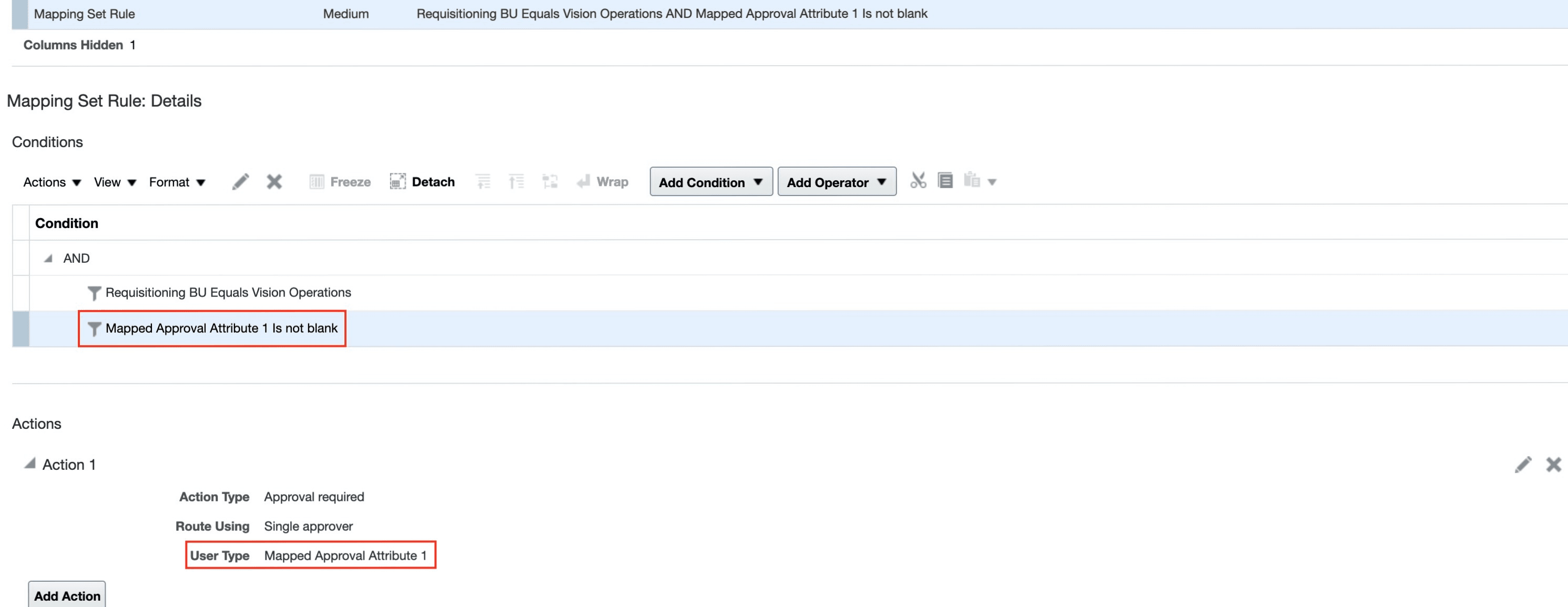

Step 2: Configure the Approval Rule
After creating the mapping sets, configure an approval rule using the Mapped Approval Attribute 1 attribute.
Single approver routing configured using Set up and Maintenance with Mapped Approval Attribute 1
Single Approver Routing Configured Using Set Up and Maintenance with Mapped Approval Attribute 1

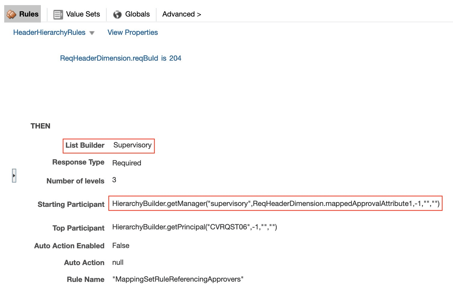

To use Mapped Approval Attribute X in supervisory hierarchy and job-level routing, configure the approval rules using the Oracle BPM Worklist application.
Approval rule using supervisory hierarchy routing configured from BPM Worklist Application
Approval Rule Using Supervisory Hierarchy Routing Configured from the BPM Worklist Application

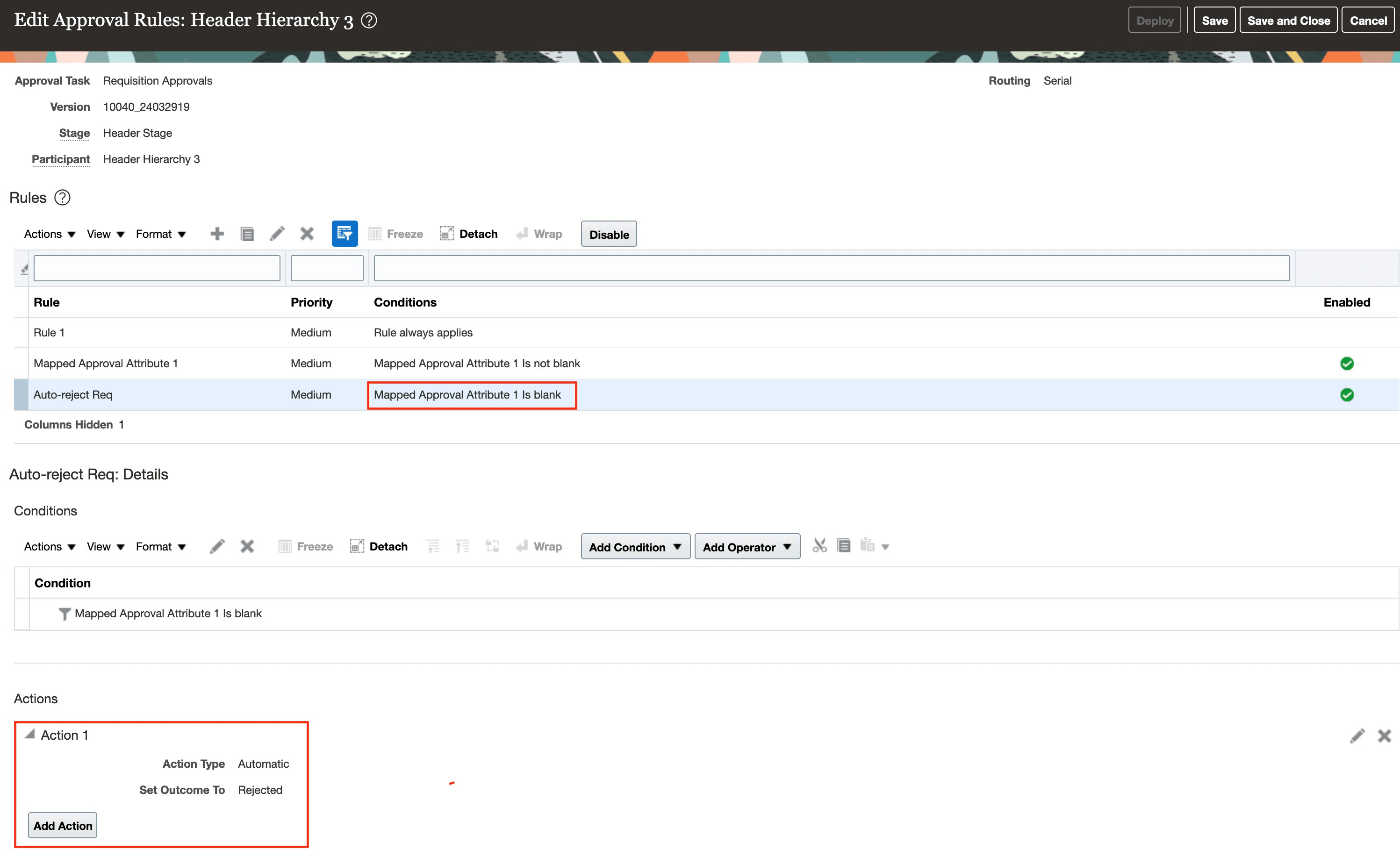

  • You must always configure an approval rule to specify what should happen if Mapped Approval Attribute 1-5  returns a null value. You will get a null value in these cases:
    • Requisition data doesn't match with the values defined in the REQ_APPROVAL_DATA_SET_X mapping set.
    • An error occurred while evaluating the condition from a mapping set due to a data entry error, such as incorrect attribute names or extra spaces after an attribute or operator name.Example approval rule to automatically reject requisition when Mapped Approval Attribute 1 returns a null value
