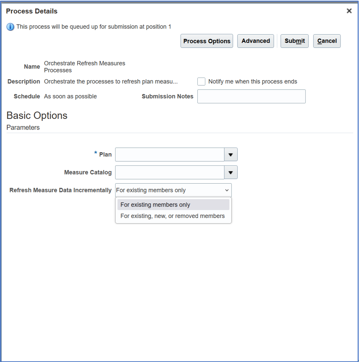

Process Details Dialog Box for Scheduled Process Named Orchestrate Refresh Measures Processes
The new parameter includes two options:
- For existing members only
- For existing, new, or removed members
If you select For existing members only, then new members and measure data for these new members won’t be added to the plan, and removed members and measure data for these removed members won’t be deleted from the plan. This option is the default selection.
If you select For existing, new, or removed members, then the scheduled process will perform a full refresh of the plan’s master data:
- Any new members will be added to the plan.
- Any existing members that previously weren’t within the plan scope but now are because of hierarchy changes will be added to the plan.
- Any existing members that have been deleted will be removed from the plan.
- Any existing members that previously were within the plan scope but now aren’t because of hierarchy changes will be removed from the plan.
