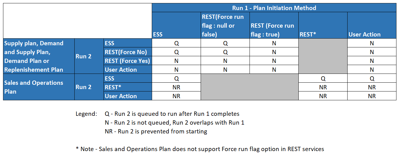

The outcome of initiating a plan run (Run 2) while another run of the same plan (Run 1) is still in progress depends on how each plan run is initiated and the type of plan. Following are the methods of initiating a plan run:
  • Scheduled Process page
  • Plan run REST service with Force Run set to False
  • REST service with Force Run set to True
  • User action from the Manage Plans page or from plan output page
The following table explains the outcomes for each scenario:

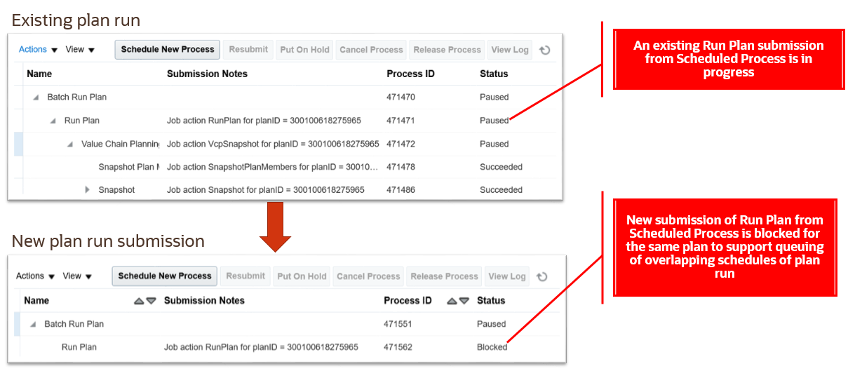

The existing Run Plan process will be in “Paused” state until all its child processes are completed successfully. The next Run Plan state will then change to “Running”, and finally to “Succeeded” when the Run Plan completes.
When a new plan run is submitted, the Run Plan process will in “Blocked” state temporarily. After the previous Run Plan completes successfully, the new Run Plan status switches to “Paused” and starts its child processes.
New Submission of Run Plan Queued for Overlapping Schedule of Plan Run
New Run Plan Submitted Queued for Overlapping Schedule of Plan Run
