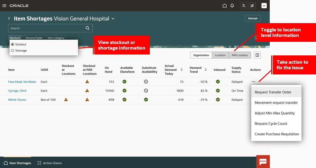

  • Once you open the page, you can see the item stockouts for the selected organization. You can switch the view to see item shortages for the selected organization.
  • The page shows a list of items with stockout or shortage issues.
NOTE: Use the Configure Item Shortage Parameters setup task to set up the default item category and list of item categories for which you want to monitor the stockout and shortage issues. This step is required, and you can't view the items on this page if they aren't assigned to an item category set up in the Configure Item Shortage Parameters setup task.
  • The page shows whether the shortage or stockout is at a subinventory or a subinventory that's PAR enabled.
    • You can switch to the Location toggle to view shortage or stockout information at a subinventory level.
    • You can switch to the PAR Location toggle to view shortage or stockout information at a PAR-enabled subinventory and locator level.
NOTE: To show shortage or stockout at the subinventory or locator level, you must set up the subinventory or locator and item association using the Configure Subinventories setup task.
  • The page also shows other information, such as an item's on-hand availability, demand, and supply status, which gives key insights into the root cause of the issue and available options.
  • You can take the following actions from this page to remedy your stockout or shortage issues.
    • Create transfer order
    • Create movement request transfer
    • Adjust min-max quantity
    • Adjust PAR level
    • Request cycle count
    • Create purchase requisition

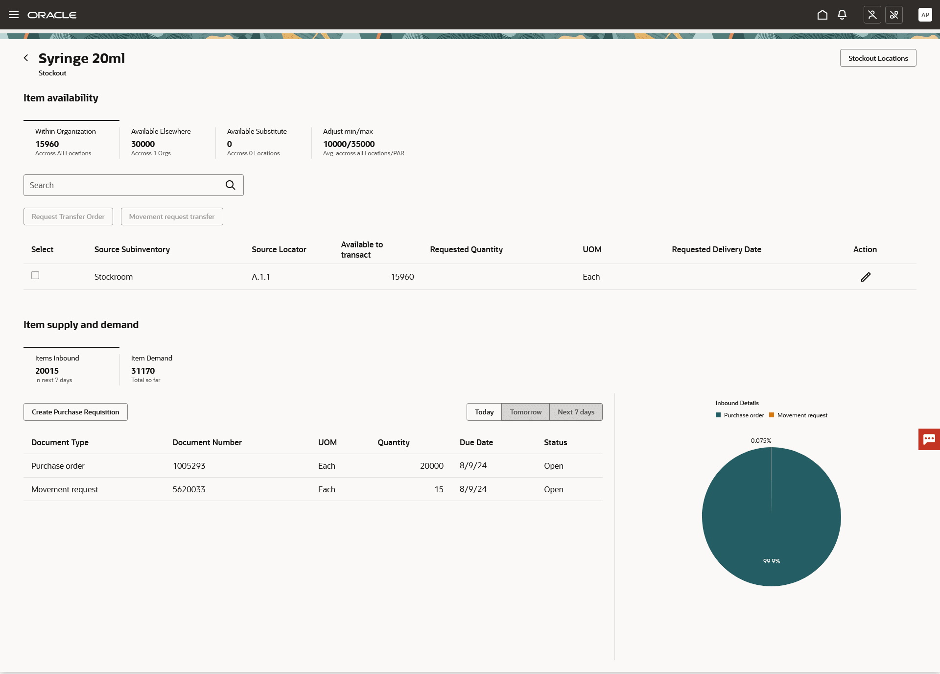

Clicking an item on the summary page takes you to a detail page with more insights about the item.
Item Shortage Detail Page
Stockout and Shortage Locations: You can view the list of all stockout and shortage locations for the item.
Item Availability Within Organization: This section shows the subinventory and locator where the item is available to transact within the organization. You can create transfer orders or movement requests to transfer quantities to your stockout or shortage location.
Item Availability Elsewhere: This section shows the other organizations where the item is available to transact. You can create transfer orders to transfer quantities to your stockout or shortage location.
Substitute Item Availability: This section shows the subinventory and locator where the substitute item is available to transact within the organization. You can create transfer orders or movement requests to transfer quantities to your stockout or shortage location.
Min-Max Quantity: This section shows the subinventory and locator for which the item is associated. You can adjust the minimum and maximum quantities, adjust the PAR level, and request a cycle count.
Supply: This section shows all the open supplies for the item with a due date that's the same or before a cutoff date. You can select today, tomorrow, or seven days from today as the cutoff date. You can create purchase requisitions to replenish your stockout or shortage location.
Demand: The section shows all the open demand for the item with the requested date that's the same or before a cutoff date. You can select today, tomorrow, or seven days from today as the cutoff date.

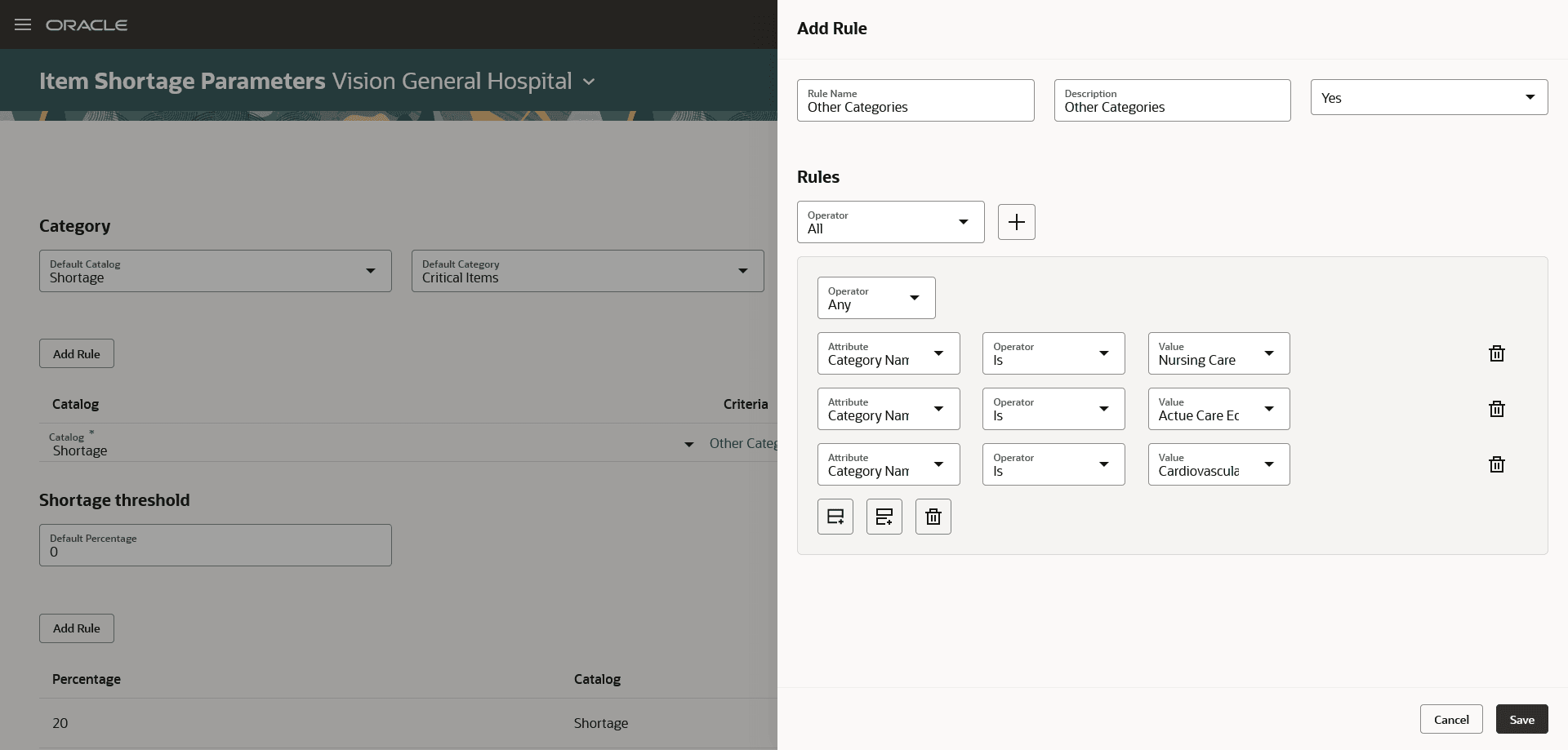

Use the Item Shortage Parameters page to set up defaults and rules used by the Item Shortages page. You can access the Item Shortage Parameters page by selecting the Configure Item Shortage Parameters task from the Setup and Maintenance work area.
Category: Use this section to set the default item category for the Item Shortages page. You can also add a rule to include more item categories for which you want to monitor item stockouts and shortages. The categories added to the rule will appear as options in the Item Category filter chip on the Item Shortage pages.
To add a rule:
  1. Click the Add Rule button.
  2. Select a Catalog.
  3. Click Criteria.
  4. Enter the Rule Name and Description.
  5. Enter the category names in the rule. Currently, only the Is operator is supported.
Add Rule
Add Rule
Shortage Threshold: Use this section to set the default percentage for the shortage threshold. When an item's available quantity falls below this percentage of the minimum quantity or PAR level, it will be listed as a shortage. You can all add a rule to define percentages per item category or set of item categories. For example, you may want to list any item as a shortage when the available quantity goes 50 percent below the minimum quantity, but for a specific category, you may want to list an item as a shortage when it falls below 20 percent.
Average Demand Period: Use this section to set the period for calculating average demand. The available options are Last 7 days, Last 30 days and Last 90 days.
Open Supply Periods and Open Demand Periods: Use this section to set the default period for reviewing the open supply and demand  on the Item Shortages Detail page. The available options are Today, Tomorrow, and the Next 7 days.
