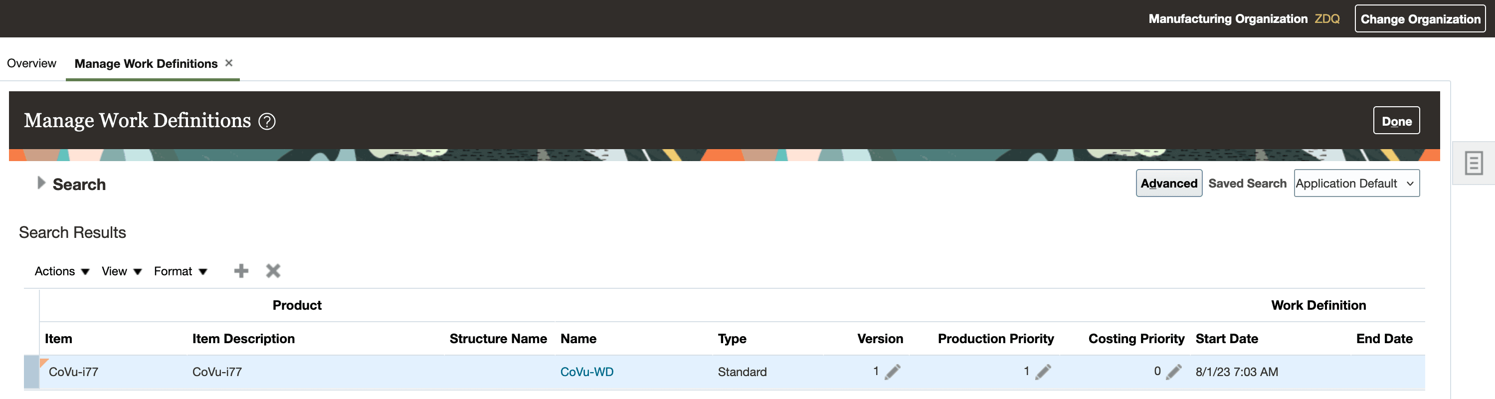

Manufacturing Work Definition in ZDQ Organization

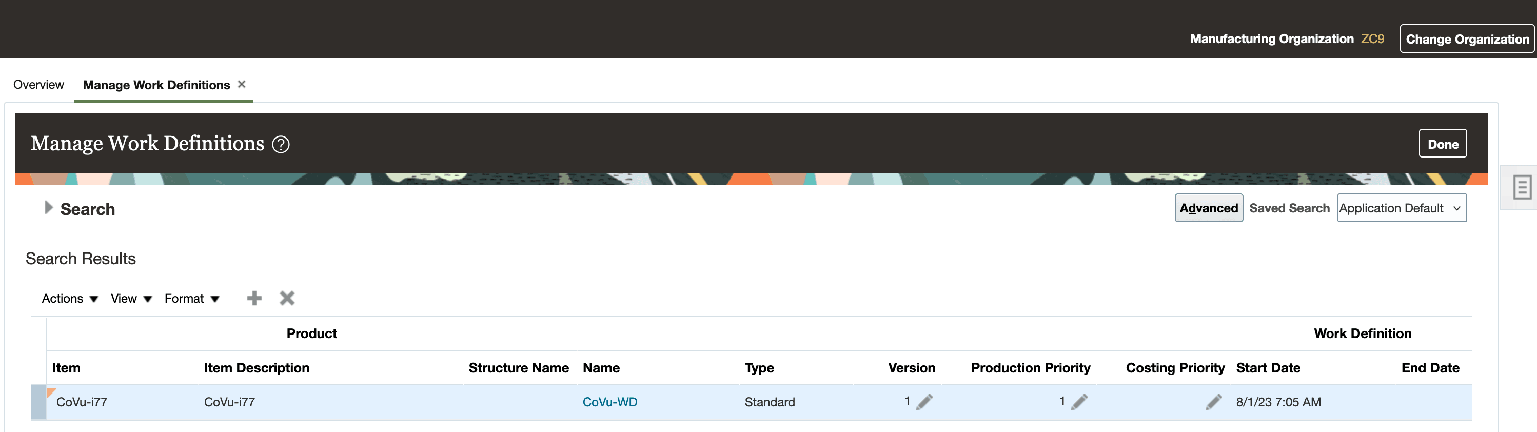

Manufacturing Work Definition in ZC9 Organization
In this setup, manufacturing work definition in ZDQ organization is set up with costing priority = 0. Also, both ZDQ and ZC9 belong to the same cost organization and the cost is maintained at the cost organization level.

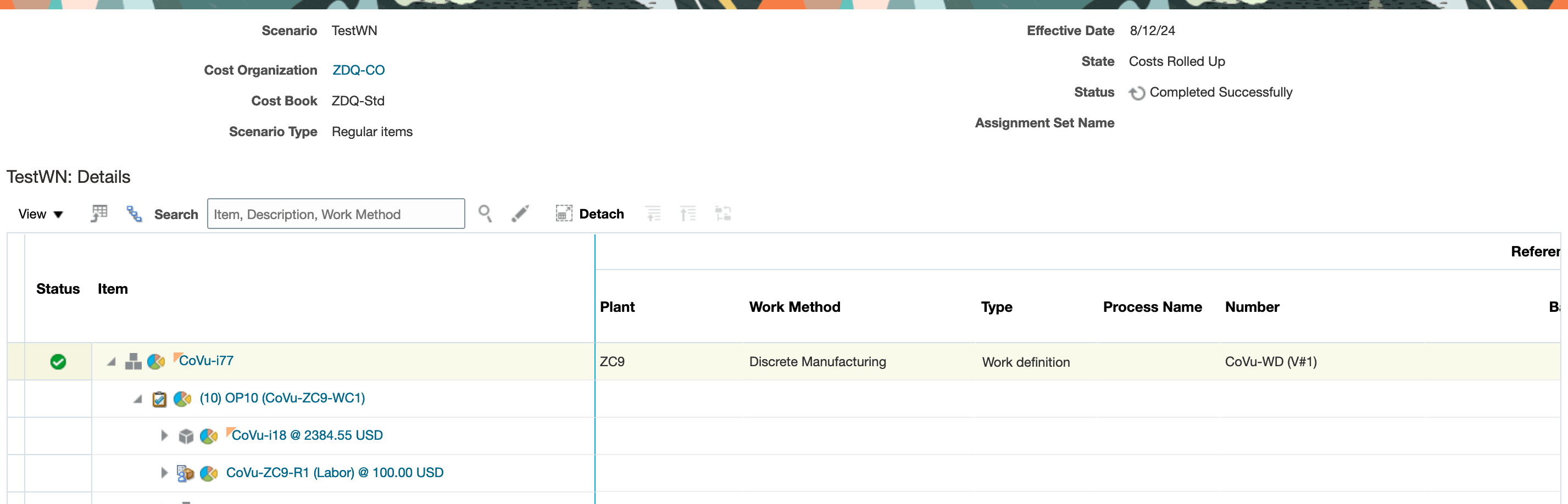

With this setup, when you run the Roll up Costs process, the cost of the product would be calculated using the work definition where costing priority is non-zero, that's using the work definition in ZC9 organization.
Product Cost with Work Definition from ZC9 organization
