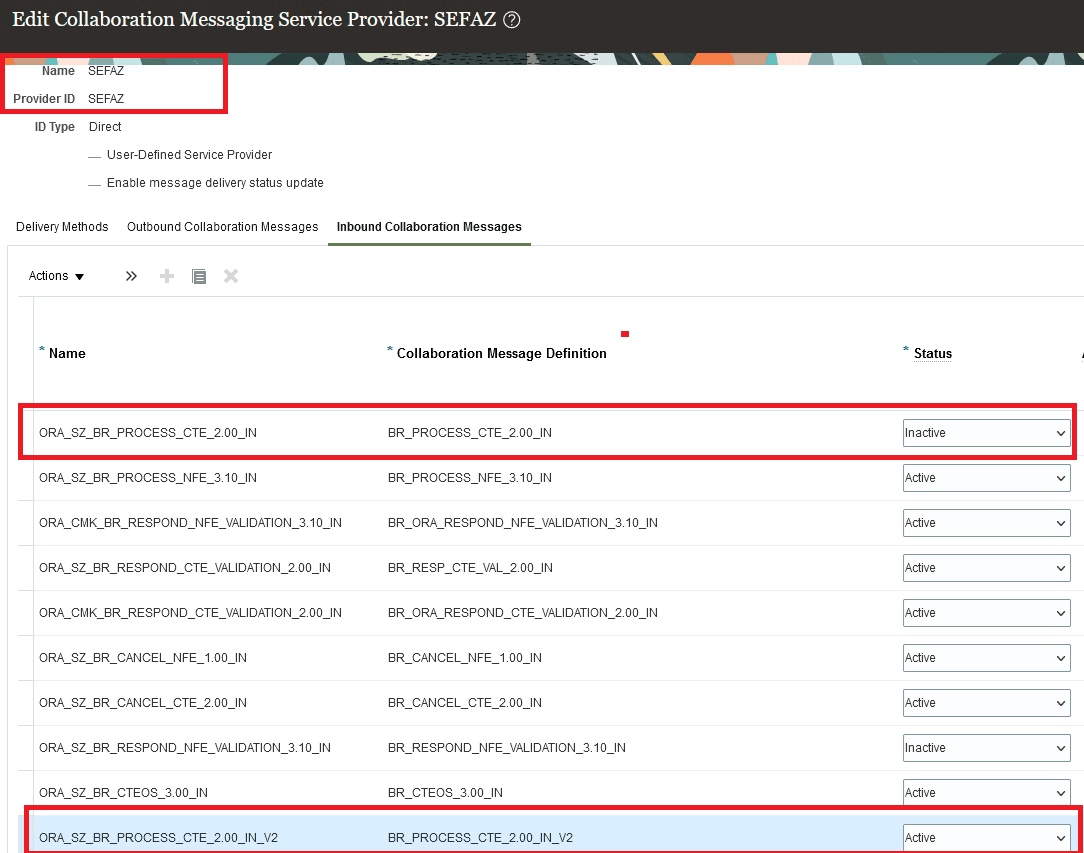

Steps to Enable
- Select Manage Collaboration Messaging Service Providers from the Tasks panel.
 - Search for and select the SEFAZ service provider.
 - Select the Inbound Collaboration Messages tab.
 - Set the status of the BR_PROCESS_CTE_2.00_IN message definition to Inactive.
 - Set the status of the BR_PROCESS_CTE_2.00_IN_V2 message definition to Active.
 - Select Save and Close.
SEFAZ Service Provider and Inbound Collaboration Messages

New users will have the new version of this message available for the SEFAZ service provider, while existing users will need to activate the new message definition.
