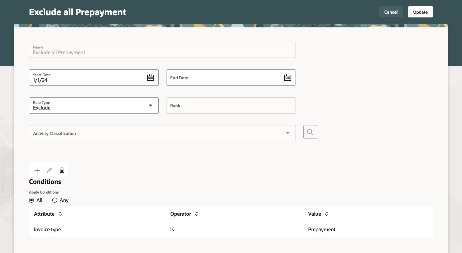

Exclusion Rules
Create these rules to identify any invoice distributions that must be excluded from processing into activities. For each exclusion rule, identify the rule conditions that are applicable.
Exclusion Rule
Exclusion Rule

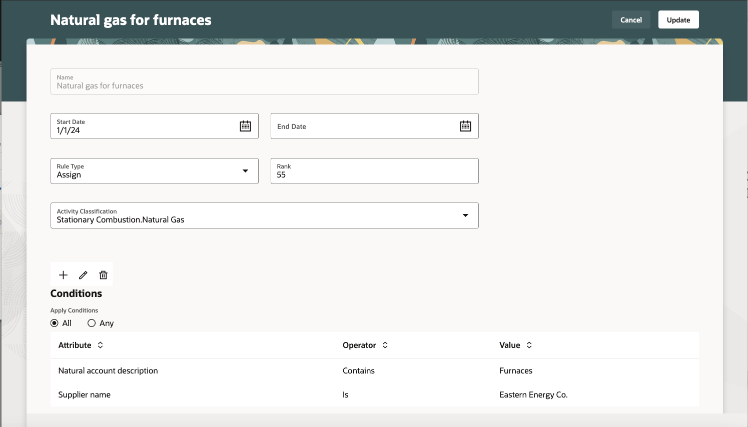

Assignment Rules
Create these rules to identify invoice distributions that must be included for processing into activities. Assignment rules tell the system which activity type and activity type attribute values must be used when creating activities for invoice distributions that satisfy the rule criteria. For each invoice classification rule, identify the rule conditions and the activity classification.
Assignment Rule
Assignment Rule
