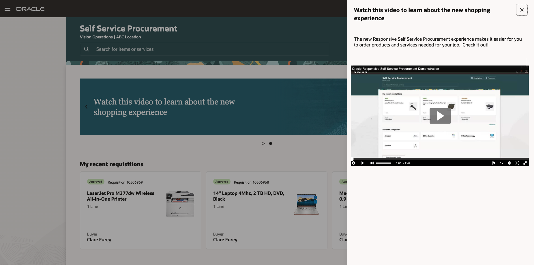

Let’s take a closer look at the use-case scenario of an employee creating a requisition. For example, you could create a guided journey that embeds a training video for the employee to review before submitting a request. The text is yours to enter, tailored to the needs of your particular use case and company. In the following example, you have a video to watch in the panel that opens. You could also link to an external website or add a checklist for additional guidance.
Guided Journey Example of Administrator-Created Video

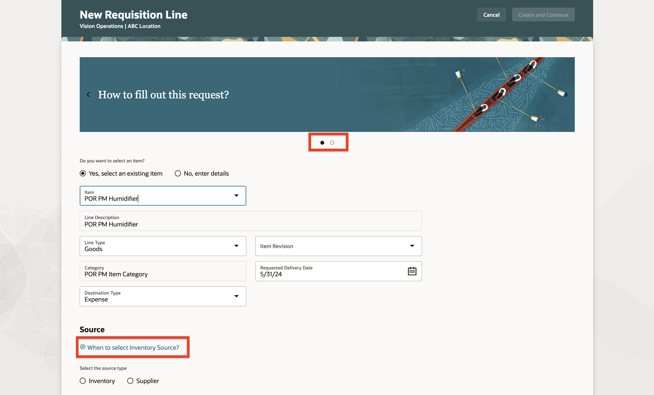

In the following example, you can see guided journey tasks at the page and section level. The page-level guided journey tasks are displayed as a train stop below the "How to fill out this request" guided journey header, with two dots that correspond to two tasks in the journey. The section-level guided journey tasks are below the Source section header.
Guided Journey Task Examples at the Page and Section Levels

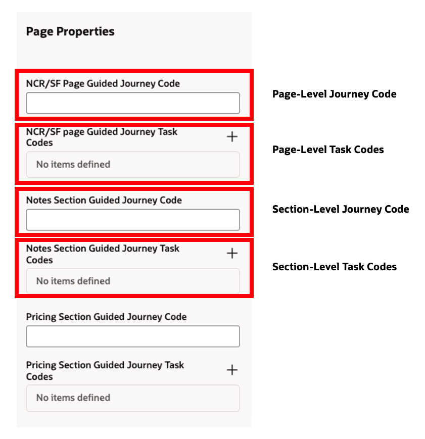

- Navigate to the Page Properties section (formerly the Constants tab). Wait for the page to load completely before proceeding to the next step.
- Locate the journey code property you want to modify, and enter the page- or section-level code from the guided journey into the property field in VB Studio.
  Property Name in VB Studio Field Name in Guided Journey Description Page Guided Journey Code (journey) Code Enter a journey code in the page level field to display guided journeys at the page level. Page Guided Journey Task Codes (task) Code Enter a task code in this page level field to display tasks at the page level. Separate multiple task codes with a comma. Section Guided Journey Code (journey) Code Enter a journey code in this section level field to display guided journeys at the section level. Section Guided Journey Task Codes (task) Code Enter a task code in this section level field to display tasks at the section level. Separate multiple task codes with a comma.
Journey Code Fields in VB Studio
