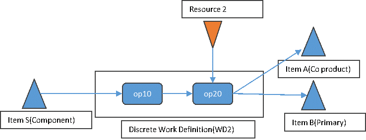

For example, consider a bidirectional discrete work definition. In one discrete work definition WD1, item B is generated as a co-product output while producing the primary item A. Operations op10 and op20 are associated with the discrete work definition WD1. Operation op20 produces both the primary and secondary output items. Resource 1 is utilized at op20. Primary item A consumes the component item R in its Item Structure with usage quantity as 2. Consider the defined output quantity as 0.4 for the co-product item B.
In another discrete work definition WD2, item A is generated as a co-product output while producing the primary item B. Operations op10 and op20 are associated with the discrete work definition WD2, and operation op20 produces both the primary and secondary output items. Resource 2 is utilized at op20. Primary item B consumes the component item S in its Item Structure with usage quantity as 2. Consider the defined output quantity as 0.6 for the co-product item A.
Bidirectional Supply Chain Network: Item B is Co-Product and Item A is Primary Supply
Bidirectional Supply Chain Network: Item A is Co-Product and Item B is Primary Supply
