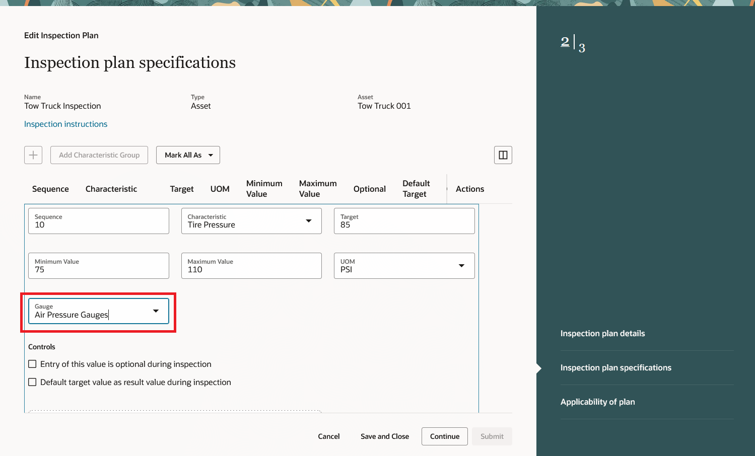

With this feature, while defining an inspection plan, you can now specify the type of gauge equipment to be used for collecting the inspection result values.
Specify Gauge Type for Collecting Results while Defining Inspection Plan

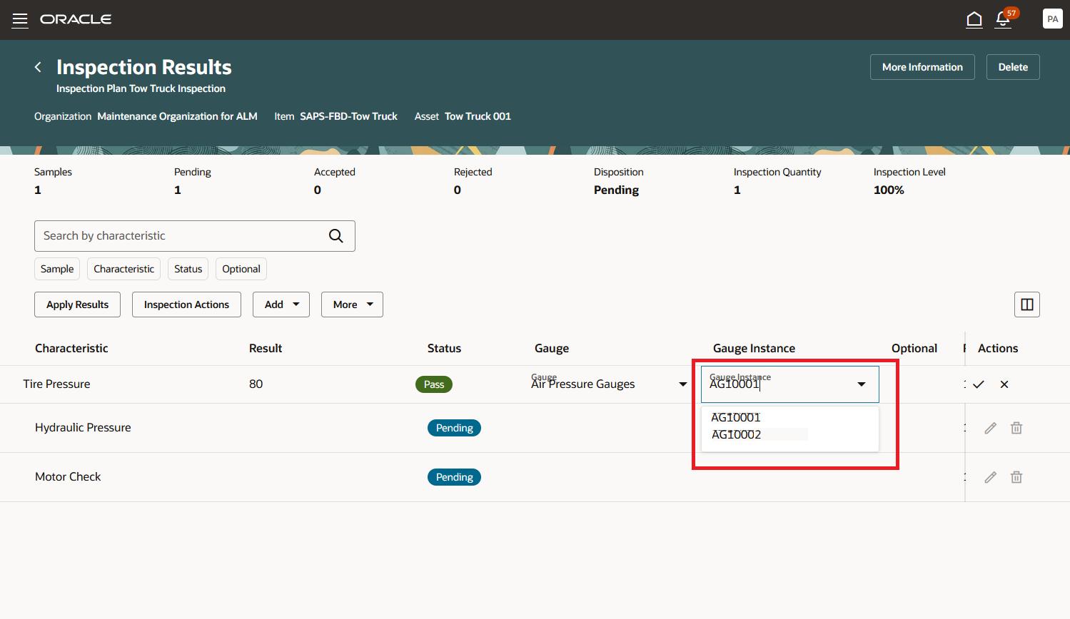

During inspection, the gauge type is defaulted in from the inspection plan but can be changed, and then from the list of gauges, you can specify the exact gauge that you’ve used.
Specify Gauge Instance Used to Gather Inspection Result Value
