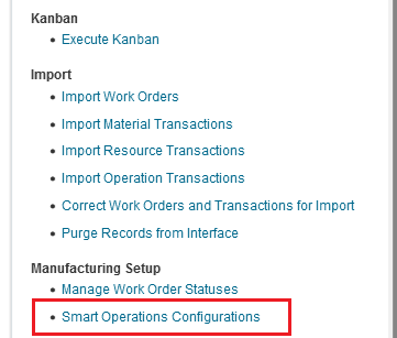

Smart Operations COnfigurations Task
Smart Operations Configurations Task

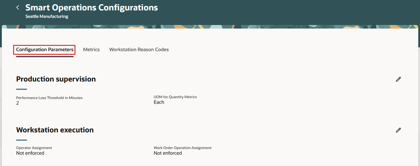

Configuration Parameters:
Performance Loss Threshold in Minutes specifies the threshold duration in minutes below which all workstation stops without a reason code are counted as minor stops, and therefore a performance loss. A stop duration greater than this threshold value automatically counts as an availability loss if a reason code is not specified.
The parameter UOM for Quantity Metrics specifies the common unit of measure (UOM) to use when work order products have different UOMs.
The parameter Operator Assignment controls operator check-ins at workstations:
  • Not enforced: Any operator can check in to any workstation.
  • Enforced: Only operators assigned to a workstation by the production supervisor can check in to the workstation.
The parameter Work Order Operation Assignment controls work order operation assignments at workstations:
  • Not enforced: Operators can scan any eligible work order operation.
  • Enforced: Operators can execute only those work order operations that are assigned to the workstation by the production supervisor.
  • Enforced with sequence: Operators can execute only work order operations assigned to the workstation in the sequence specified by the production supervisor.

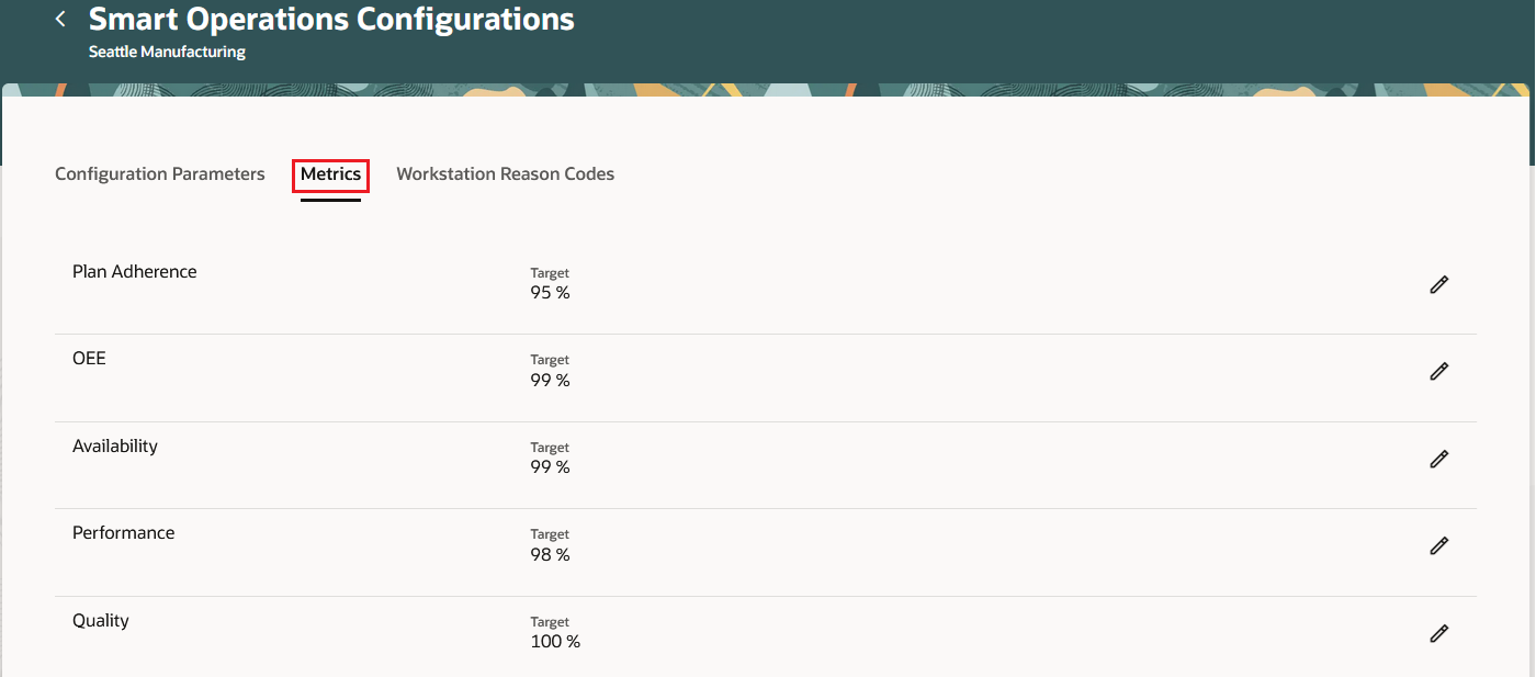

Metrics:
The Metrics setup establishes benchmark targets for metrics, such as Plan Adherence, OEE, Availability, Performance, and Quality in the manufacturing plant. The default value is 100%.
Metrics
Metrics

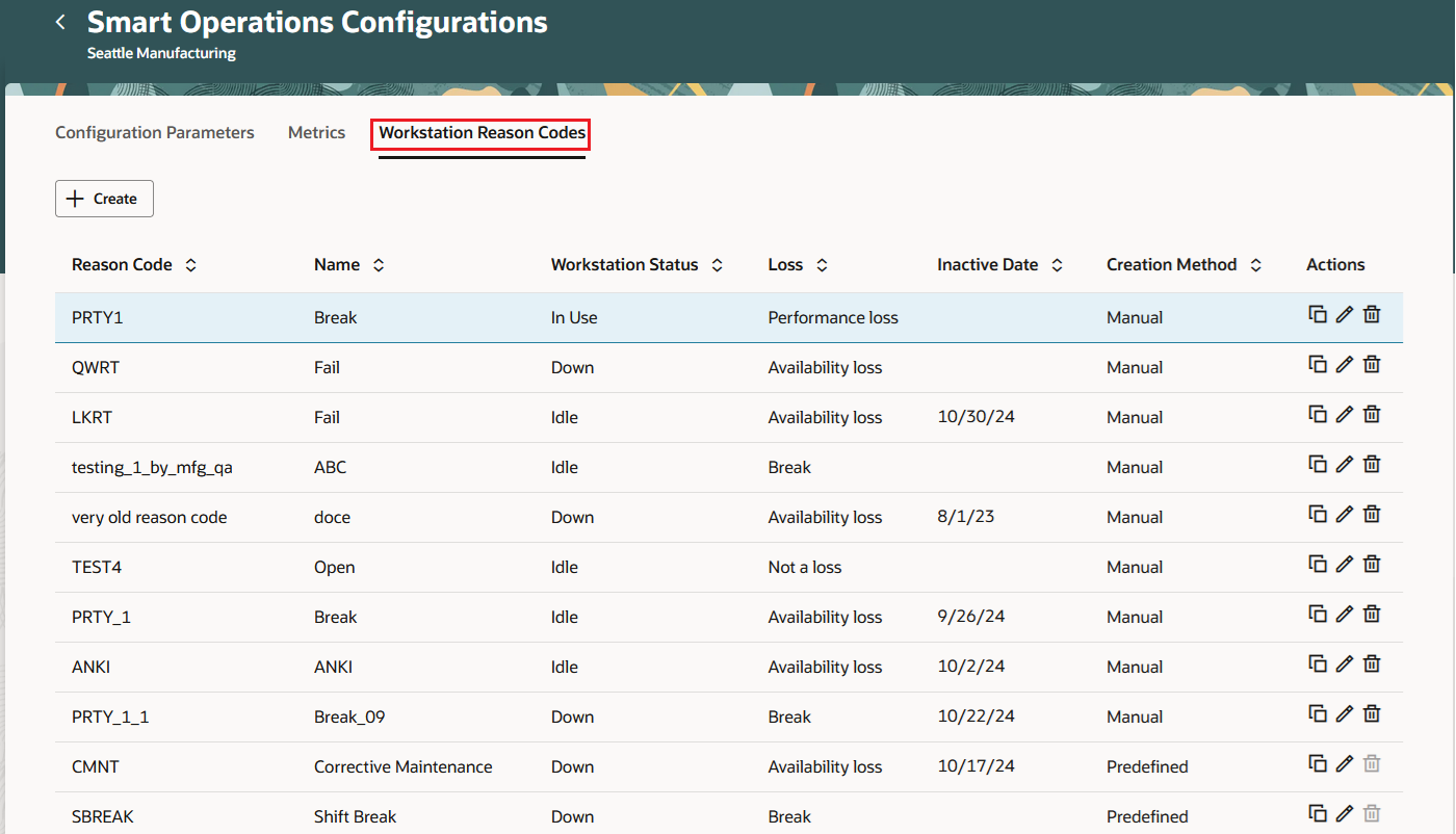

Workstation Reason Codes:
Workstation reason codes help record activities that result in workstation status changes. Each reason code is associated with a workstation status and potential loss, such as availability loss or performance loss. For example, a workstation may be down for preventive maintenance activity leading to an availability loss.
When an operator selects a workstation reason code, the workstation status is accordingly set. The stop duration is accounted correctly in OEE calculations, as Availability Loss, Performance Loss, Not a Loss, or Break.
The ability to capture reason codes at a granular level also helps in detailed analyses of where the losses are occurring. Customers can gain insights into focus areas for improving OEE.
