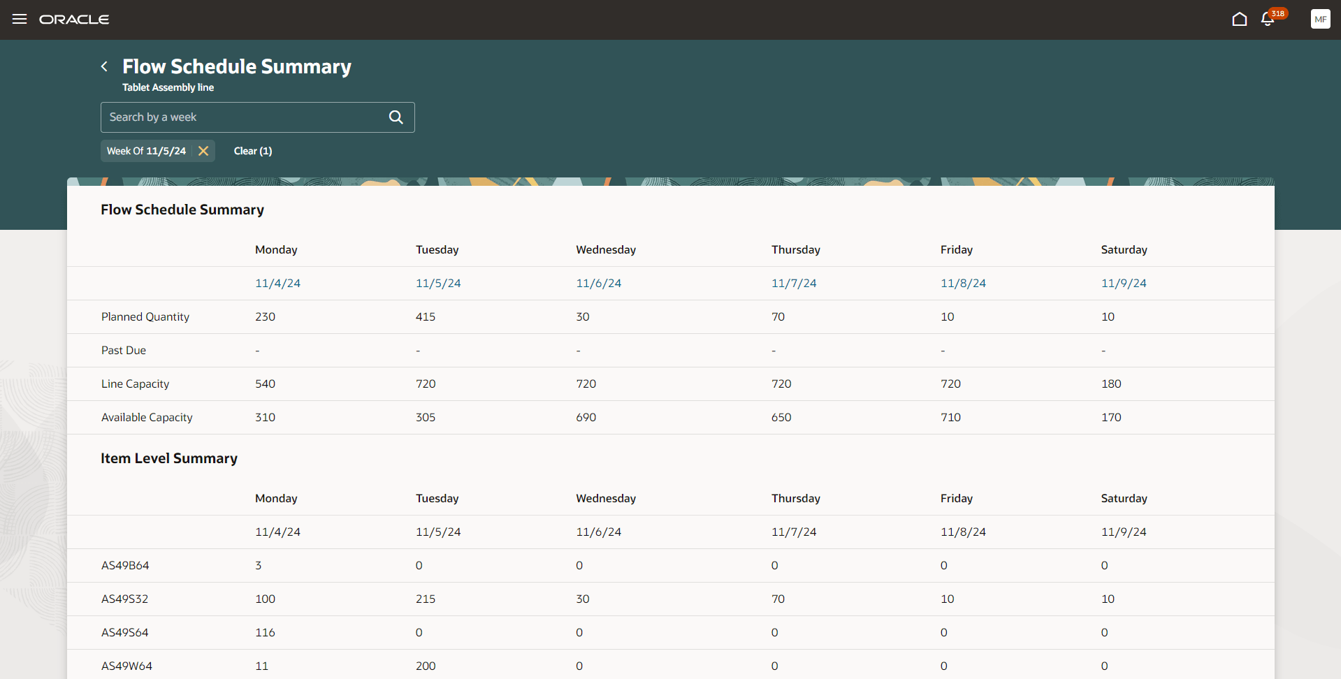

- View a summary of flow schedules for a production line - Compare planned quantities by item against daily line capacity to identify any overload situation that needs to be resolved.

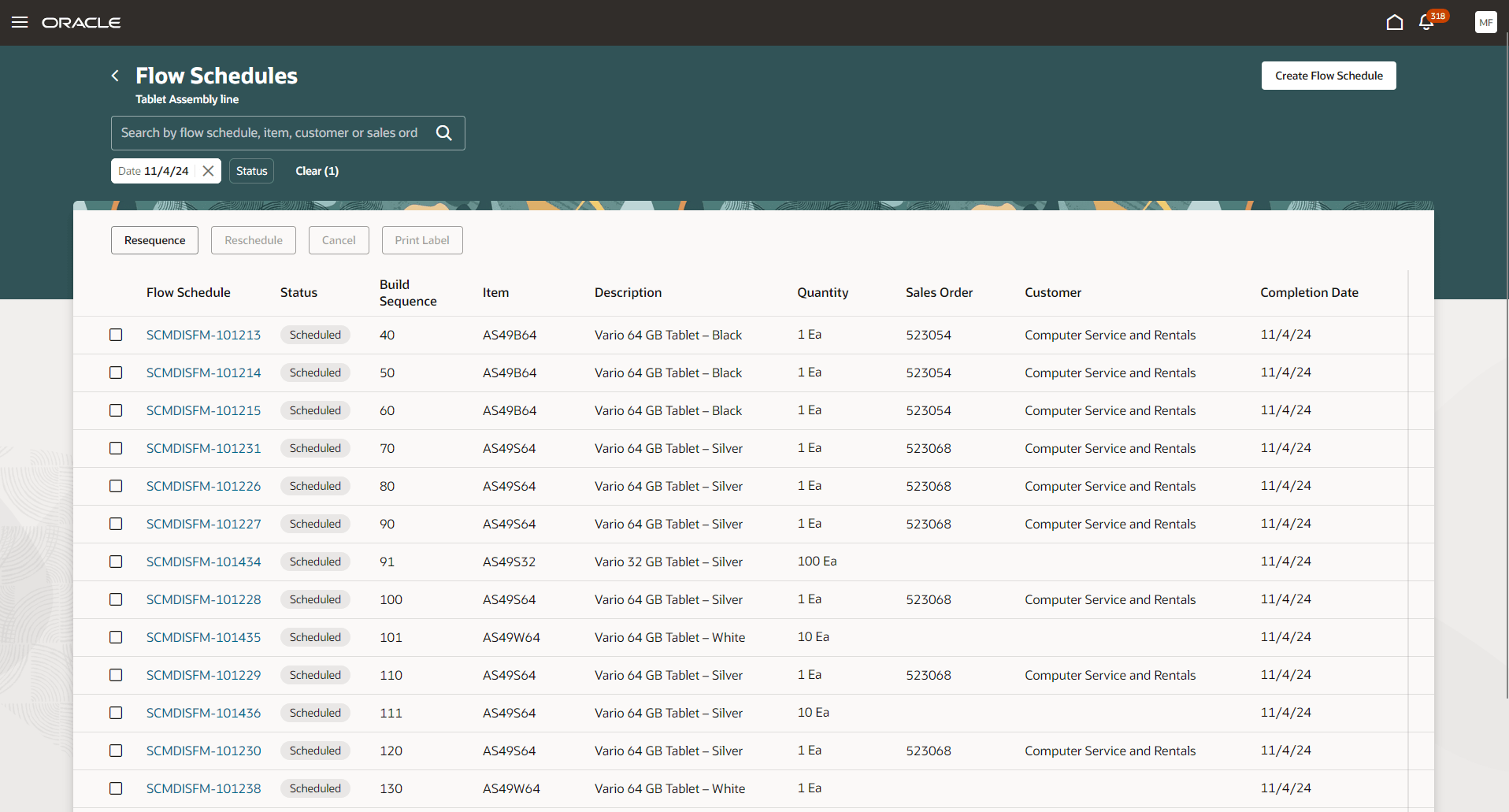

- Manage flow schedules sequenced on a specific day - View, update, or cancel a flow schedule. You can manually create a flow schedule to produce a product. For a flow schedule that's automatically generated as part of a back-to-back order fulfillment flow, you can view the flow schedule details, including the sales order information and requested date. You can also resequence flow schedules to change the order of execution on any particular day to cater to situations such as fulfilling a rush order. You can also reschedule one or more flow schedules to a different date to manage production bottlenecks.
Flow Schedule Summary - Weekly View
Flow Schedule Summary - Day view
