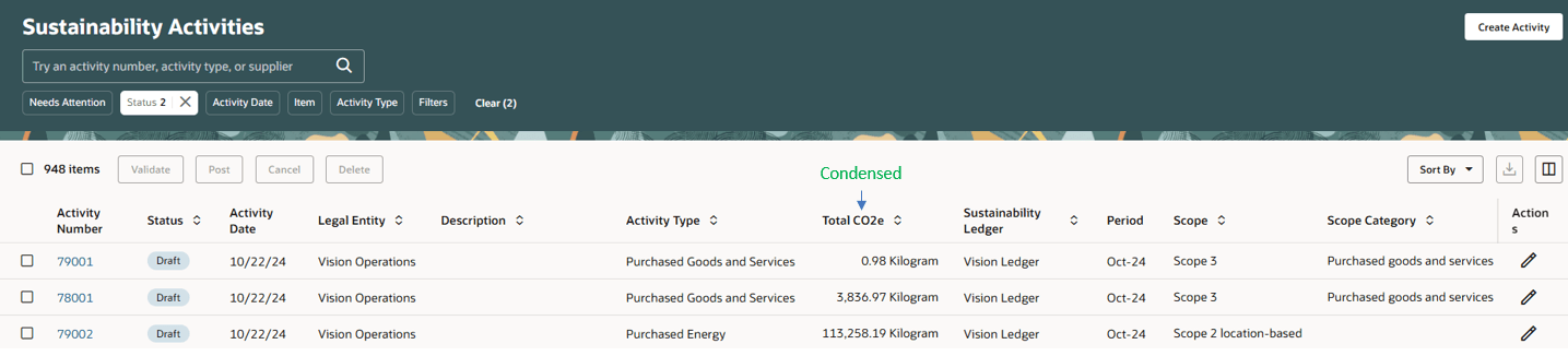

A1. Sustainability Activities Page
The following table lists the profile options used to control decimal precision on the Sustainability Activities page:
| Attribute | Profile Option |
Total CO2e |
Condensed Decimal Precision |
Sustainability Activities Page Displaying Condensed Precision Values in the Total CO2e Column

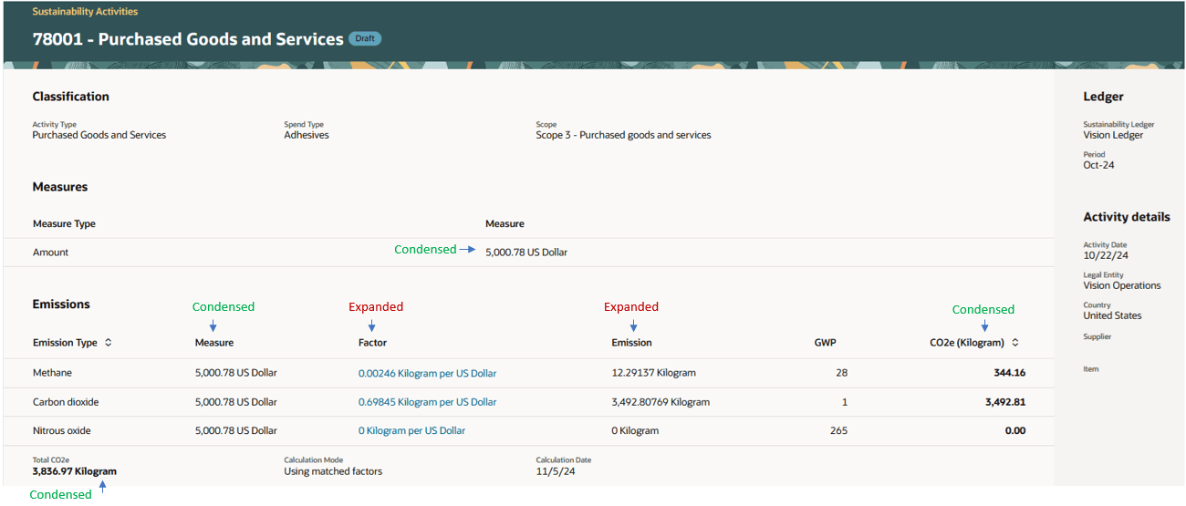

A2. Activity Details Page
The following table lists the profile options used to control decimal precision on the Activity Details page:
| Section | Attribute | Profile Option |
Measures |
Measure |
| Emissions | Measure | Condensed Decimal Precision |
| Emissions | Factor | Expanded Decimal Precision |
| Emissions | Emission | Expanded Decimal Precision |
| Emissions | CO2e |
| Emissions | Total CO2e | Condensed Decimal Precision |
Activity Details Page Displaying Fields with Condensed Precision and Expanded Precision Values

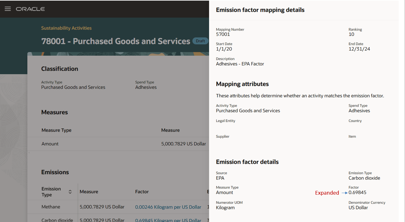

A3. Emission Factor Mapping Details Viewed on Sustainability Activities Details Page
The following table lists the profile option used to control decimal precision in the emission factor mapping details drawer:
Attribute |
Profile Option |
| Factor |

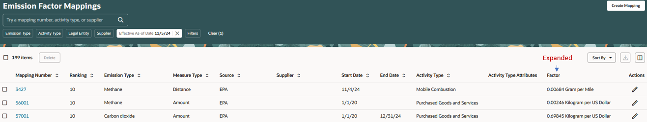

B1. Emission Factor Mappings Page
The following table lists the profile option used to control decimal precision on the Emission Factor Mappings Page:
Attribute |
Profile Option |
| Factor |
Emission Factor Mappings Page Displaying Extended Precision Values in the Factor Column

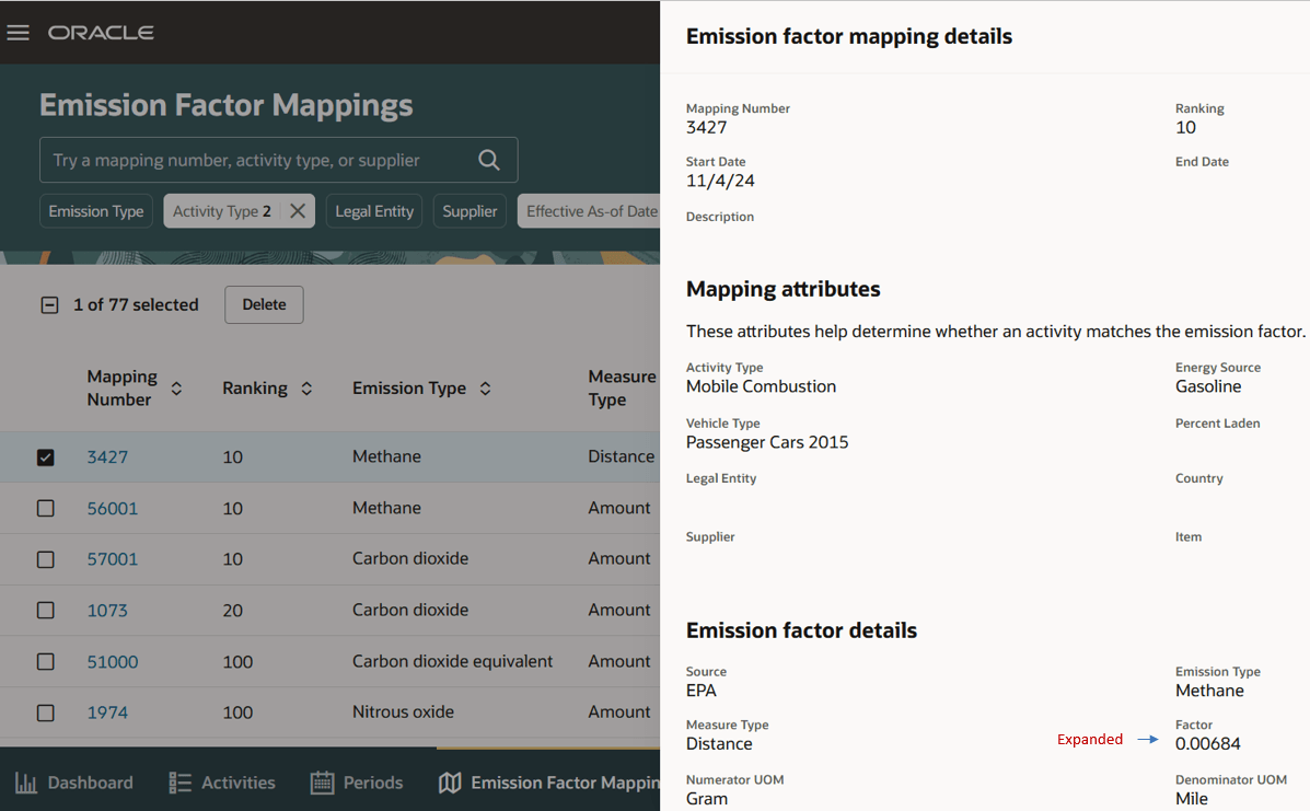

B2. Emission Factor Mappings Details Drawer
The following table lists the profile option used to control decimal precision on the Emission factor mappings details drawer:
Attribute |
Profile Option |
| Factor |
Emission Factor Mappings Details Drawer Displaying Extended Precision Value in the Factor Field
