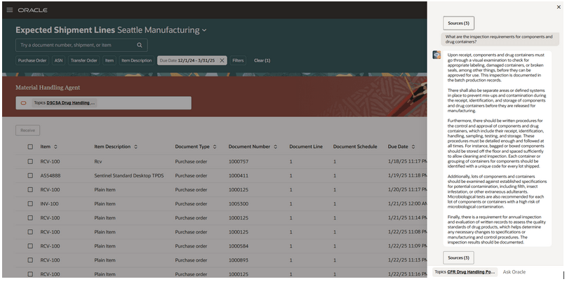

Receiving Agent Example
Example: Receiving Agent interacts with AI agent to inquire about material handling best practices to ensure compliance
