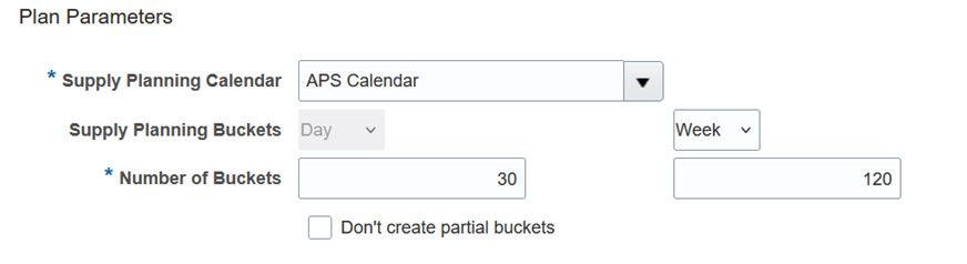

You can now plan for a longer horizon and can use up to 150 total time buckets of different sizes. For example, 150 day buckets or 30 day buckets and 120 week buckets or 150 week buckets.
        Plan Parameters
Plan Parameters

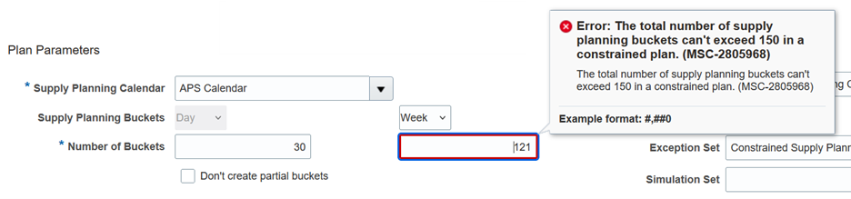

If you try to enter more than 150 buckets, you will see an error:
  Plan Parameter: Error if total number of planning buckets exceeds 150
