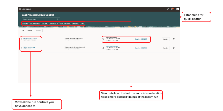

You can now view all accessible run controls and use filters to quickly search for a specific run control by cost book or process ID.
Figure 1 - Cost Processing Run Control

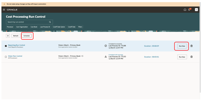

Click Run Now to immediately initiate the Create Cost Accounting Distribution process for a run control or click the Schedule button to run it at a later time or periodically.
Figure 2 - Trigger a run control immediately
You can now track the process status and also click the messages to view detailed error information encountered during process run for a run control.
Figure 3 - View the Status of the Run

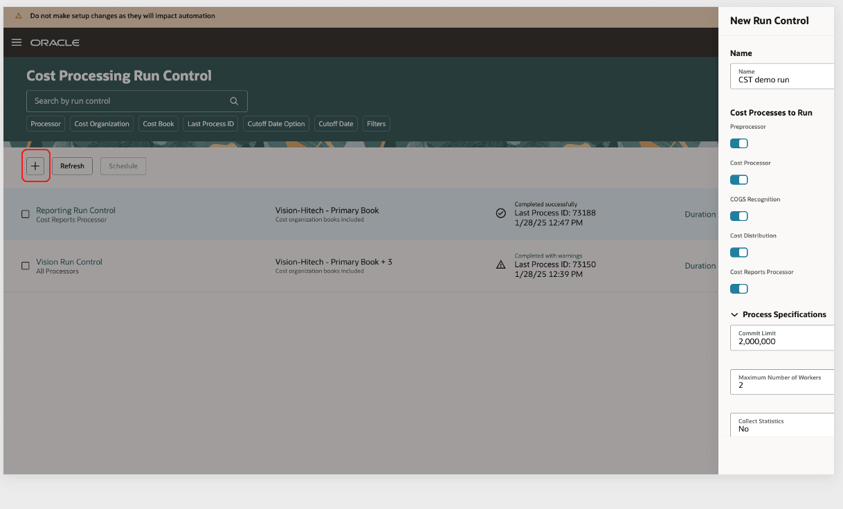

Click the Add (+) icon to create a new run control. You can now choose to collect statistics of the process run for a run control.
Figure 4 - Drawer Opens to Add Details

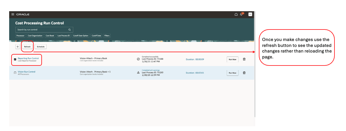

Click the Refresh button to instantly view changes without reloading the entire page.
Figure 5 - Refresh Button to View Changes
