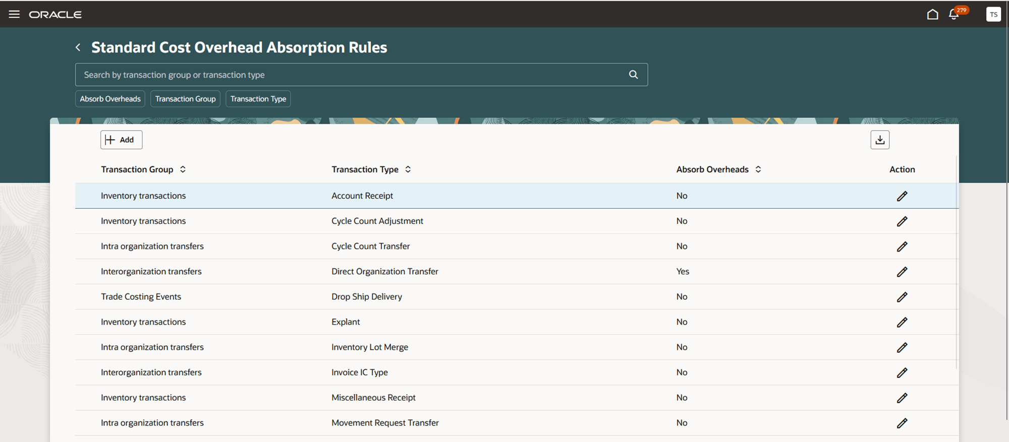

You can define an item standard cost to include overhead cost elements from the Standard Cost Overhead Absorption Rules page in the Cost Accounting work area.  You can now create, modify, delete standard cost overhead absorption rules using Redwood pages. You can verify the existing rules and also download the information into a spreadsheet for offline analysis and collaboration.
The overhead costs are absorbed and accounted for against all receipt transaction types by default. However, you can define which transaction groups and transaction types must absorb the overhead for standard costed items. This lets you to account for overhead absorption for specific transactions. You can view, create, update and delete rules directly from the Standard Cost Overhead Absorption Rules page.
