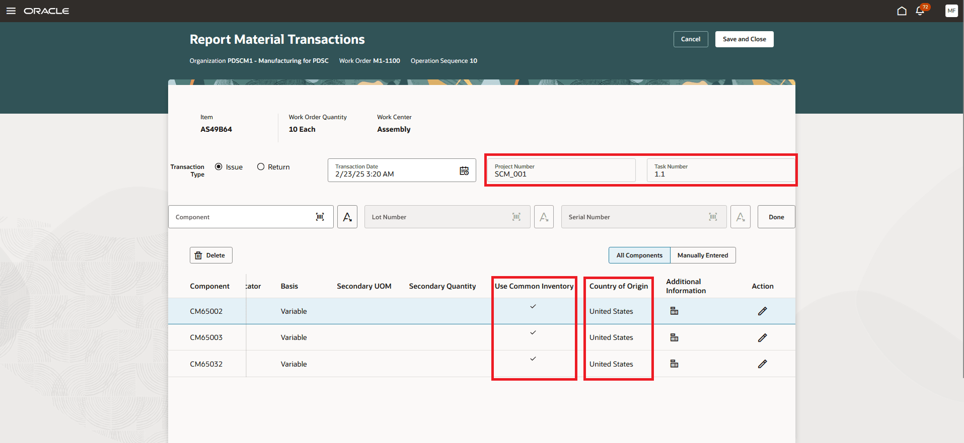

You can now report materials for a specific project and task in a discrete or process manufacturing work order operation using a Redwood page. These material transactions let you issue materials from inventory to the work order operation and return the issued materials back to inventory using project-specific inventory or common inventory, depending on the configuration of the Allow Use of Common Supplies item attribute. You can also report material transactions for a specific country of origin to update on-hand balances by country.
Report Material Transactions with Project, Task, and Country of Origin
Through material usage reporting, manufacturers can accurately track inventory by project, task, and country of origin for better cost tracking and compliance reporting on import and export documents.
