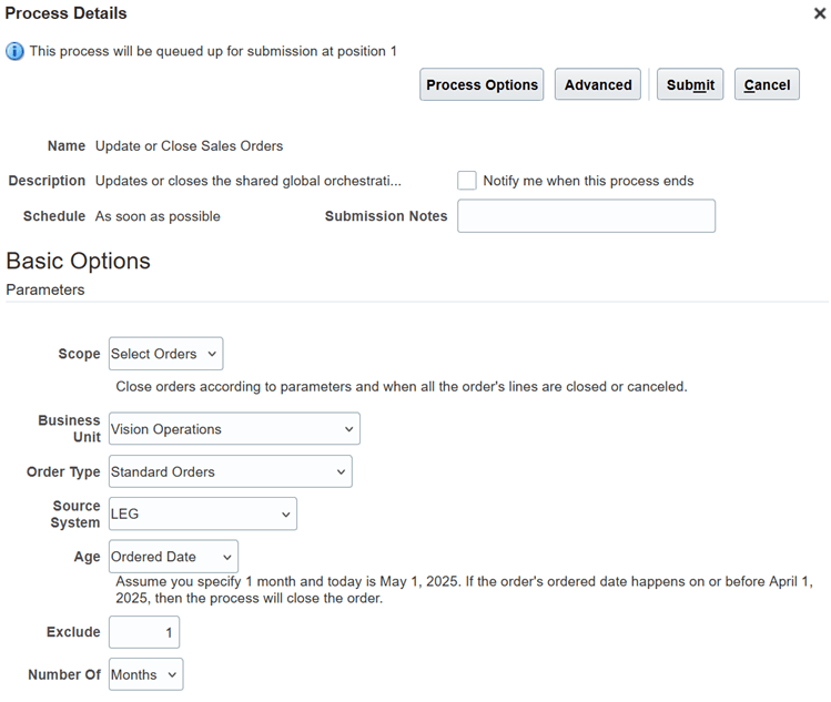

For example, set the Scope to Select Orders, then the new scheduled process will close orders according to the parameters that you set and when all of the order's lines are closed or canceled:
Set the Age:
Value |
Description |
Ordered Date |
Filter according to the sales order's Ordered Date attribute. Assume you exclude 1 month and today is May 1, 2025. If the order's ordered date happens on or before April 1, 2025, then the process will close the order. |
All Lines Closed |
Filter according to when all of the sales order's lines were closed. Assume you exclude 1 month and today is May 1, 2025. If all the order's lines were closed on or before April 1, 2025, then the process will close the order. |
Immediate |
Filter starting today. Assume today is May 1, 2025. If all the order's lines were closed on or before May 1, 2025, then the process will close the order. |
If you set Scope to All Orders, then the scheduled process will close orders when all of the order's lines are closed or canceled. Assume today is May 1, 2025. If all the order's lines were closed on or before May 1, 2025, then the process will close the order.
