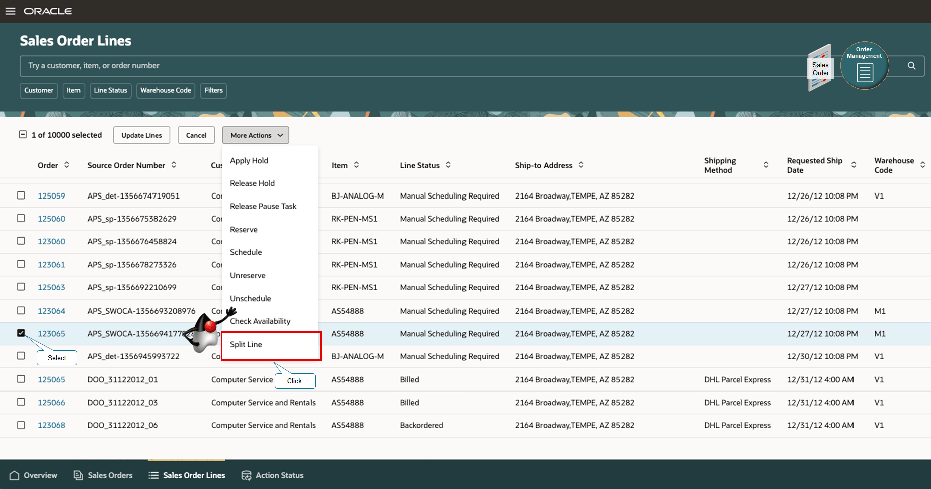

  1. Select a line that isn't in draft status and that isn't fulfilled on the Sales Order Lines page, then click More Actions > Split Line:

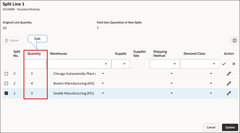

  2. Use the Split Line dialog to specify how you want to split the line across warehouses:
    Split line dialog

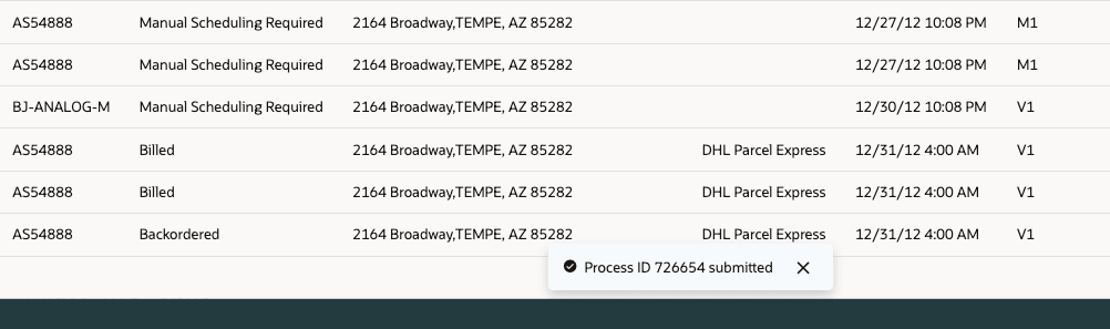

    The split starts a scheduled process that runs in the background. Notice the value of the process ID in the message, such as 726654:
    Note the process ID
Click the Action Status tab, then monitor the status for the 726654 scheduled process.

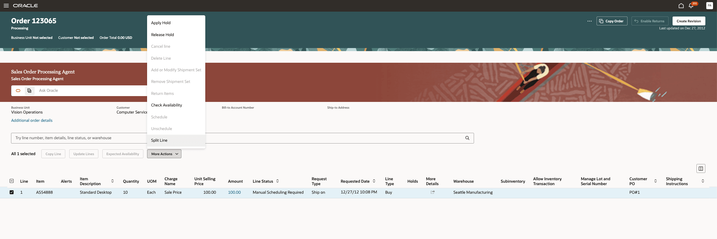

Split on the Order Page
Open a sales order, select the line that you need to split, then click More Actions > Split Line:
Split line in the View Order screen
