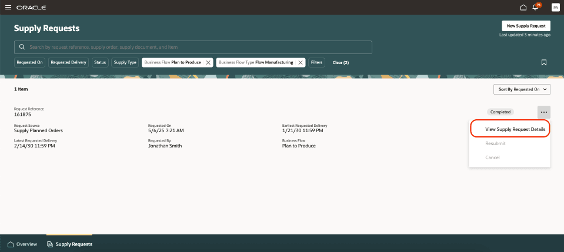

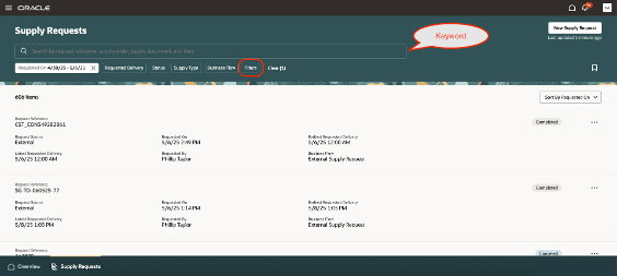

- Go to your home page, then click Supply Chain Execution > Show More > Supply Requests.
- Search for your request on the Supply Requests page:

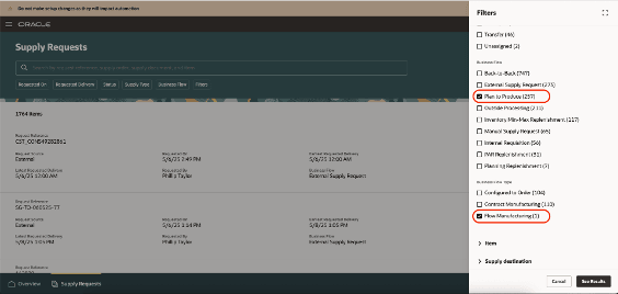

- Use filters to focus the search results:
- Plan to Produce. Filter the supply requests that you received from Supply Planning.
- Flow Manufacturing. Filter supply requests that have a flow schedule.
- In the search results, notice that the Request Source attribute contains Supply Planned Orders and the Business Flow attribute contains Plan to Produce, then click View Supply Request Details:

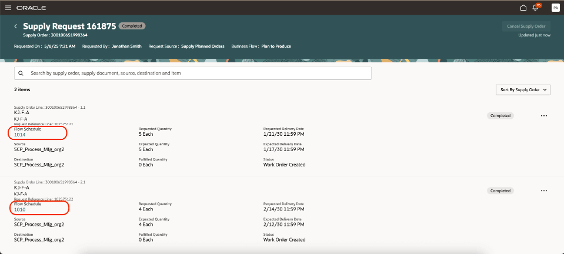

- Examine the details, then click 1014 under Flow Schedule:

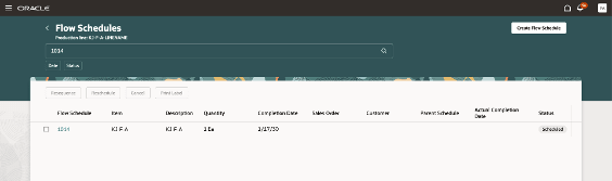

- Examine details about the flow schedule that Manufacturing created:
