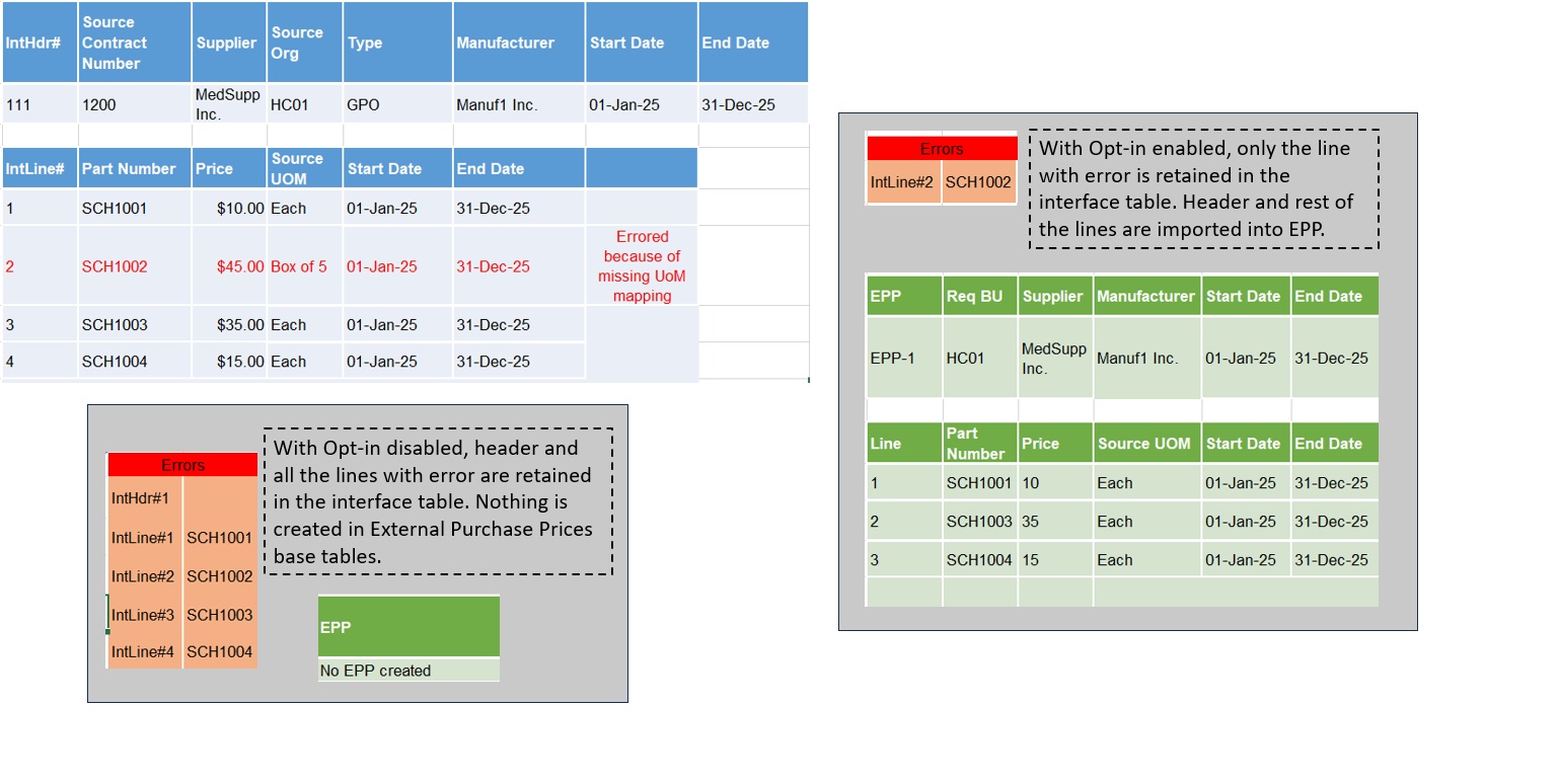

For example, suppose you have an interface header 111 with four lines. Now suppose one line for the SCH1002 part number has the Source UOM set to Box of 5, which has not been defined in the External Purchase Prices Unit of Measure mapping. Prior to this update, the header and all the four lines were retained in the Interface tables with errors. No external purchase price was created. In this scenario, you can either correct the data in the interface table or create a mapping and then reprocess the records.
However, with this update, only the line with error (that is, SCH1002) is retained in the interface table as error and the other lines with the header are created as an external purchase price record. In this case, you cannot reprocess the record in error even if the mapping is fixed. You need to reimport the required data again for it to be picked up for processing. Then, delete the interface records in error.
Illustration for Interface Table Data and Resultant Behavior With Opt-in Enabled and Disabled

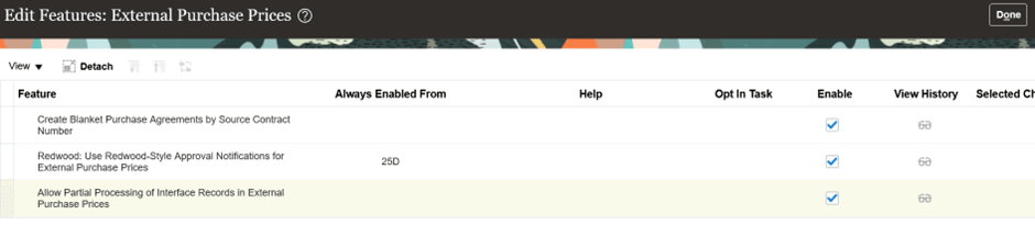

Steps to Enable
Use the Opt In UI to enable this feature. For instructions, refer to the Optional Uptake of New Features section of this document.
Offering: Procurement
In the Offerings work area, enable the Allow Partial Processing of Interface Records in External Purchase Prices feature:
  • Offering: Procurement
  • Functional Area: External Purchase Prices
Select the Enable checkbox corresponding to the Allow Partial Processing of Interface Records in External Purchase Prices feature, and then click Done.
Opt-in Allow Partial Processing of Interface Records in External Purchase Prices.
