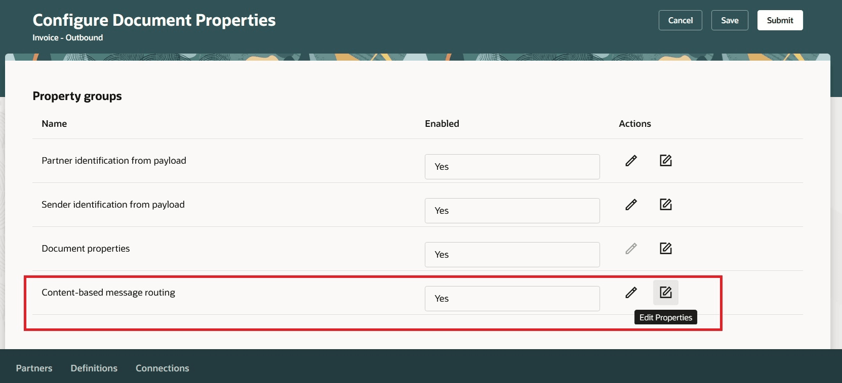

- If the document is an outbound invoice, you can enable the content-based message routing property group.
- On the B2B Documents page, select the Invoice Outbound document, then select Configure Document Properties.
- On the Configure Document Properties page, enable the Content-based message routing property group and select Edit Properties.
Enable Content-Based Message Routing

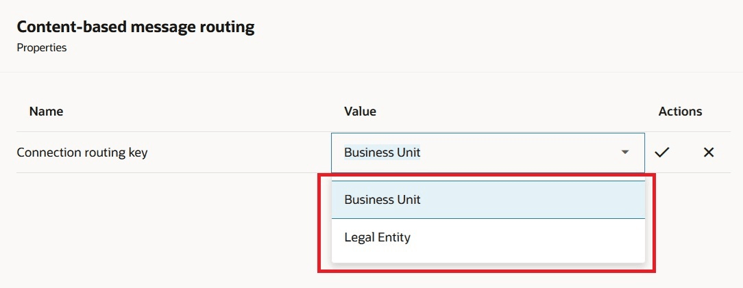

- c. On the Properties page for Content-based message routing, select Business Unit or Legal Entity for the connection routing key. This determines whether the invoice will be routed based on the value for business unit or legal entity from the payload.
- d. Click Submit.

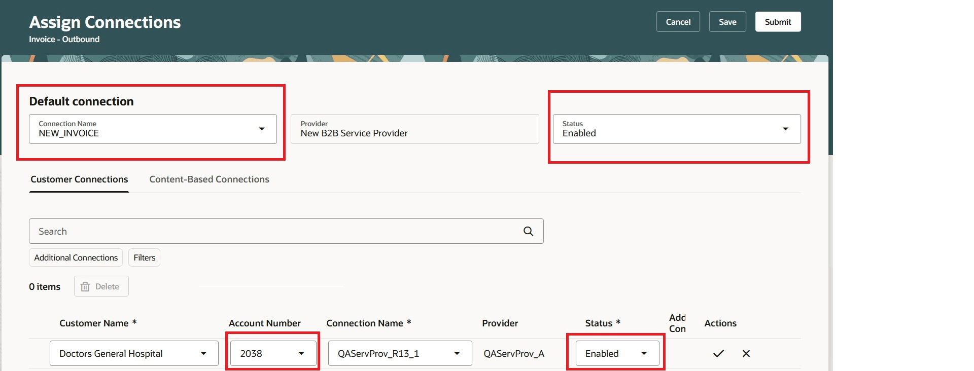

- On the B2B Documents page, select the outbound document you are configuring and click Assign Connections.
- On the Assign Connections page, select a default connection for the document and enable it.

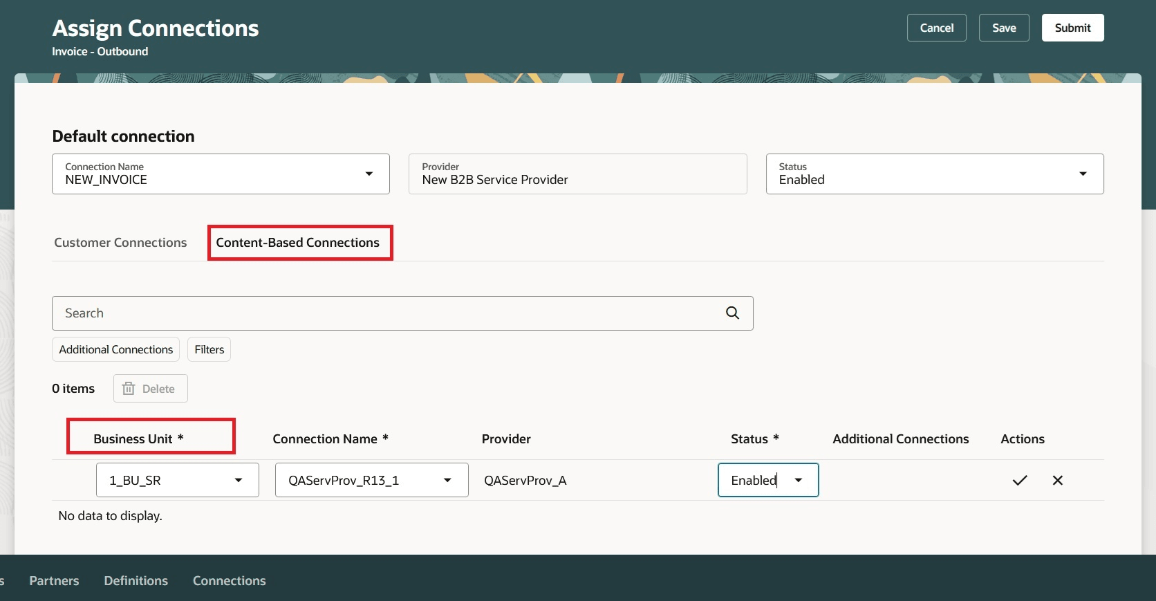

- Depending on the document, you can also assign a customer or supplier connection. Additionally you can assign a content-based connection for outbound invoices.
a. Customer connections can be assigned to a customer or a customer account.
b. Supplier connections can be assigned to supplier or a supplier site.
Default and Customer Connection
- The content-based connection for Invoice-Outbound document displays either business unit or legal entity, depending on what connection routing key was configured. Enter a value for the Business Unit or Legal Entity and select a connection. Set the Status to Enabled.
- Click Submit.

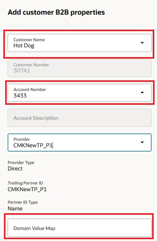

Set Up B2B Partner Properties
You can define B2B properties for the following use cases:
- Associate domain value maps to your customers or suppliers.
- When you are using a service provider and you haven’t configured the document property to get partner identification from payload, you need to add B2B properties to define partner information.
Here’s how you add B2B properties:
- Select B2B Properties from the Task Panel.
- Select either the Customer B2B Properties or Supplier B2B Properties tab.
- On the Customer B2B Properties tab, click Add.
- Enter the customer details on the Add customer B2B properties drawer. Note that the customer account is optional.
- Click Save.
Add Customer B2B Properties
