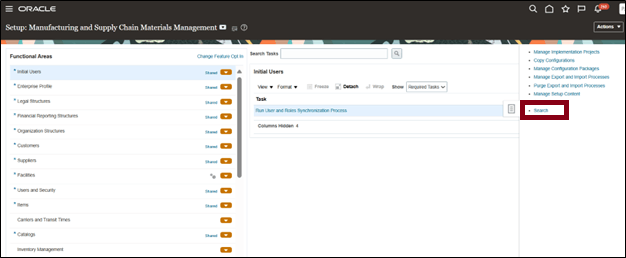

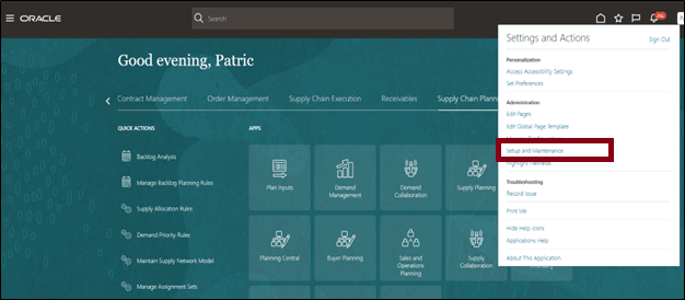

  1. Go to Setup and Maintenance.
Setting and Actions drawer

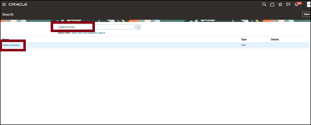

  1. Click the Tasks icon.
  2. In the Tasks pane, select Search.
Search
  1. In the search box, type guided journeys.
Guided Journey
  1. Click the Guided Journeys link from the results.

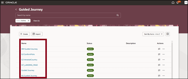

    The Guided Journey page opens that lists all the existing guided journeys.
GJ created

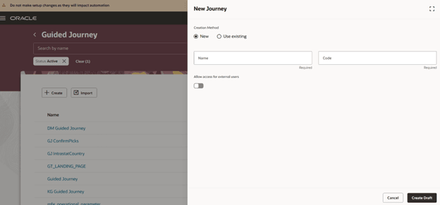

  1. Click Create to create a new guided journey.
    The New Journey drawer opens.
  2. Select New.
  3. Enter a preferred name and code.
New GJ

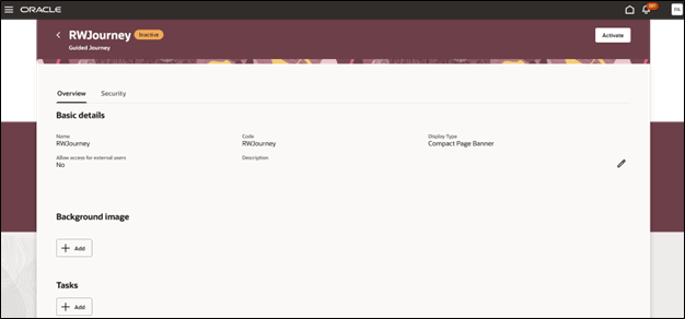

  1. Click Create Draft.

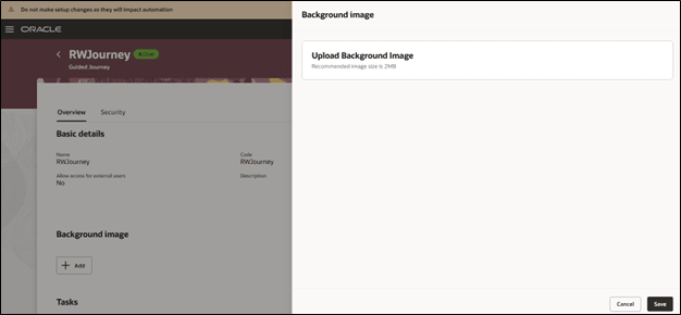

    The Journey builder page opens.
  2. Add or edit the basic details of the guided journey.
adding details
  1. (Optional) Click Add to upload a background image.
  1. Click Add to add a task to the journey.

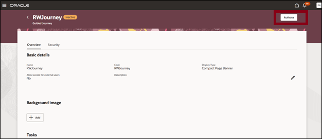

  1. Click Save.
    All the tasks for this guided journey appear as a list. You can edit or delete the task using the respective icons displayed with the task.
  2. Click Activate.
The Guided Journey is live and available on the associated application page.

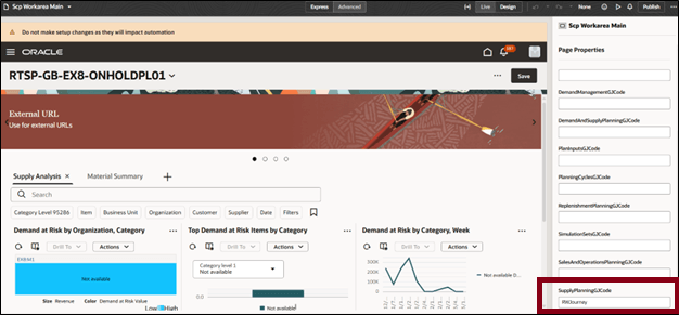

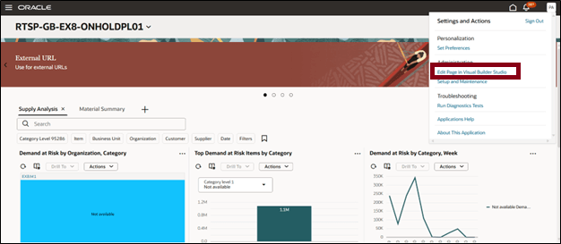

  1. On the planning page, select Edit Page in Visual Builder Studio.
Edit Page in Visual Builder Studio Option

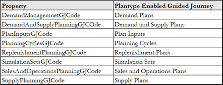

The page Scp Workarea Main has multiple properties related guided journeys, one for each plan type as shown in the following table:
code for plantype
Consider a supply plan.
  1. In VB Studio, locate the field labeled SupplyPlanningGJCode for Supply plans.
  2. You can attach a guided journey created to specific plan type based on the code fields selection.
  3. Enter the journey code of the Guided Journey you created earlier.
  4. Press Enter.
  5. Click the Publish icon to make your changes live.
  6. Close the VB Studio tab once publishing is complete.

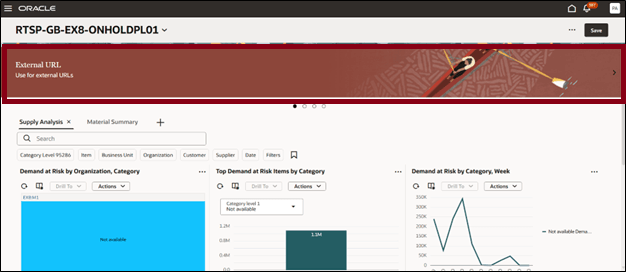

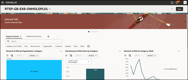

    The Guided Journey banner should now be visible.
banner

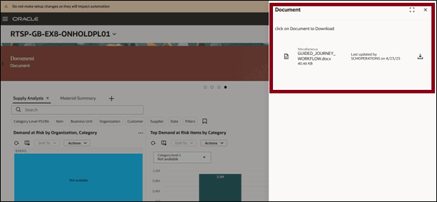

Use the Guided Journey banner

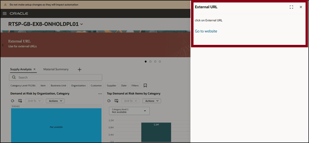

Click the banner to explore External URLs, attached documents, or any other configured tasks.
external url
documents
