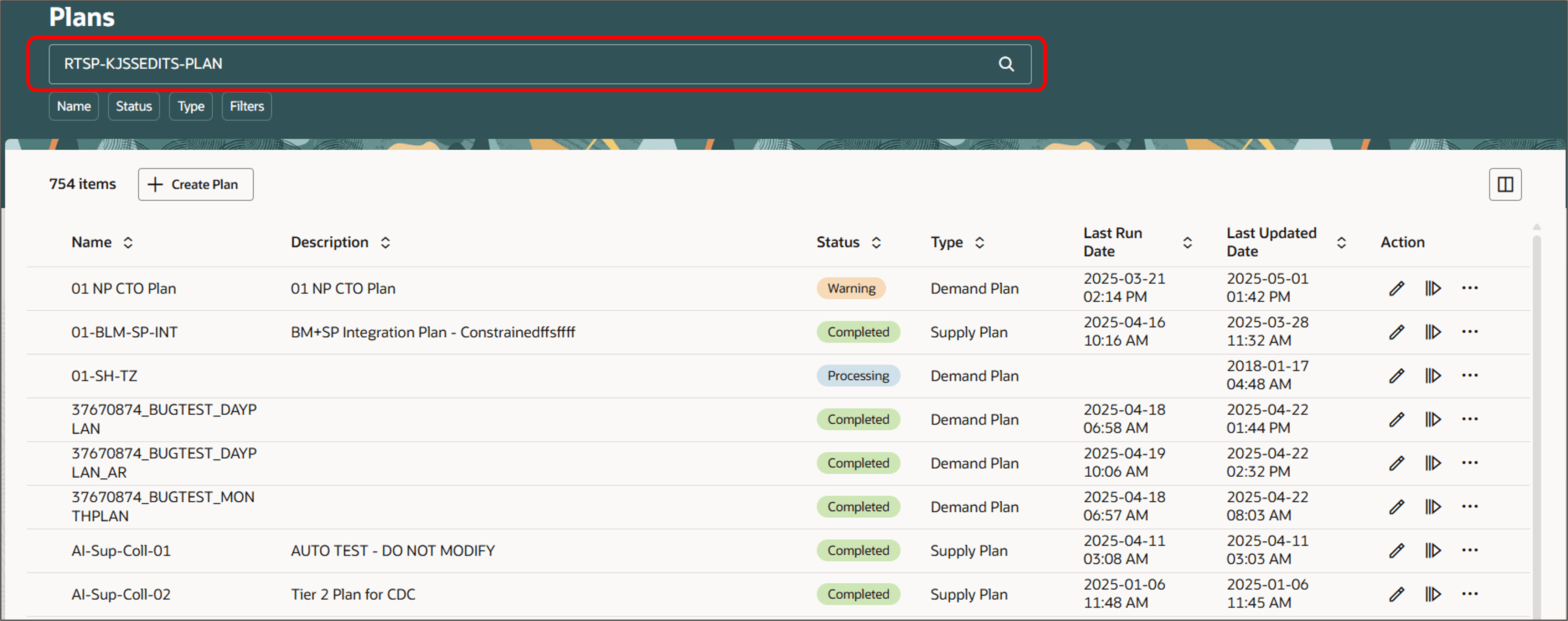

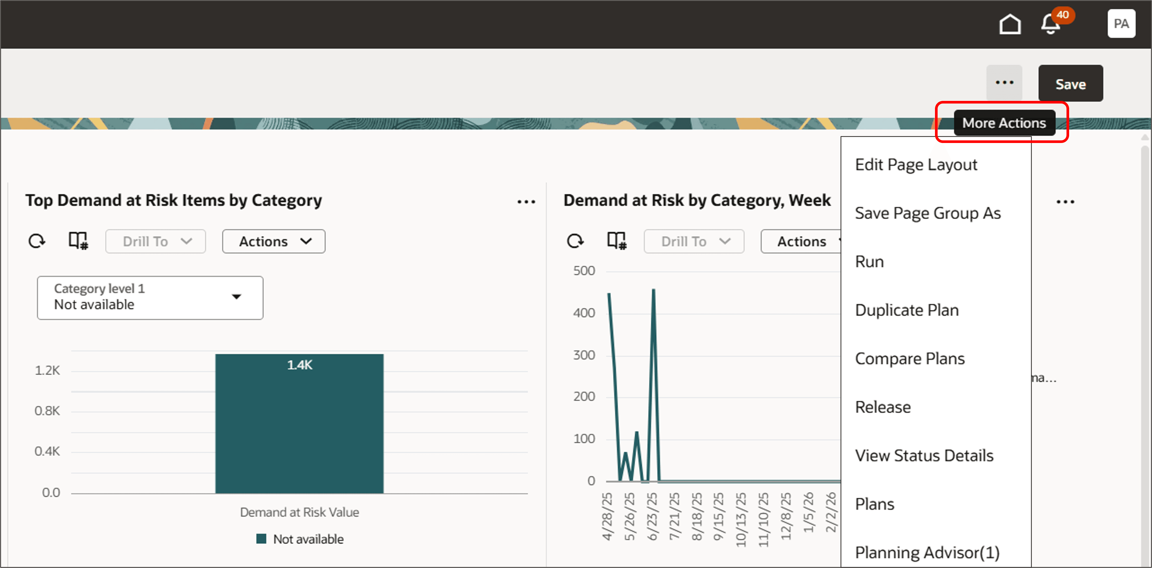

- Navigate to the More Actions (…) menu and select Plans.
Select Plans in the Redwood Supply Chain Planning Work Area

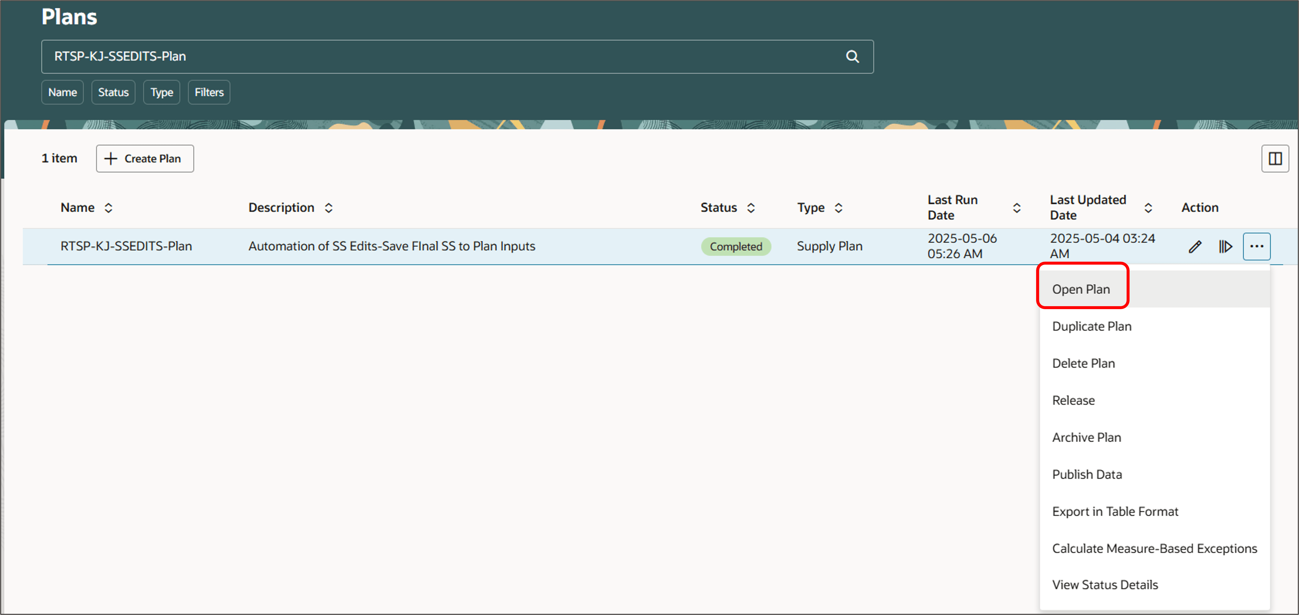

- Enter the name of your plan in the search field at the top of the page, as highlighted in the following image.
Search for Plan
- From the Action menu, select Open Plan.
Open Plan

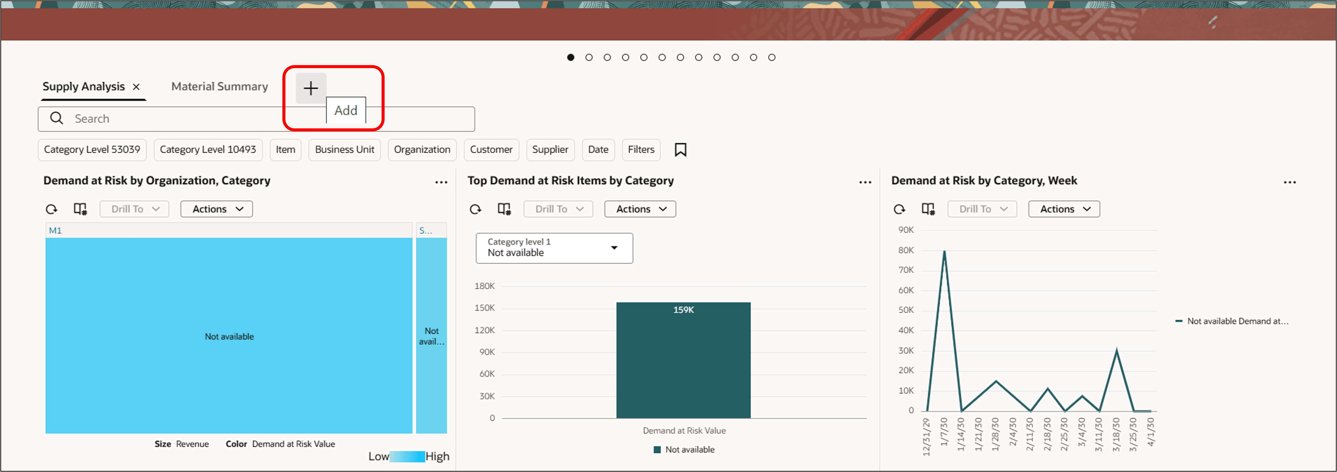

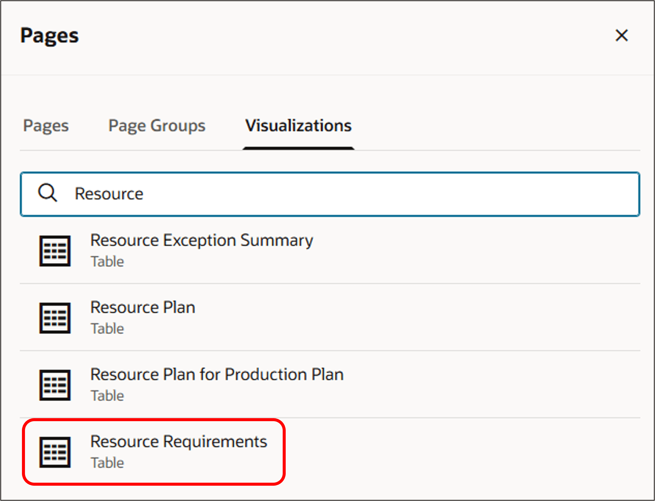

- Click the Add (+) icon to add a page:
Add Pages
- The Pages drawer opens. From the Visualizations tab, search for and select Resource Requirements.
Selecting Resource Requirements from the Visualizations Tab
The Resource Requirements table opens.

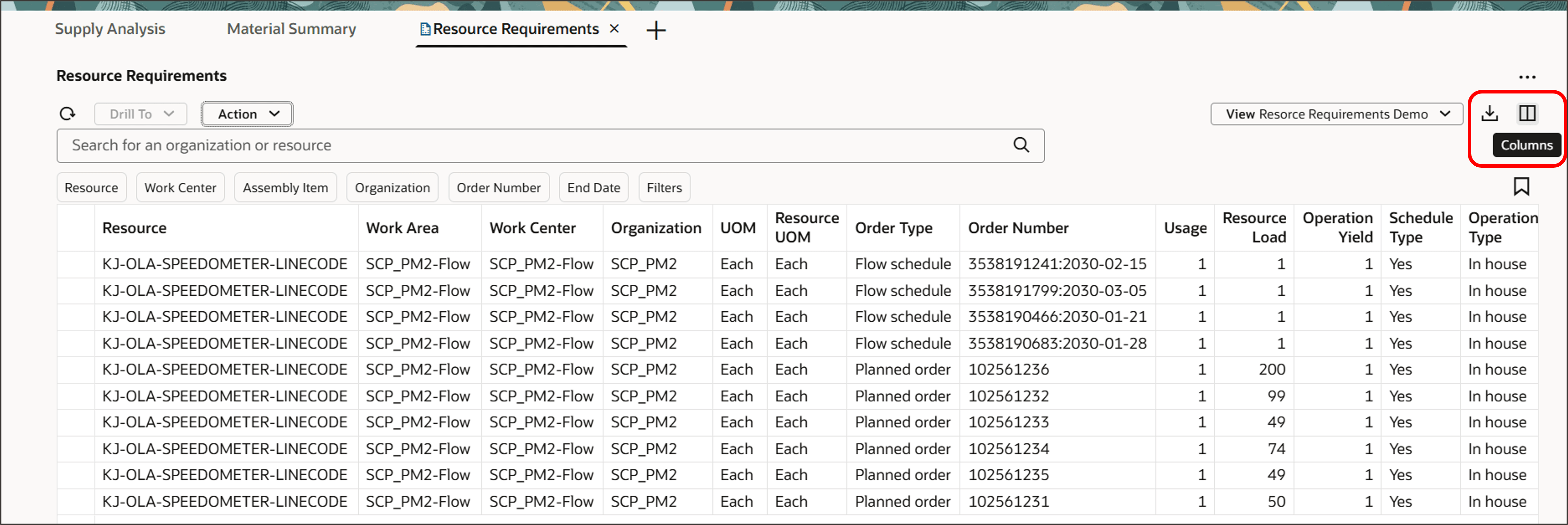

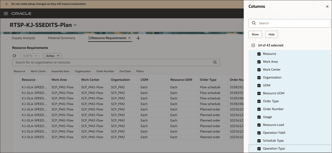

- You can select which columns you want to appear in the table by doing the following:
- Click the Columns icon:
Resource Requirements Table with Columns Icon
Select your desired columns from the Columns drawer:
Selecting Columns from the Columns Drawer
The columns you’ve selected now appear on the table.

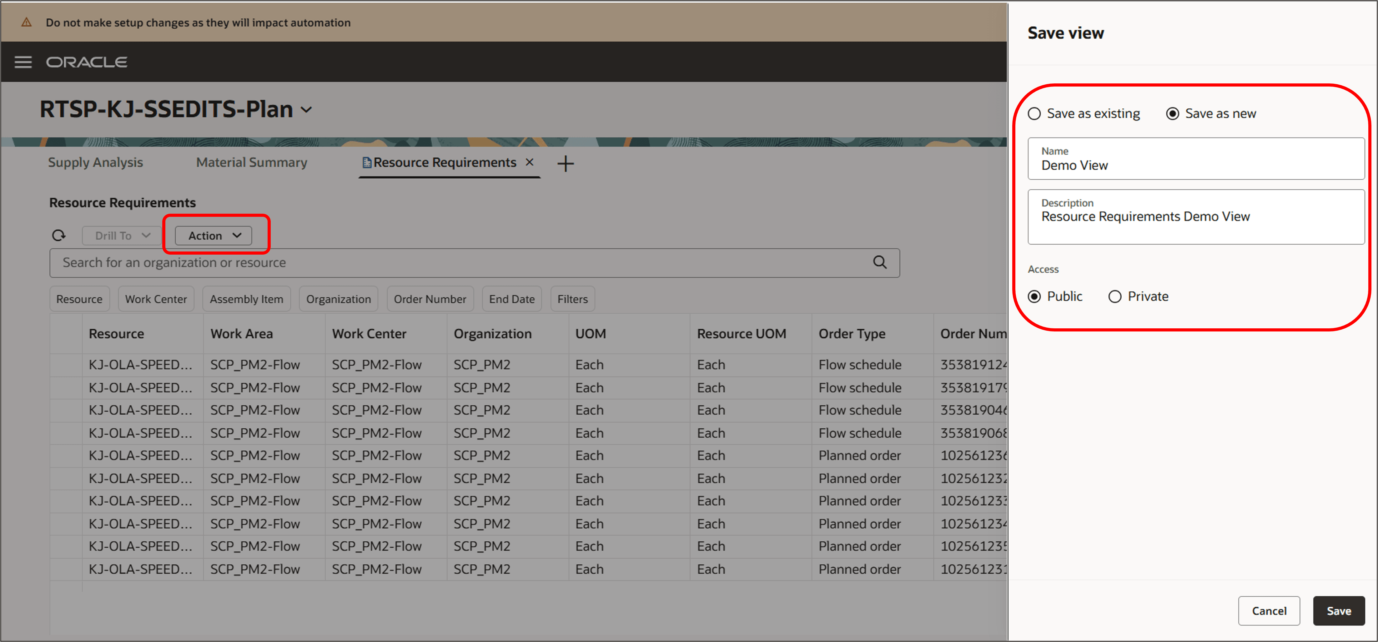

- If you want to save this view, click the Action menu and select Save View. The Save view drawer opens, where you can name and save your view.
Save View
The Action menu list of values includes Save View, Restore View, and Delete View.

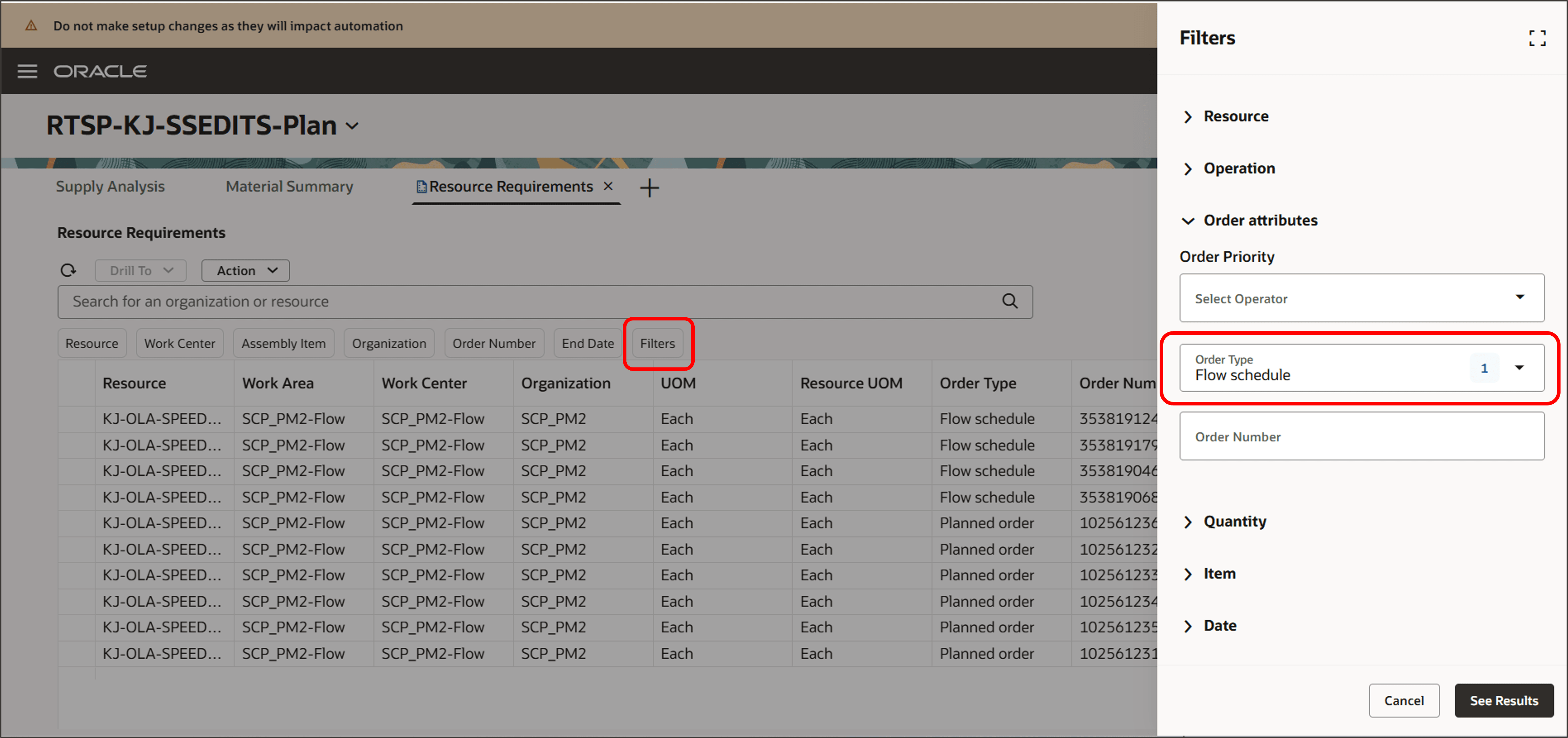

- You can also filter the results in the table in several ways.
- Click the Filters button on the toolbar, and select the desired attributes to filter by in the Filters drawer, such as Order Type:
Filtering by Order Type of Flow Schedule
The Filters panel includes the following filter groups:
- Resource
- Operation
- Order Attributes
- Quantity
- Item
- Date
- Supplier

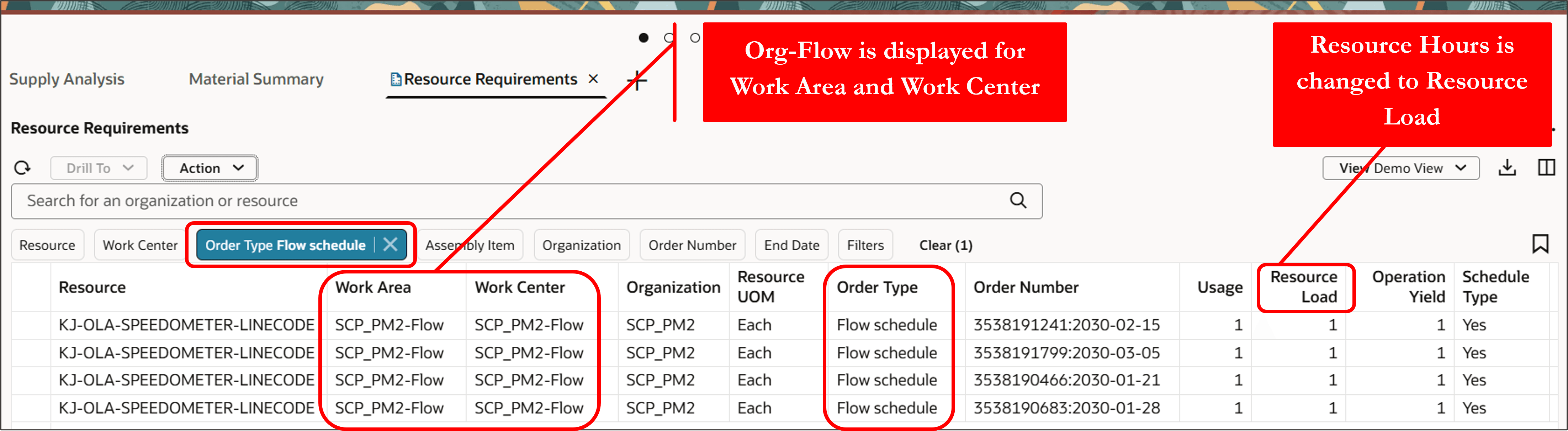

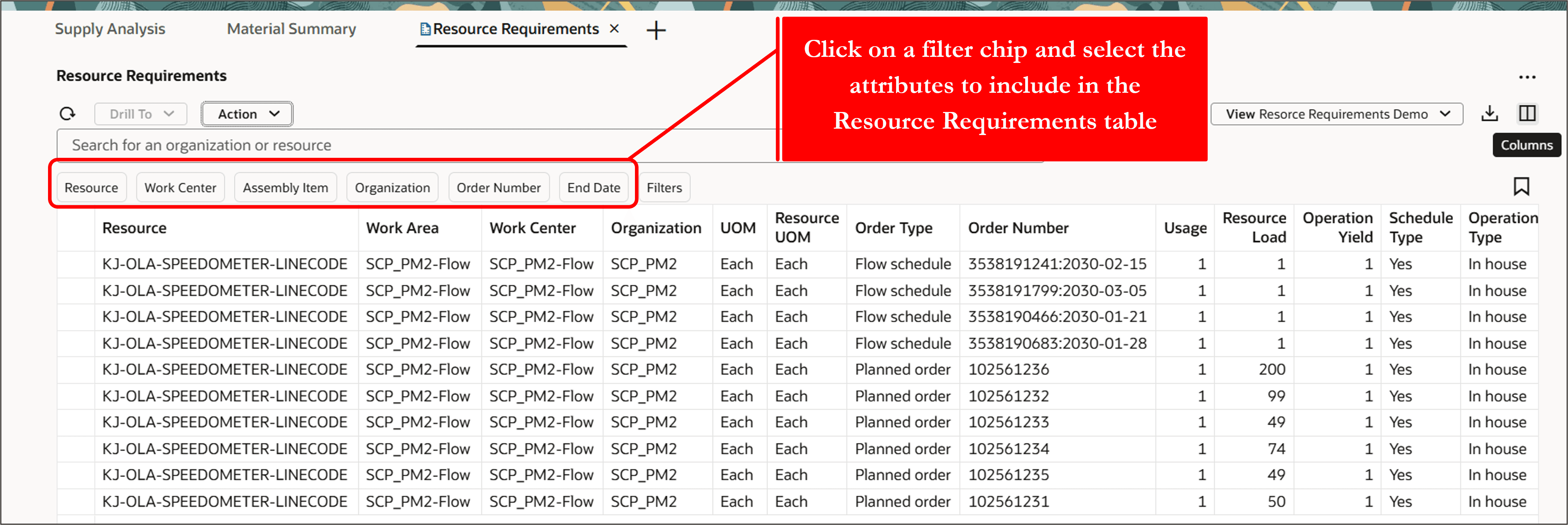

- In addition to filter groups, you can use the filter chips on the toolbar to filter the attributes.
Filter Chips on the Resource Requirements Table

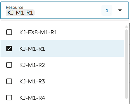

For example, you can click on the Resource filter chip and then select the resources to include in the Resource Requirements table:
Selecting a Resource to Filter By
In this example, Resource Requirements attributes are filtered for the Order Type of Flow schedule.
Resource Requirements Filtered by Order Type
