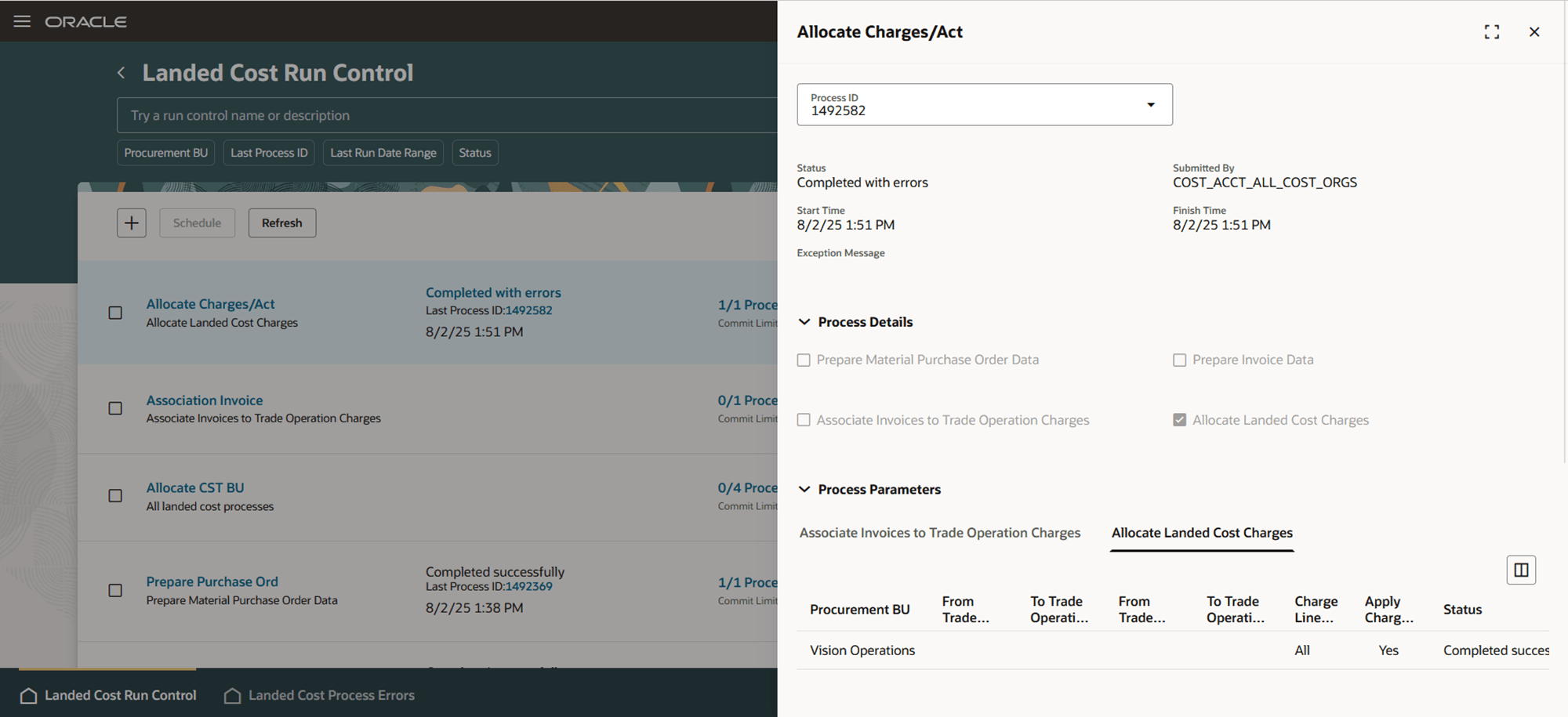

Some of the key features of the new user experience are:
  • View all your accessible landed cost run controls on a single page. Use the keyword search, contextual filters, and filter chips to access the desired run controls.
  • Create new landed cost run controls or update existing ones by specifying parameters. This flexibility helps you schedule and tailor landed cost processing as per your business requirements.
  • Drill down to any past landed cost process to view the parameters used during execution and its run status. This helps in understanding prior configurations, validating results, and troubleshooting issues when needed.
Landed Cost Run Control page with navigation details
Screenshot for viewing status and parameters for a process ID and run control
