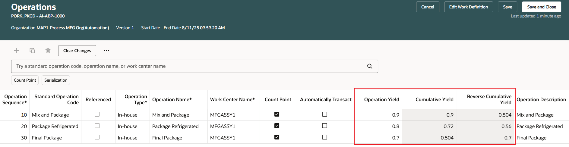

Operation Yield Values for Process Work Definition Operations

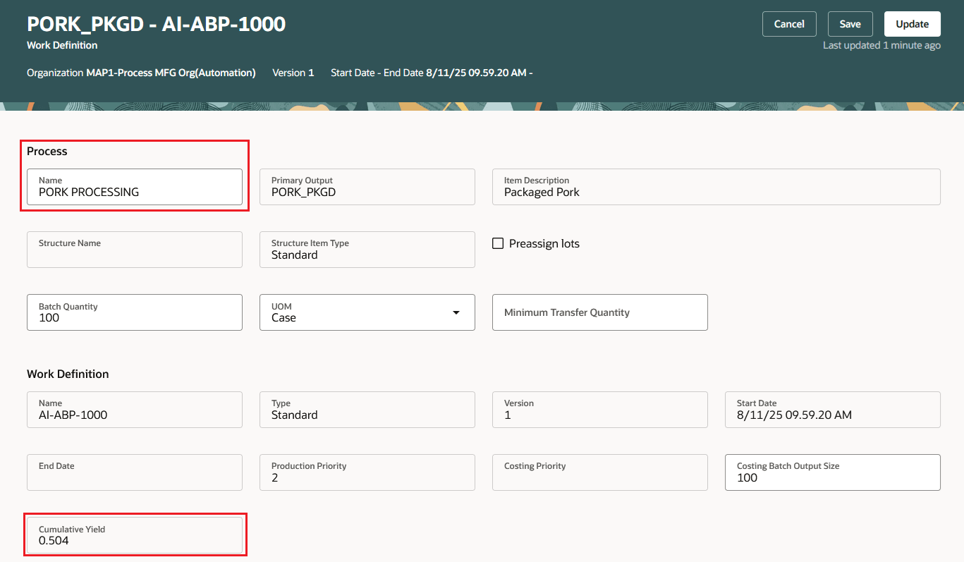

Cumulative Yield for the Process Wok Definition
Cumulative Yield for the Process Work Definition

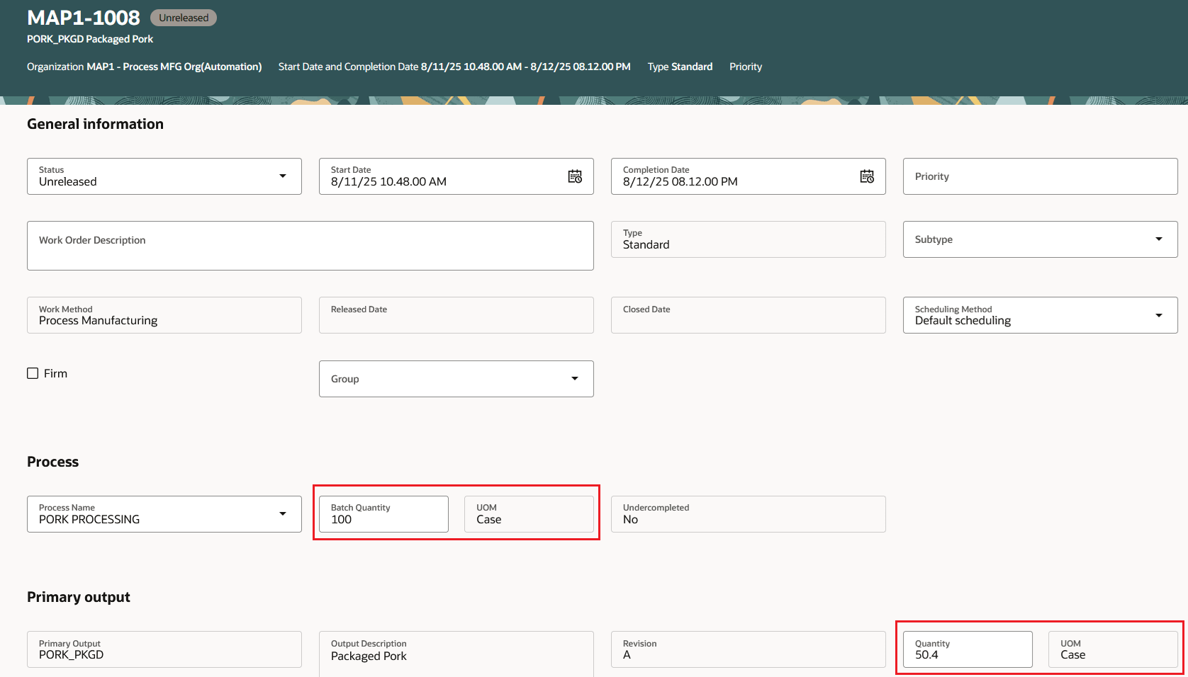

Process Work Order - Batch Quantity, Primary Output Quantity based on Yield
Process Work Order - Batch Quantity and Primary Output Quantity Based on Yield

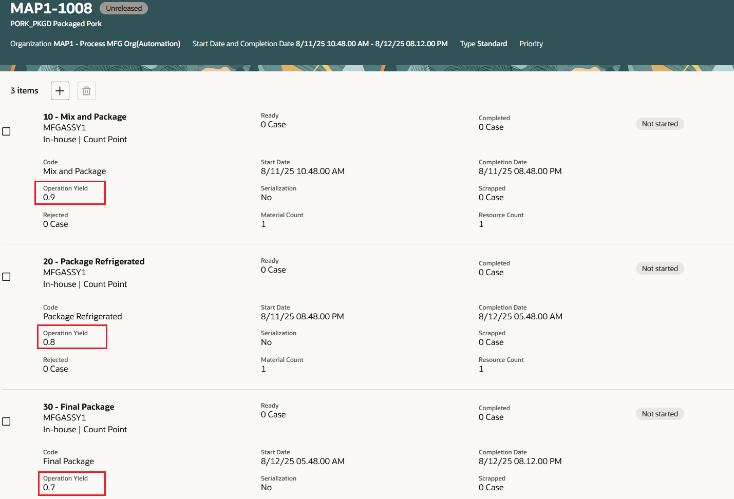

Operation Yield for Process Work Order Operations

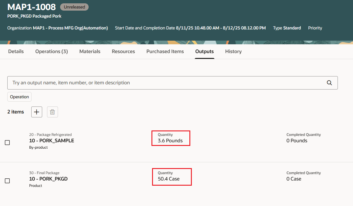

Process Work Order Outputs based on Operation Yield values
Process Work Order Outputs Based on Operation Yield Values

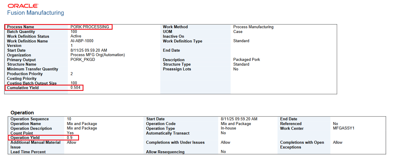

Work Definition Report - Cumulative Yield and Operation Yield

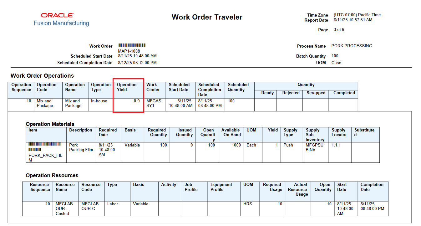

Process Work Order Traveler Report - Operation Yield
