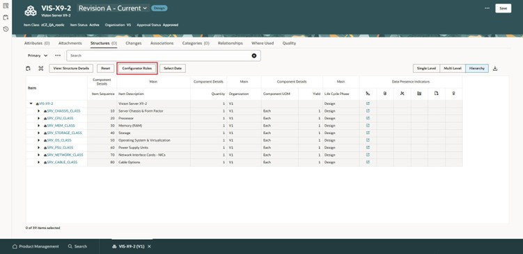

Create, edit, and test configurator rules while you manage an item's structural details in the Product Information Management work area. Use an intuitive IF Then structure and numeric rules on redesigned pages to set up your rules.

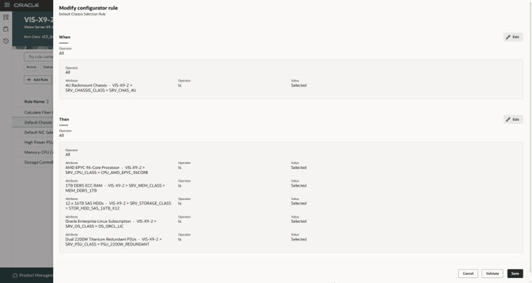

Use IF THEN logic on the workarea's redesigned pages:

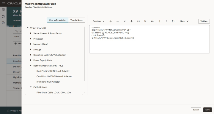

Use numeric formula rules to make your configuration more accurate. Drag and drop components directly onto your rule, then use the new contributesTo operator to replace the CDL rules that used the Add. . .To keywords. contributesTo can calculate a component's quantity in each configuration:

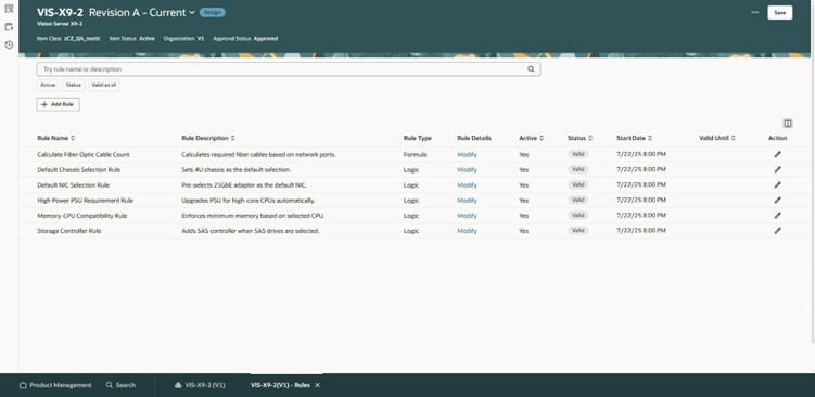

Manage all your rules in a single location:
