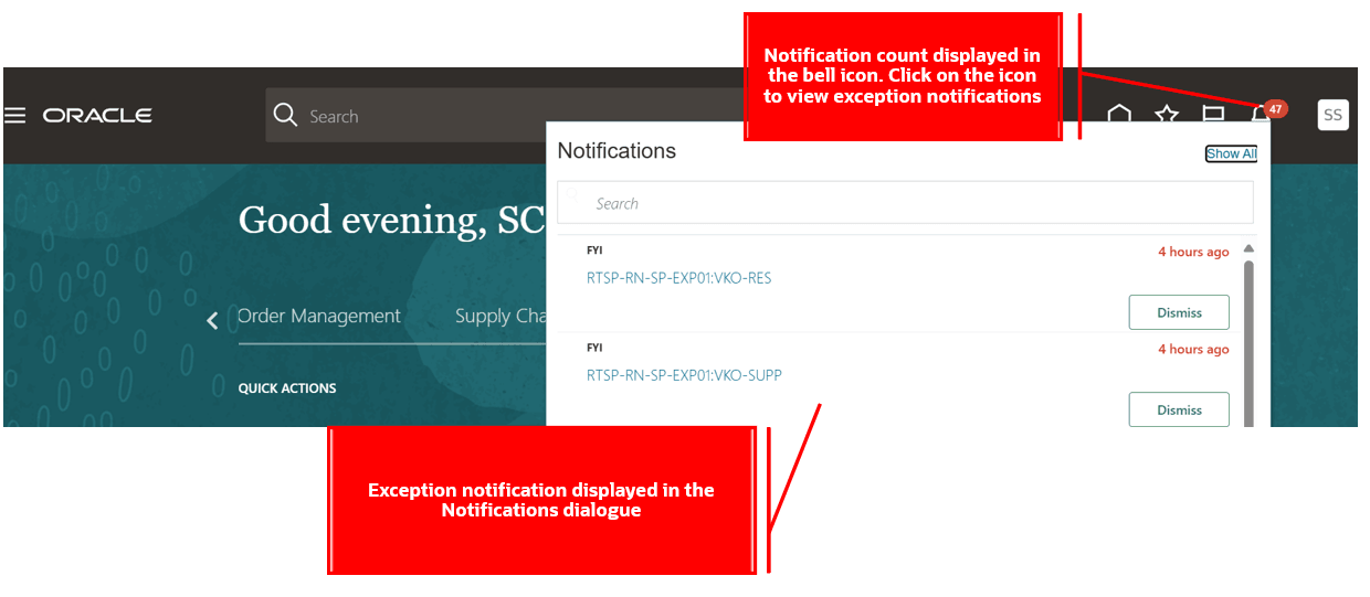

- Run the plan using the full refresh option. If exceptions are found, the alert (bell) icon displays the number of Redwood-style notifications.
- Click the alert icon to view detailed information about the details.

Exception Notifications Displayed in Notifications Dialogue

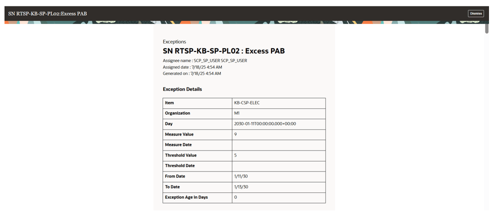

Redwood-Style Exception Notification Sections and Attributes
The header section displays the following information:
- Plan name and Exception name
- Assignee name, Assigned date, and Generated On attributes
The details section displays the following information:
- Exception details: One or more exception details, each in a separate table
- Each exception detail includes:
- Default attributes such as Measure Value, Measure Date, Threshold Value, Threshold Date, From Date, To Date, and Exception Age in Days.
- Dynamic attributes based on the exception’s configuration. For example, if an exception is configured based on the Projected Available Balance measure, with Item as the Product dimension hierarchy level, and Organization as the Organization dimension hierarchy, then Item and Organization will appear as the dynamic attributes in each exception detail.
Redwood-Style Plan Exception Notification

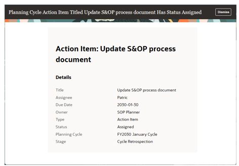

Planning cycle notifications are sent for tasks, action items, and decision items.
Notification Details include the following task attributes: Title, Assignee, Due Date, Owner, Type, Status, Planning Cycle, and Stage. A participant’s display name is used for Assignee and Owner instead of username.
Redwood-style FYI Notification for a Planning Cycle Action Item
