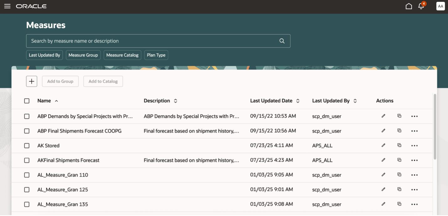

On the Measures page, you can view, create, duplicate, and edit measures.
In the search bar, you can search for measures by their names or descriptions. For example, you can search for measures containing "Final Shipments Forecast" in their names or descriptions.
Search Bar on Measures Page

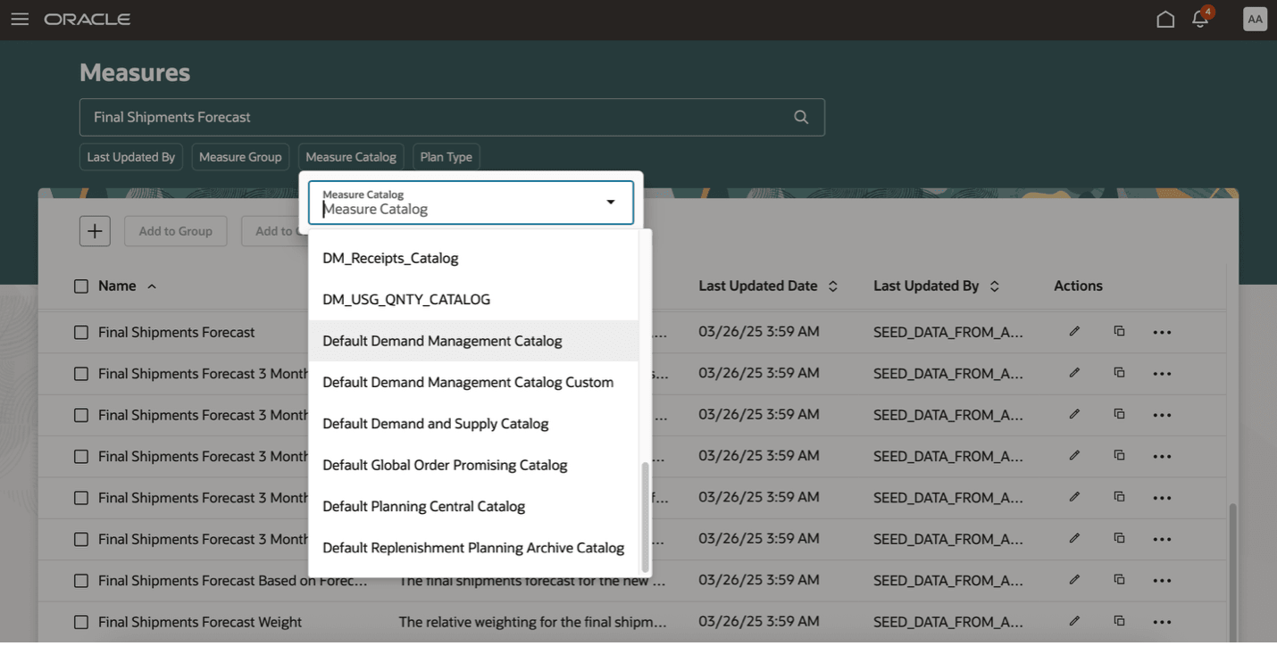

You can also use the suggested filters named Last Updated By, Measure Group, Measure Catalog, and Plan Type. For example, you can search for measures in the Default Demand Management Catalog.
Suggested Filters on Measures Page

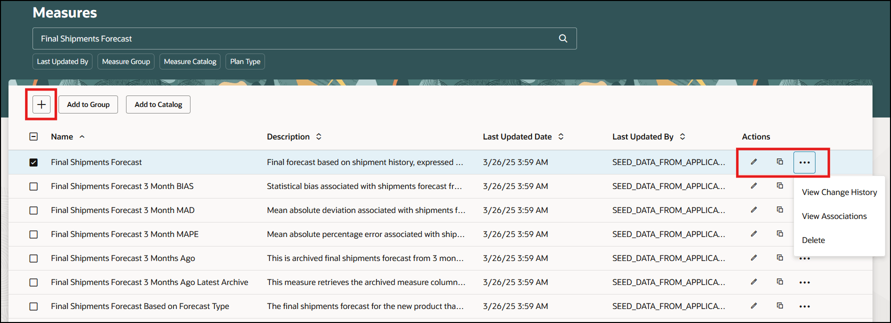

You can click the Add icon to create a measure, Edit icon to edit a measure, and Duplicate icon to duplicate a measure. When you click the Actions icon, you can use actions for viewing the change history and associations or deleting a measure.
Icons on Measures Page
You can create a measure by clicking Add or Duplicate.

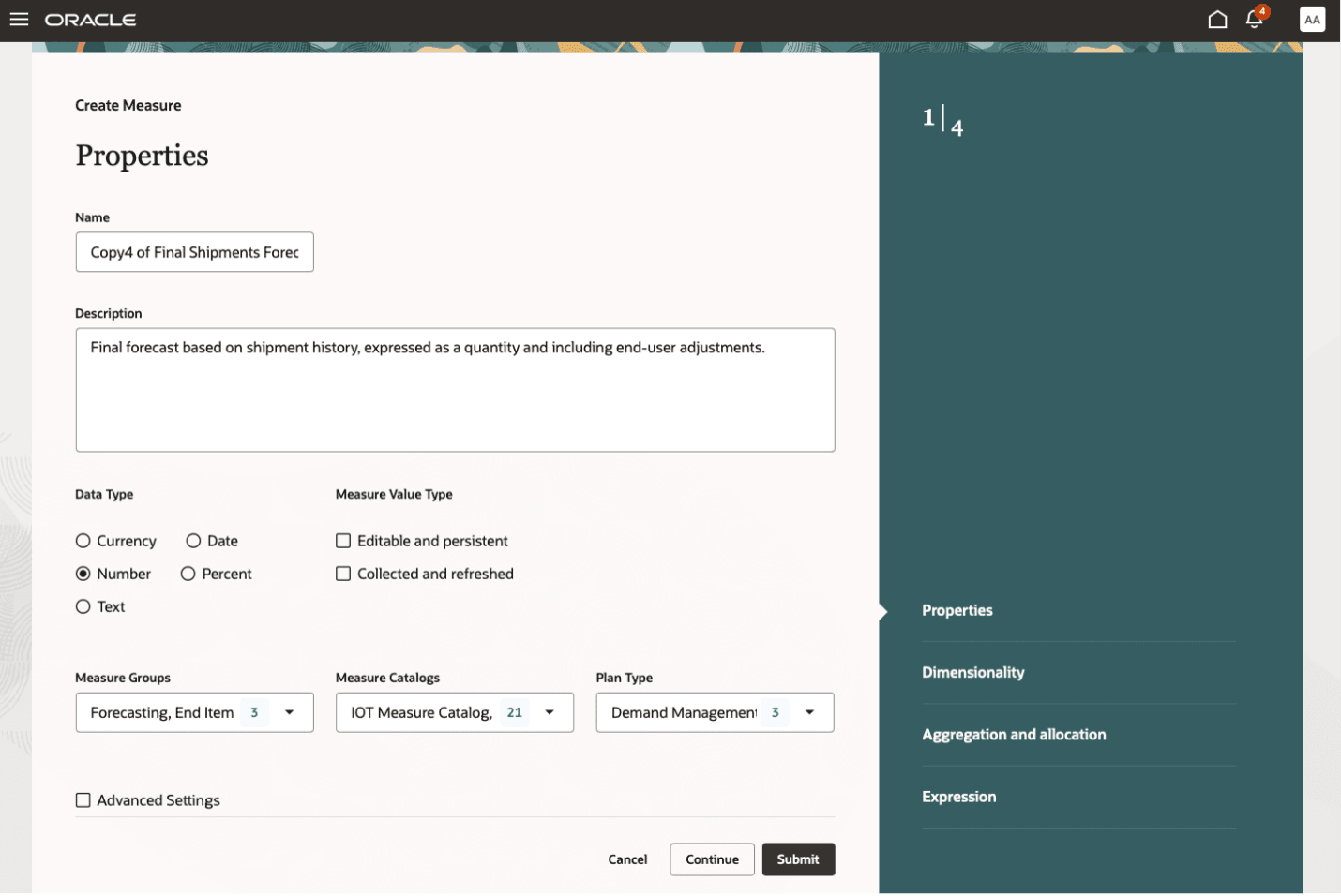

When you click Add, Duplicate, or Edit, a guided process will open on the same tab on which the Measures page is open.
Your privileges will determine if you can only view or also edit any measure’s properties while using the guided process.
By default, the guided process has these steps:
- Properties: Specify basic information about the measure, including the applicable measure groups, measure catalogs, and plan types.

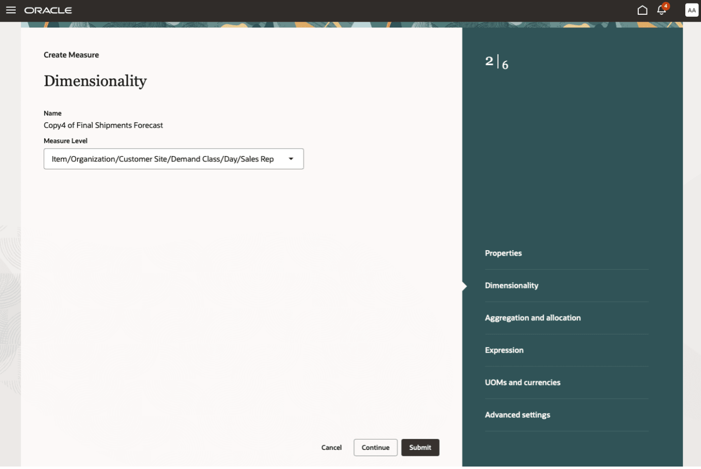

- Dimensionality: Specify the dimensions and stored levels for the measure. Note that you can only select a predefined granularity in the Measure Level field.

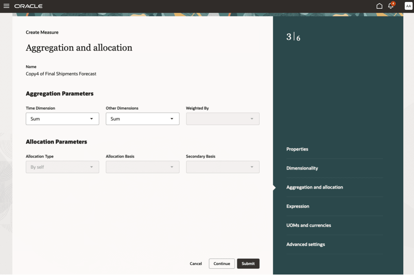

- Aggregation and allocation: Specify how measure values are aggregated and allocated.

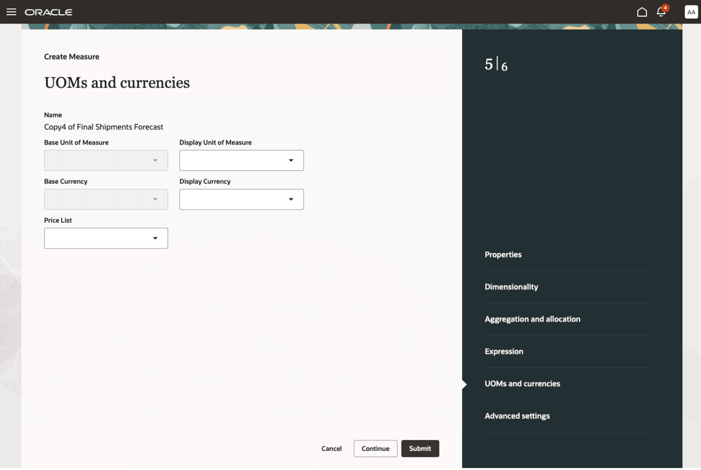

When you select the Advanced Settings checkbox in the Properties step, these additional steps are available:
- UOMs and currencies: Select units of measure (UOMs) and currencies for conversion.

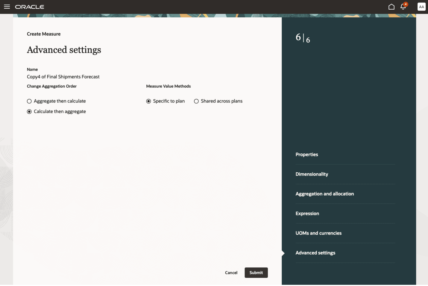

- Advanced settings: Specify the aggregation order and whether the measure is plan-specific or shared.
Properties Step in Guided Process for Measures

UOMs and Currencies Step in Guided Process for Measures
