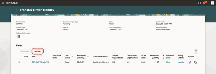

Go to the Inventory Management work area, open your transfer order, then click Add Line:
xxxxxxxxxxxxxxxxxxx

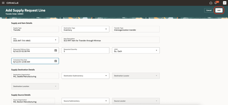

That action opens the Add Supply Request Line page in Supply Chain Orchestration:
xxxxxxxxxxx
The new page sets the destination and source organizations from the transfer order's original line, by default. You can't modify them, but you can search and select the item that you want to add. You can select the Requested Delivery Date, Requested Quantity, Scheduled Ship Date, and then click Add to create a new line on the existing transfer order.

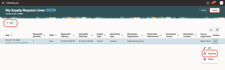

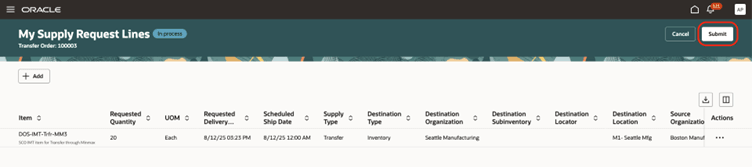

The My Supply Requests Line page in Supply Chain Orchestration displays the new line that you just added. You can click Add on that page to add another line, or click . . . > Duplicate to copy a line from this page:
xxxxxxxxxxx
Click Submit, then Supply Chain Orchestration adds your changes to the transfer order:

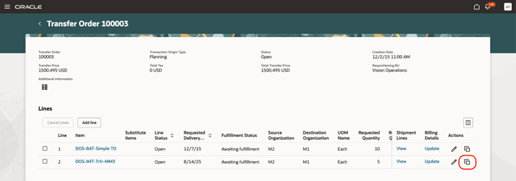

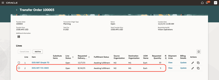

You can also copy a line on the transfer order, then add a new line that has the same item but set a different quantity and requested delivery date:
xxxxxxxxxxxxxxx

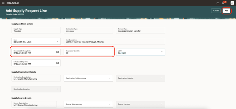

Modify the Quantity and Requested Delivery Date, then click Add:
xxxxxxxxxxx
Click Submit:
xxxxxxxxxxxxx

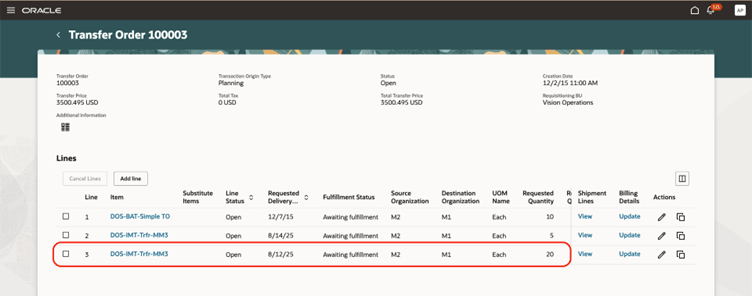

View the new line on the transfer order:
xxxxxxxxxxxx
