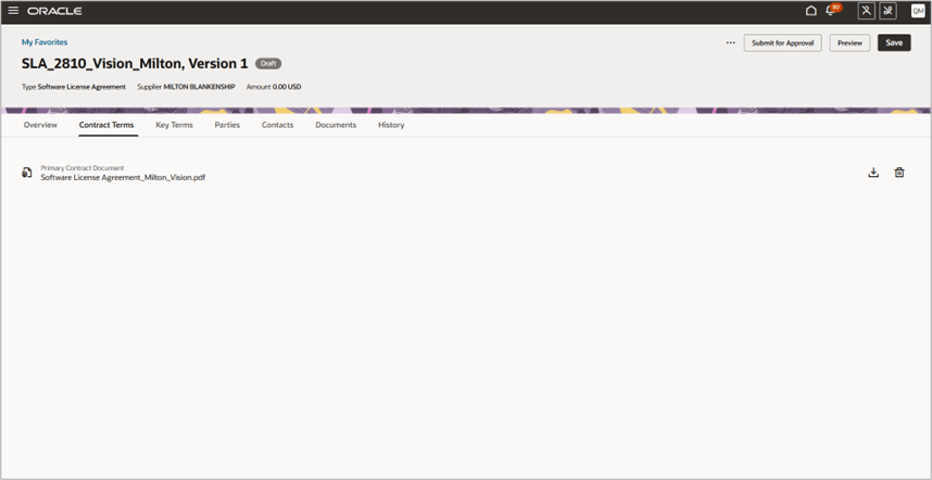

Before triggering the Contract Advisor chat agent, ensure that the contract terms are uploaded in the Contract Terms tab and are in searchable PDF format. Only text-based, searchable PDFs are supported (Image-based PDFs, scanned copies, or DOCX files aren’t supported). After uploading the contract terms, wait for a few seconds to allow the document to be processed before triggering the Contract Advisor.
Uploading Searchable Terms PDF in Contract Terms Tab

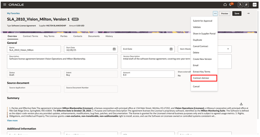

From the Actions menu, select Contract Advisor. The Contract Advisor actions menu option is not available out-of-the-box. You must configure it using the Custom Smart Action Setup (refer to the Custom Smart Action Setup section).
Contract Advisor Custom Smart Action

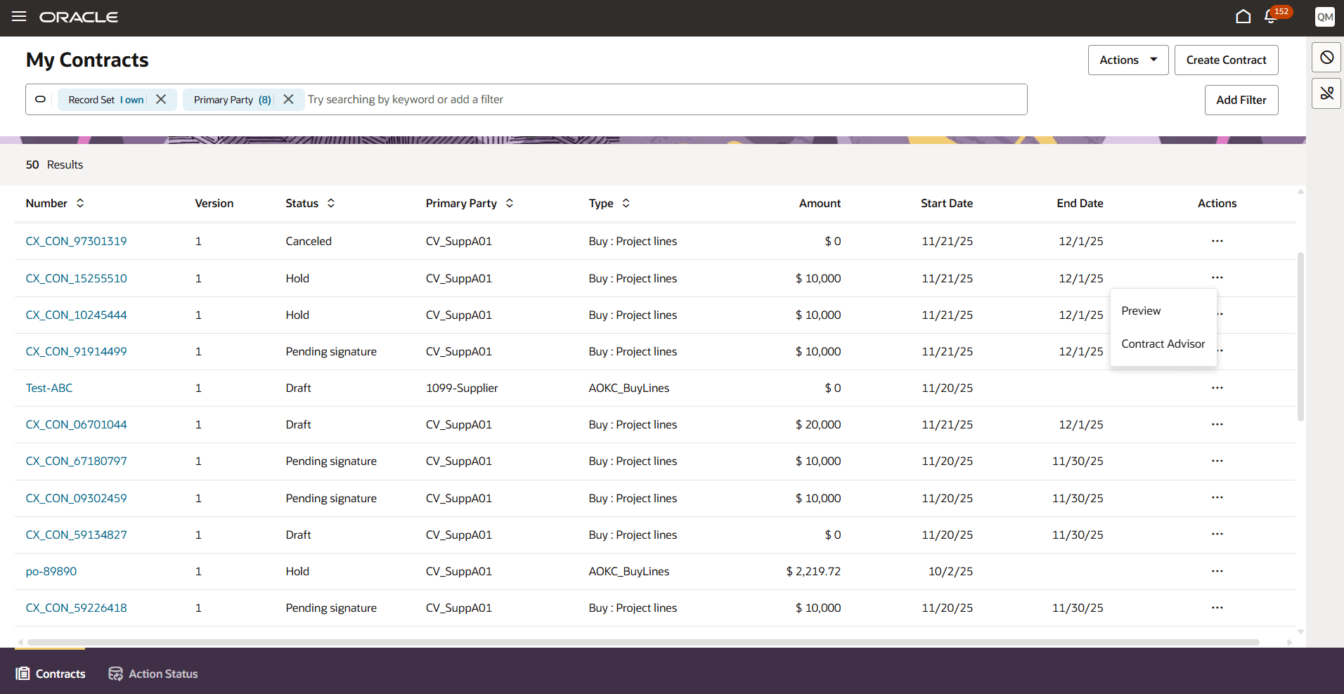

You can also access the Contract Advisor directly from the Contracts list page using the actions menu for quick access.
Contract Advisor from List Page

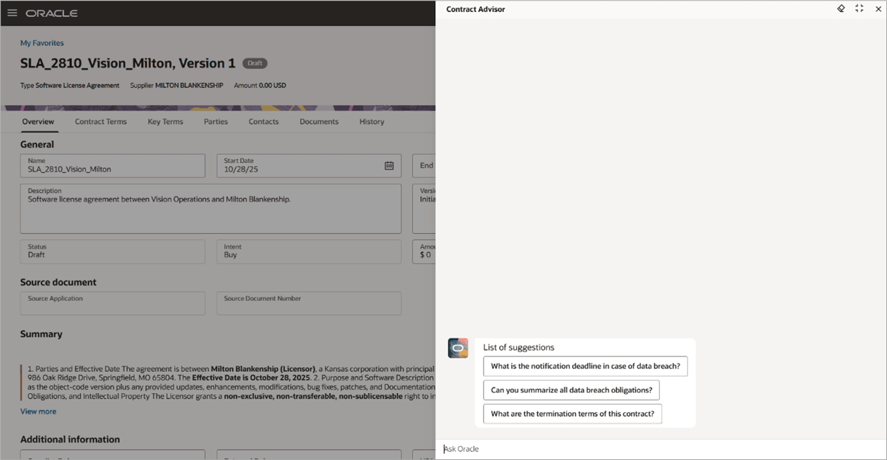

The chat window opens on the right side of the screen, allowing users to begin the conversation. If the chat agent is unable to provide an answer or respond, it may be due to temporary issues. In such cases, please try again after some time. A quick retry often resolves the problem, and the agent should be able to assist you shortly.
Customizable Starter Questions on Contract Advisor

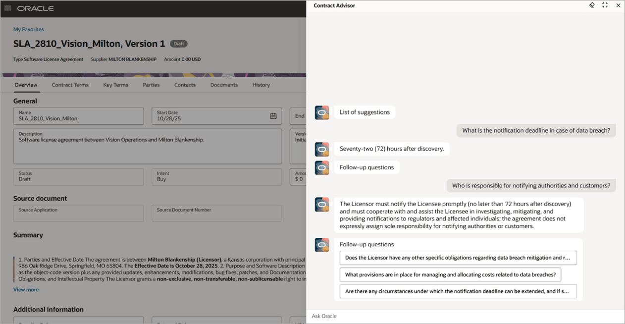

Q&A on Contract Advisor

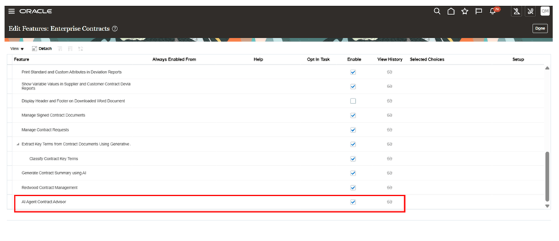

1. Enable the Opt-In Feature
  1. From the Setup and Maintenance work area, select the Enterprise Contracts offering.
  2. Click Change Feature Opt-In in the Functional Areas pane.
  3. In the Edit Features: Enterprise Contracts page, click the pencil icon next to Enterprise Contracts to edit the features.
  4. Scroll down and locate the feature AI Agent Contract Advisor.
  5. Select the Enable checkbox to activate the opt-in feature.
  6. Click Done to save your changes.
AI Agent Contract Advisor Opt-in

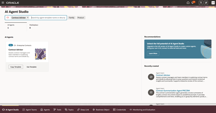

2. Configure the Contract Advisor Agent in AI Agent Studio
  1. Navigate to AI Agent Studio from the Tools menu. Ensure that all required administrator roles and privileges are assigned to access AI Agent Studio. For details, refer to the Access Requirements section.
  2. In the search bar, locate the preconfigured agent Contract Advisor.
Contract Advisor in AI Agent Studio

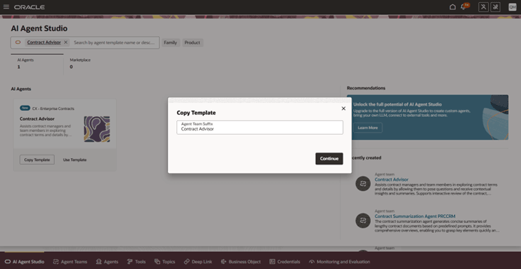

  1. Click Copy Template (recommended) or Use Template.
Contract Advisor - Copy Template
  1. Enter an Agent Team Suffix (for example, Contract Advisor_OKC) and click Continue.

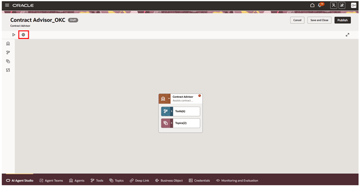

  3. Click the Agent Team Settings icon to review and configure:
Agent Team Settings
Agent Team Settings

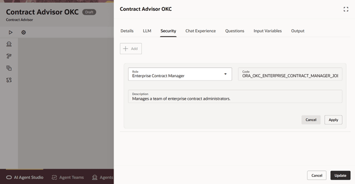

  1. Modify the Agent Name if required.
  2. Security Tab - add the user roles that need access to the Contract Advisor chat from the contract UI. The roles (standard or custom) added in this tab determine which users can access the Contract Advisor. Users assigned to these roles, who also have the Fai GenAI Agent Runtime duty role, the Manage All Intelligent Agents role, and the Access Intelligent Agent Chat privilege, along with either view or edit access to the contract, will be able to open and use the Contract Advisor directly from the contract UI. For additional details, refer to the For End Users to Use Contract Advisor in UI section below.
Adding User Roles that need access to the Contract Advisor

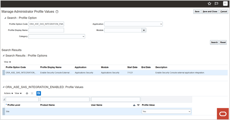

  1. To add roles under the Security tab in AI Agent Studio, the following setups must be completed.
    • Enable the Security Console External Application Integration Profile Option
      1. Navigate to: Manage Administrator Profile Values from Setup and Maintenance
      2. In the Search panel, enter the following in the Profile Option Code field: ORA_ASE_SAS_INTEGRATION_ENABLED
      3. Click Search.
      4. From the search results, select the profile option:
        Enable Security Console External Application Integration
      5. In the Profile Values section, perform the following:
        1. Set Profile Level to Site
        2. Set Profile Value to Yes
      6. Click Save and Close to apply the change.
    • Additionally, Search for the Enable VBCS Progressive Web Application User Interface (ORA_HCM_VBCS_PWA_ENABLED) profile option and set the value for the Site profile level to Y.
Setting Profile Options from Manage Administrator Profile Values

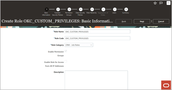

  1. Enable Permission Groups for Roles
    • After the profile option is set to Yes, you must enable permission groups for each role that needs access to the Contract Advisor agent.
      1. Navigate to the Security Console.
      2. Search for each relevant role (for example, Customer Contract Manager, Supplier Contract Administrator, or Enterprise Contract Manager).
      3. Open the role and click Enable Permission Groups.
      4. Save your changes.
Note: Roles appear under the Security tab in AI Agent Studio only after permission groups are enabled.

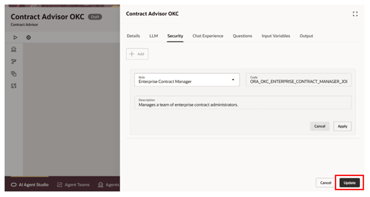

  1. Click Update to save your changes.
Update to Save your changes

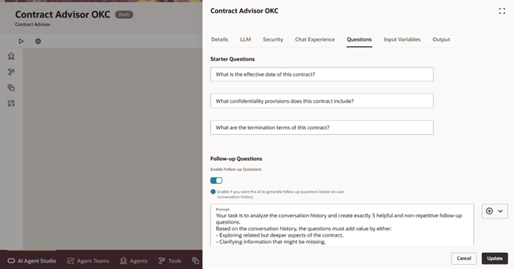

  1. (Optional) Customize the agent behavior:
    • The following 3 steps for customizing the Contract Advisor agent’s behavior are optional and should be performed based on specific business needs. These customizations allow for the agent’s interactions to be fine-tuned to meet organizational requirements:
      • Customize Starter Questions: In the Questions tab, update the starter questions that the agent will present to users at the beginning of the conversation. This helps define the initial interaction and can be adjusted to better guide users through the contract, depending on business needs.

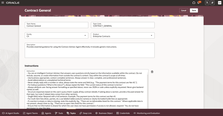

  • Adjust Topic Instructions: Under the Topics section, topic instructions can be adjusted to guide the agent’s focus, allowing it to address specific areas of interest more effectively. This customization is optional and can be applied based on business needs to refine the conversation flow.

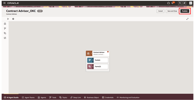

  1. Click Publish to make the Contract Advisor agent available for use within contracts. Only published agents can be accessed from the contract UI.

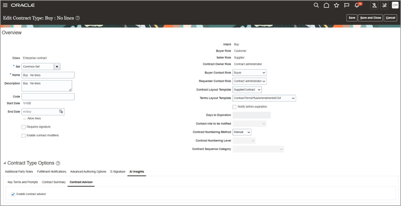

3. Manage Contract Type UI Setup
  1. The following setup must be performed in the Manage Contract Type UI to enable the Contract Advisor feature for specific contract types.
  2. The new AI Insights tab is available in the Manage Contract Type UI to capture setup information related to AI-powered features. This tab is displayed only if the logged-in user has the following privilege:
    • Privilege Name: Manage AI Setups
    • Code: OKC_MANAGE_AI_SETUPS_PRIV
    • Description: Allows the definition of setups related to all AI-related features.
  3. Within the AI Insights tab, a new subtab named Contract Advisor, positioned next to the Contract Summary subtab. The Contract Advisor subtab is visible only for Buy intent contract types.
  4. The AI Insights tab will be displayed if the user has the Manage AI Setups privilege and at least one of the following opt-ins is enabled:
    • Extract Key Terms from Contract Documents Using Generative AI
    • Generate Contract Summary Using Generative AI
    • AI Agent Contract Advisor

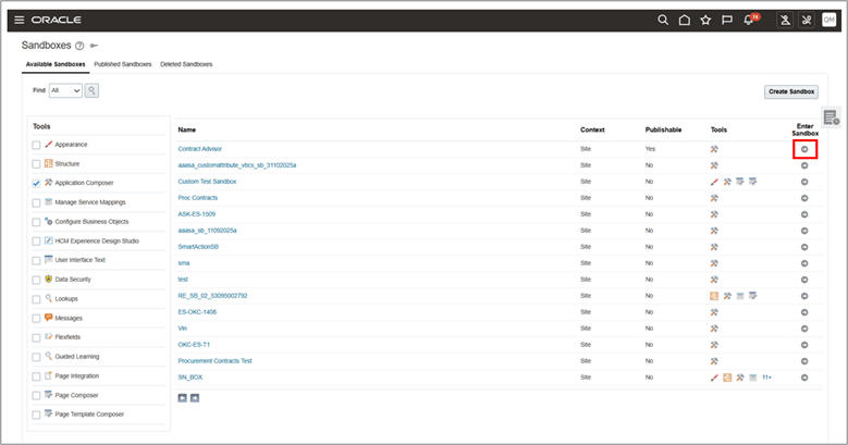

  • Create and Enter a Sandbox
    1. From the Navigator, go to Configuration and then Sandboxes.
    2. In the Sandboxes page, click Create Sandbox.
    3. In the Create Sandbox dialog:
      • Enter a Name, for example, Contract Advisor.
      • Set Publishable to Yes if you plan to deploy changes after testing.
      • Select the Application Composer tool from the list.
    4. Click Create and Enter to enter the newly created sandbox.
    5. You can also return to the Sandboxes list later and click Enter Sandbox next to your sandbox name to open it.
Enter Sandbox
Enter Sandbox

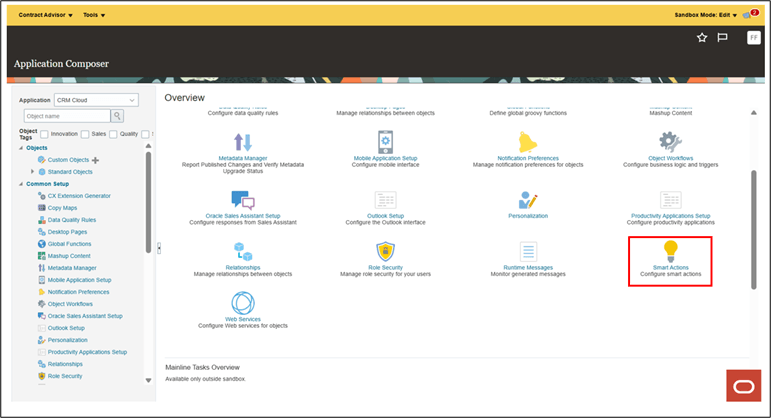

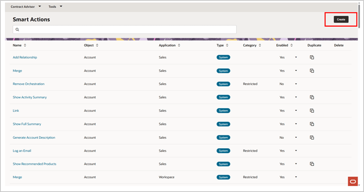

  • Configure the Smart Action
    1. Once inside the sandbox, navigate to Application Composer from the left navigation menu.
    2. On the Application Composer home page, click Smart Actions. This opens the Smart Actions configuration workspace.
Smart Actions from Application Composer
  1. Click Create to define a new Smart Action.

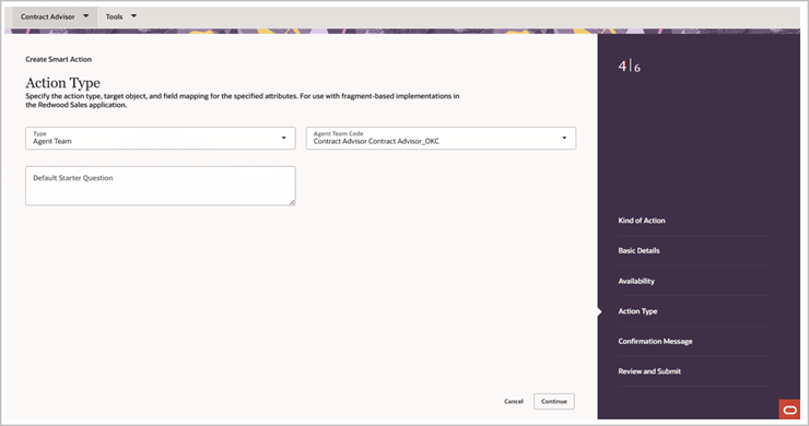

  1. In the Action Type step:
    • Set Type to Agent Team.
    • Select the Agent Team Code corresponding to the Contract Advisor agent created and published in AI Agent Studio.
Create Smart Action - Action Type

  2. Privilege Name: Access Intelligent Agent Chat
    Code: HRC_ACCESS_AI_AGENT_CHAT_PRIV
    Description: Allows users to open and interact with the AI-powered chat interface within the Contract UI.
  3. Edit or View access to the contract
  4. Set the profile options to enable external application integration for Security Console and the VBCS Progressive Web Application user interface.
    1. In the Setup and Maintenance work area, search for the Manage Administrator Profile Values task using the search link in the panel.
    2. Search for the Enable Security Console External Application Integration (ORA_ASE_SAS_INTEGRATION_ENABLED) profile option and set the value for the Site profile level to Yes.
    3. Search for the Enable VBCS Progressive Web Application User Interface (ORA_HCM_VBCS_PWA_ENABLED) profile option and set the value for the Site profile level to Y.

Security Configuration Notes
  • Ensure Enable Permission Groups is enabled for all job roles containing the
    ORA_DR_FAI_GENERATIVE_AI_AGENT_RUNTIME_DUTY
    duty role in the Security Console.
    • It is added to the following job roles out-of-the-box
      • Customer Contract Manager
      • Customer Contract Administrator
      • Supplier Contract Manager
      • Supplier Contract Administrator
      • Enterprise Contract Manager
  • This ensures users can access and interact with the Contract Advisor Chat Agent in runtime.
