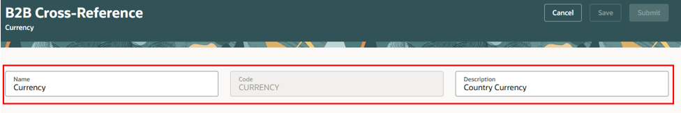

Define B2B Cross-References
- Select B2B Cross-Reference from the Tasks panel tab.
- Click Add to define a new B2B Cross-Reference.
- Enter the details and click Save.
Add a New B2B Cross-Reference

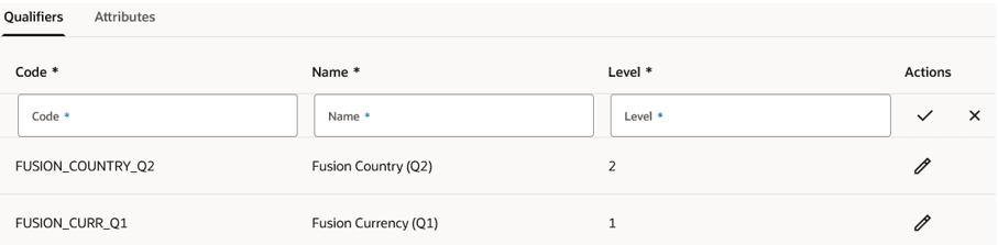

Add B2B Cross-Reference Qualifiers
- Under the Qualifiers tab, enter Code, Name, and Level.
- Under Actions, click Create to add your entries.

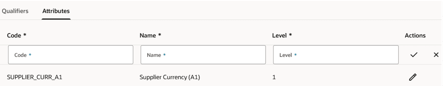

Add B2B Cross-Reference Attributes
- Under the Attributes tab, enter Code, Name, and Level.
- Click Save and Submit after you have added the details.

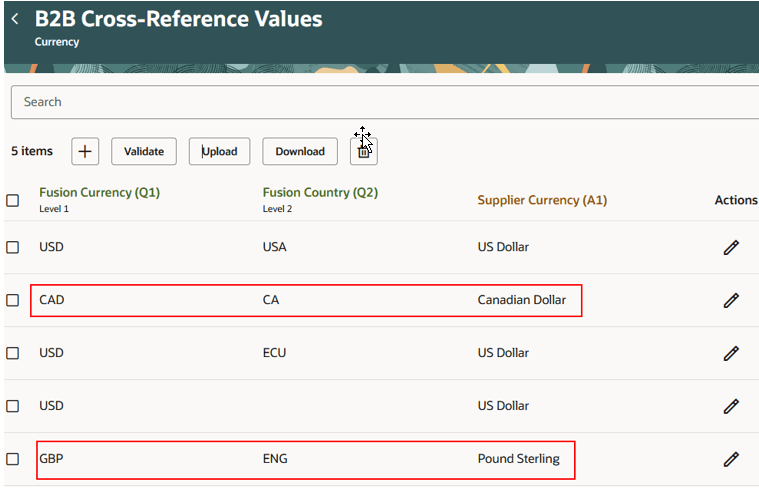

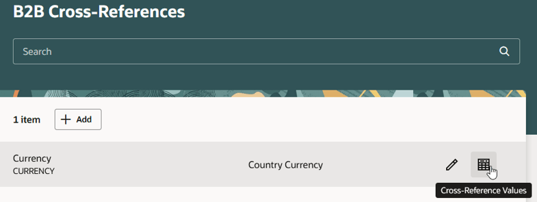

Configure Cross-Reference Values
- On B2B Cross-References page, click Cross-Reference Values.
B2B Cross-References: Cross-Reference Values icon

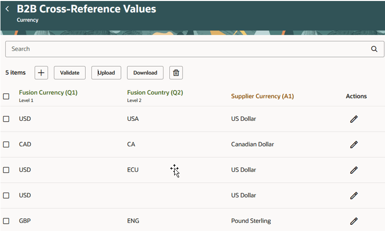

- The qualifiers and attributes created earlier display as column headers.
- Click Add.
B2B Cross-Reference Values

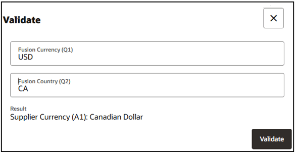

Validate Cross-Reference Values
- On the B2B Cross-Reference Values page, click Validate.
- Enter a value for each of the qualifier fields. If a matching attribute value exists, it will be displayed in the result.
Validate

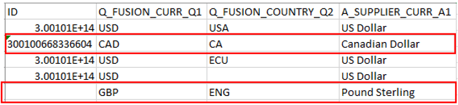

Upload and Download Cross-Reference Values
- Click Download to generate and save .csv on your computer.
- To make changes, open the .csv and modify the intended values. Format the ID cell as Text without changing its value.
- To add new rows, enter the qualifier and attribute values. Leave the ID cell blank.
- Save the .csv.
.csv File With a Change to Existing Row and With a New Row Added
- Click Upload. The values will appear on the page.
Updated B2B Cross-Reference Values

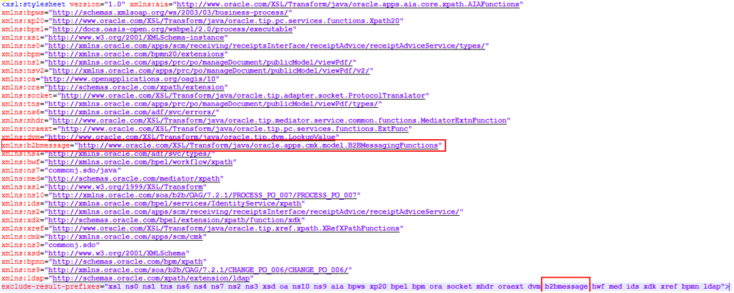

- Make these updates:
- The class below needs to be added to the namespaces area at the top of the XSL:
xmlns:b2bmessage="http://www.oracle.com/XSL/Transform/java/oracle.apps.cmk.model.B2BMessagingFunctions"
- b2bmessage needs to be added to the exclude-result-prefixes:
Stylesheet Declaration Area

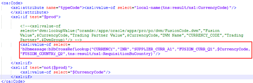

- Look for the dvm:lookupValue that you need to cross-references. For example, CURRENCY_CODE.
- Comment it out.
- Add the b2bCrossRefLookup() function:
<xsl:value-of select="b2bCrossRefLookup('DecisionCode','DefaultValue','AttributeCode','QualifierName1','QualifierValue1','QualifierName2','QualifierValue2',...)"/>
b2bCrossRefLookup() Function

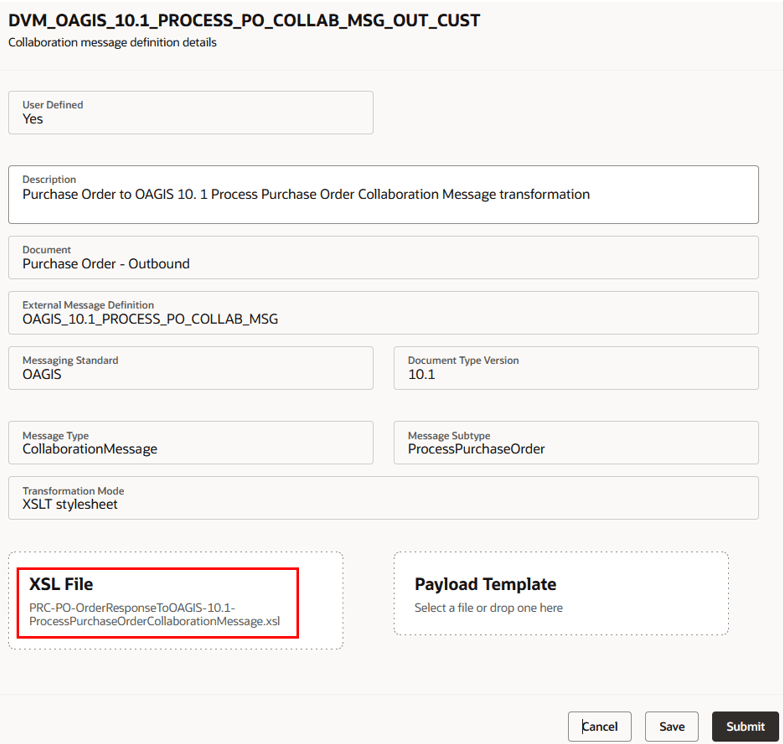

- On the B2B Message Definitions > Collaboration Message Definitions tab, create a duplicate of the message you downloaded the transformation package for. Upload the customized XSL.
- Click Submit after you have added all other details.
Duplicate Message Definition - Upload Custom XSL

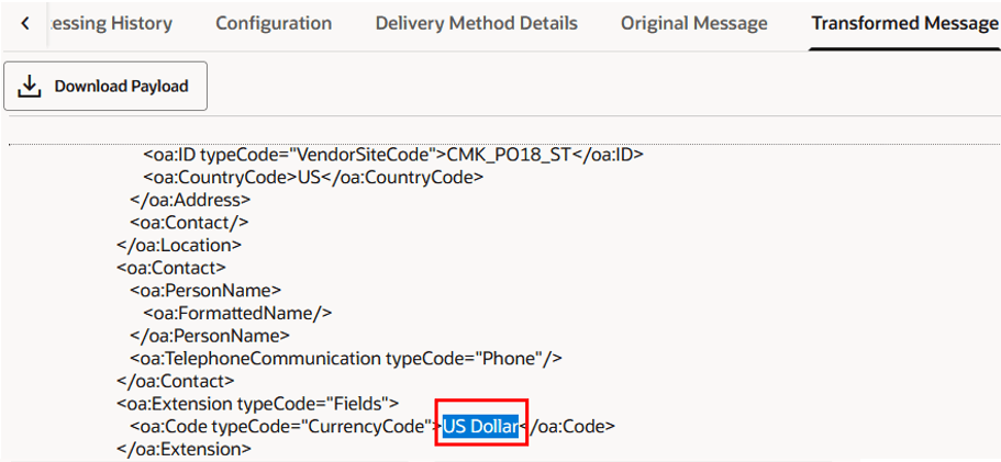

- After the message is processed, the transformed file will show the value of the attribute.
Transformed Message payload

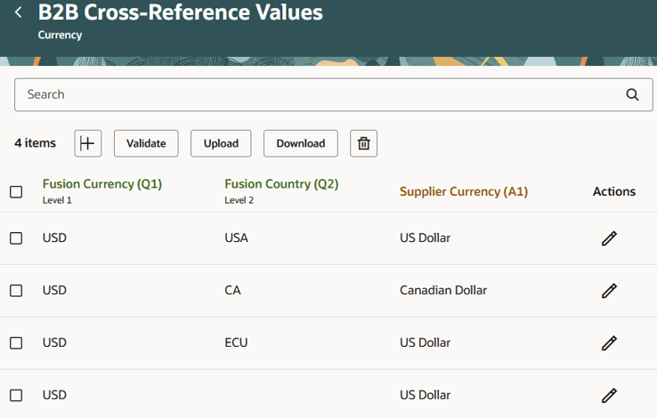

B2B Cross-Reference Values - Structure
The b2bCrossRefLookup() function first looks for a match for FUSION_CURR_Q1=USD and FUSION_COUNTRY_Q2 = US. Since it doesn't find one, it removes the qualifier with the highest level, which is FUSION_COUNTRY_Q2 = US. At this point, it finds a match for FUSION_CURR_Q1=USD which is would be SUPPLIER_CURR_A1= US Dollar.
