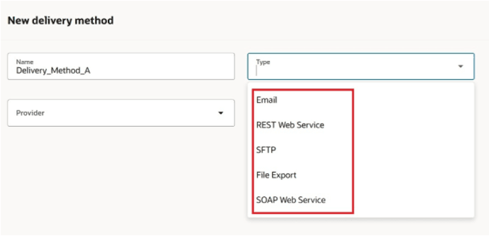

Configure a Delivery Method
  1. Select B2B Connections from the Task Panel.
  2. Select the Delivery Methods tab and add a new delivery method. Enter details for the delivery method.
  3. Delivery methods that are associated with a provider can only be used for that provider when creating connections. You don’t need to create delivery methods for B2B Adapter or Business Event. When you’re creating connections, you can select one of the values below for these delivery method types:
    1. ORA_B2BAdapter
    2. ORA_BusinessEvent
  4. Click Save.
Add a New Delivery Method

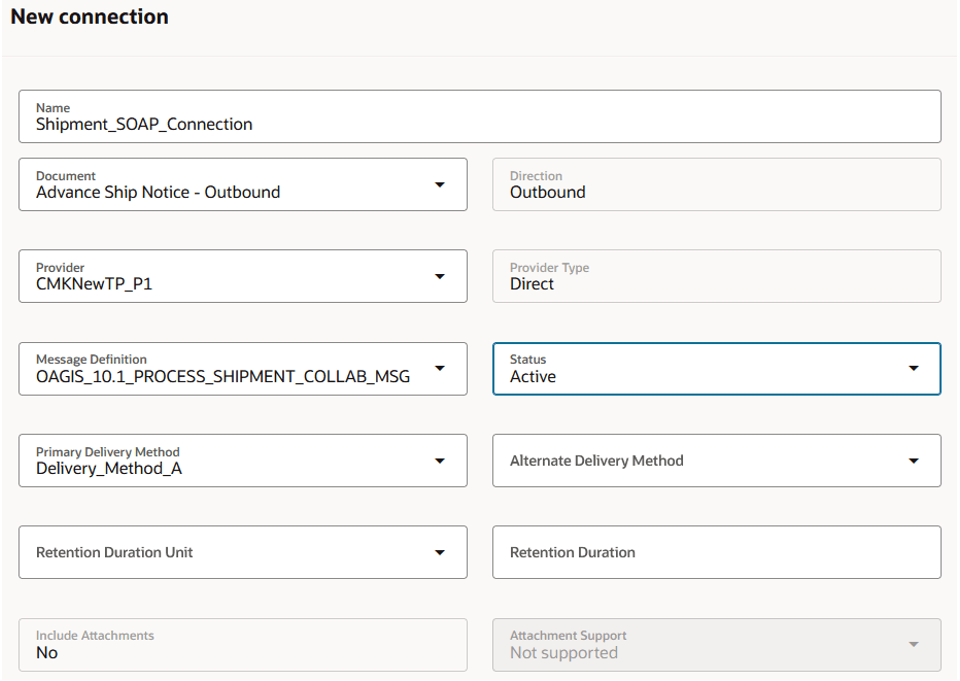

Create a Connection for Each of the Documents You Exchange
  2. Select the Connections tab.
  3. Click Add to add a new connection and enter the details. Set the status to Active and click Submit.
  4. Repeat this process to create connections for all your order-to-cash documents.
Add a Connection
Add a Connection

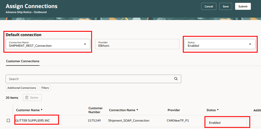

  1. On the B2B Documents page, select the outbound document you are configuring and click Assign Connections.
  2. On the Assign Connections page, select a default connection for the document and enable it. You can also assign a customer connection.
Default and Customer Connection
  1. You can’t assign connections to inbound documents, but you must have active connections for each of your inbound documents.

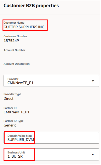

Set Up B2B Partner Properties
You can define B2B properties for the following use cases:
  • Associate the BU for the inbound orders.
  • Associate domain value maps to your customers.
  • When you're using a service provider and you haven’t configured the document property to get partner identification from payload, you'll need to add B2B properties to define partner information.
Here’s how you add B2B properties:
  1. Select B2B Partners from the Task Panel.
  2. Click Add on the Customer B2B Properties tab.
  3. Enter the customer details on the Add customer B2B properties drawer. Note that the customer account is not needed.
  4. Click Save.
Add Customer B2B Properties
