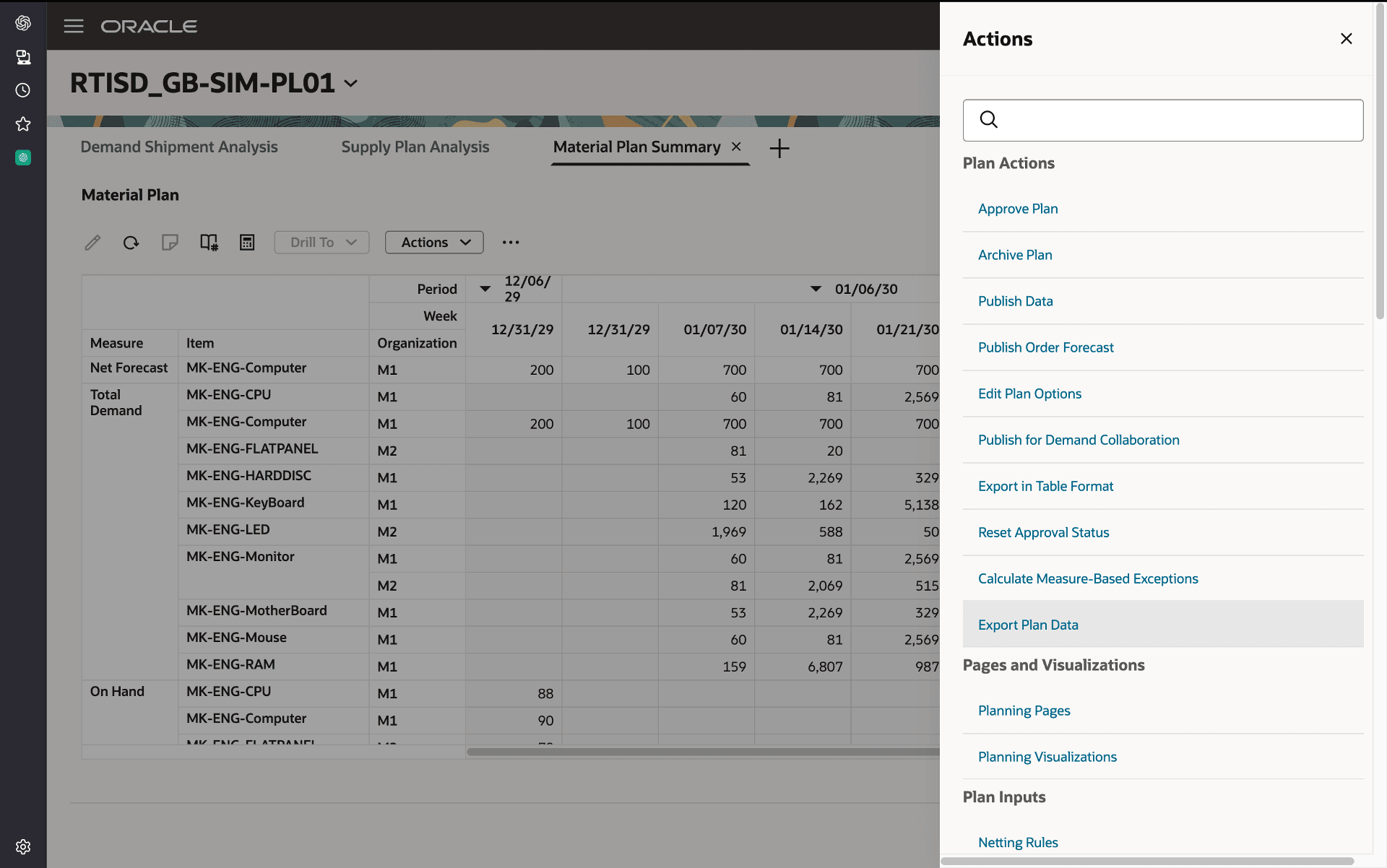

Using the Export Plan Data feature
  1. Open the plan and select the More Options icon.
  2. From the menu, select View More.
  3. From the Actions menu, select Export Plan Data.
Actions Menu
Actions Menu

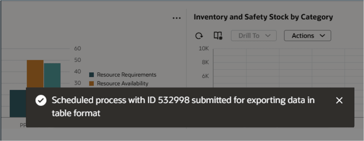

This action triggers the Export plan data scheduled process. This is confirmed by a message.
Confirmation Message

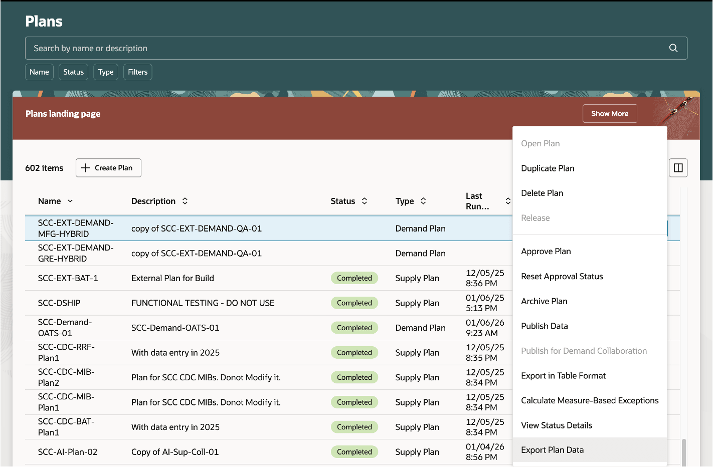

You can also export the plan data from the Manage Plans page:
On your plan’s page, click the More Actions icon. A page with all the plans opens.
  1. Find and select the specific plan you want to export the data from.
  1. Click the Actions icon for that plan.
  1. Select Export in Table Format.
  1. In the drawer, select the specific measure catalog to be used and the file type (CSV or XLS).
  1. Select Export.
A scheduled process runs, and a confirmation message with a Process ID is displayed.
After the process is completed, check the Scheduled Processes work area. You can find the file in Tools > File Import and Export.
Exporting Plan Data from Manage Plans
