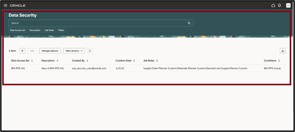

To open the page, select Administer Planning Security from the UI Shell. The Data Security page will then be displayed.
Data Security
Data Security Toolbar
The Data Security toolbar provides the following actions:
  1. Add - Create a new Data Access Set.
  2. Edit - Modify attributes of an existing Data Access Set.

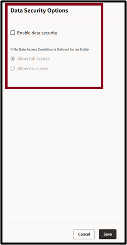

  3. Manage Options - Enable Data Security at a global level for entities where a Data Access Set is not defined.
Data Security GOlbal parameter

  3. Export - Export records to a spreadsheet. Only the columns in the current view are exported, in the same order as displayed.

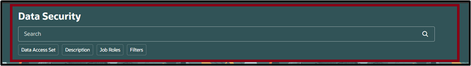

Searching and Filtering Data Security
You can search for Data Access Set using the search bar and the suggested filters.
Data Security Search
Keyword search bar: Search across multiple columns by entering text in the keyword search field. For Data Access Sets, the search specifically applies to the Data Access Set and Description columns, using the contains operator. For example, type DAS and press Enter or click the search icon. The table displays all Data Access Set names containing DAS, such as DAS1.
Note: Keyword search isn’t case sensitive.
Suggested filters: Filter Data Access Sets using the column-specific filter suggestions. For example, select a Job Role or Data Access Set from the suggested filters, then press Enter or click outside the filter. The table updates to show only the rows that match your selection.

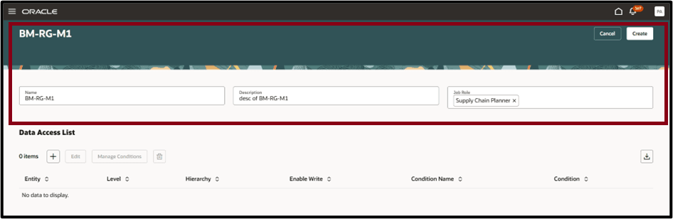

The following screenshot appears on creating the Name and Description of the data access set and assigning to specific roles.
Data Security DAS

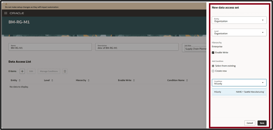

After creating the data access set and assigning it to the appropriate role, configure conditions for the selected entity:
  • Define the Level and Hierarchy for the condition.
  • Grant Read or Write access by enabling or disabling the Enable Write flag.
  • Select between using an existing condition or creating a new condition using the available toggle options.
Data Security DAS Drawer

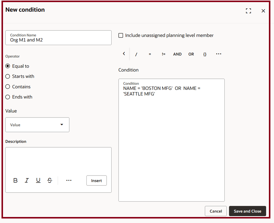

In the New Condition drawer, follow these steps to define a condition for a data access set:
  1. Enter a Condition Name.
  2. Define the condition using the Advanced Create Expression option.
    For example, an Org M2 condition can be created where data security is applied only when the Organization equals BOSTON MFG or SEATTLE MFG.
