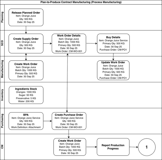

Forward Flow:
  • Supply Planning will release planned order for a Primary Product to Supply Chain Orchestration (SCO).
  • Supply Planning will also send the work definition id/name for the primary product. Planning will also send the work method used in the work definition as part of the supply request
  • SCO receives the supply request from supply planning for the Primary Product
  • SCO will identify this supply request as a contract manufacturing request based on the item attribute of the primary product
  • SCO will also identify that this supply request needs to be fulfilled using process manufacturing based on the work method code sent by supply planning
  • SCO will create a supply order, supply order line, supply tracking line for the primary product with the requested Qty and requested need by date, and assigns the Plan-to-Produce Contract Manufacturing orchestration process and initiates the execution process for fulfilling the demand
  • SCO will send a work order create request for Primary Product to MFG with Requested Qty mapped to Primary Product Quantity in the create request
  • MFG will calculate the Batch Qty based on the primary product qty passed as per the scaling logic that exists within MFG and will create a process Mfg work order
  • Once the process work order is created, SCO will capture the work order details in SCO. SCO will also capture the work order batch size and store it in SCO
  • SCO will then, send a purchase requisition create request to PRC for Primary Product Service item with primary product Qty as the requested Qty. SCO will also, send the CM Work Order Details along with the purchase requisition create request
  • PRC will create a purchase requisition and will stamp the CM work order details. Once the PR is created, based on the BPA setup for the Primary Product Service item, PRC will auto create the PO and the CM work order details are stamped on the CM PO as well
  • The PO is sent to the contract manufacturer. The work definition Pdf or json file will go as an attachment to the PO.
  • SCO will capture the PR/PO details in SCO and will start tracking the PO
  • SCO will then send an Update request to MFG to update the CM Work Order with the CM Purchase Order Details

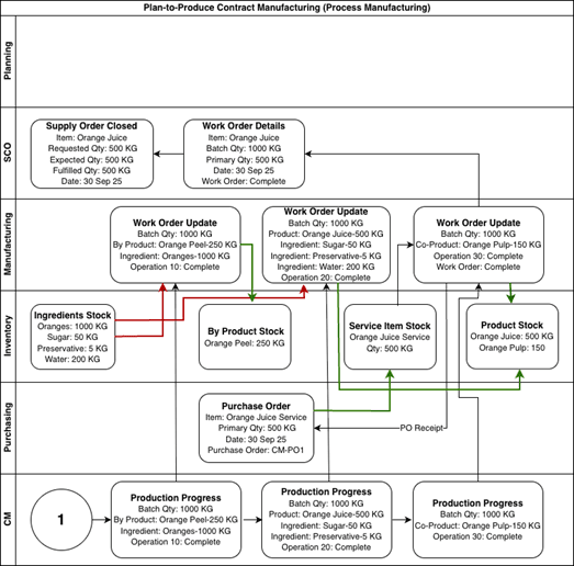

Production Progress Reporting:
  • Contract Manufacturer will be reporting the production progress for every count point operation
  • Contract Manufacturer can report production progress per below options:
    • Via email or phone (In this case production supervisor will manually update the process work order)
    • MFG REST services.
  • The contract manufacturer will report the following details at a minimum with each production progress reporting:
    • CM WO number
    • Primary Product number & Quantity
    • Co-Product or By-Product number & Quantity if any
    • Operation Sequence
    • Operation Status
    • Ingredient / Material number & Quantity if any
  • As and when the CM reports production progress, the process work order will be progressed as per the reported production progress. If there are any outputs reported like the primary product, co-product or a by-product, they will be recorded in the work order and the inventory for the same will be reflecting in the CM Org. This inventory will be owned by the OEM. Any material consumptions reported by the CM will consume the materials stocked in the CM Org which are owned by the OEM. Thus, accounting for the material and product stocks stored in the CM facility that are owned by the OEM.
  • When the CM reports the completions at the last operation, MFG will first invoke the receipt of the service item:
    • MFG will read the primary product Qty completed so far from the work order details and will receive the CM service item Qty equal to the primary product Qty
    • In cases where the primary product Qty is completed in a prior operation to the last operation and the CM reports partial batch Qty completion, MFG will use the scaling logic to determine the primary product quantity based on the batch quantity completed in the last operation. MFG will receive the CM service item Qty equal to the deduced primary product Qty
  •  The CM service item is received into the CM org. Then, MFG will complete the last operation for the same quantity. Once the last operation is completed, the CM service item will be automatically issued to the work order as the CM service item will be set to backflush.
  • SCO will be tracking all completions at the last operation of the CM work order. SCO will record the completed quantities of the primary product and mark those quantities as fulfilled.
  • SCO will also manage all the changes, be it from demand side or supply side and will always keep the CM work order in sync with the CM purchase order.
  • The CM work order will be created in Released status and all the updates on CM work order will be disabled except for the ability to close the work order. The work order will be progressed only through work execution.
