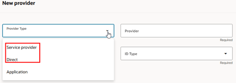

Define Your Providers
  1. Select Connections from the in-app navigation bar.
  2. Select the Providers tab to add a new provider.
    1. Select Direct or Service Provider as the Provider Type and add the remaining details.
  3. Click Save.
Add a Provider
Add a Provider

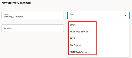

Configure Your Delivery Method
  2. Select the Delivery Methods tab and add a new delivery method. Enter the required details.
  3. Delivery methods that are associated with a provider can only be used for that provider when creating connections. You don’t need to create delivery methods for B2B Adapter or Business Event. When you’re creating connections, you can select one of the values below for these delivery method types:
    1. ORA_B2BAdapter
    2. ORA_BusinessEvent
  4. Click Save.
Add a New Delivery Method

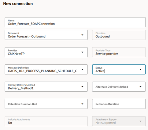

Create a Connection for Each of the Documents You Exchange
  2. Select the Connections tab.
  3. Click Add to add a new connection and enter the details. Set the status to Active and click Submit.
  4. Repeat this process to create connections for all your outbound documents.
Add a Connection
Add a Connection

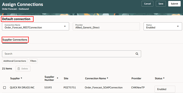

  1. On the B2B Documents page, select the Order Forecast - Outbound document and click Assign Connections.
  2. On the Assign Connections page, select a default connection for the document and enable it.
  3. You can also assign a supplier connection.
  4. Click Submit.
Default and Supplier Connection

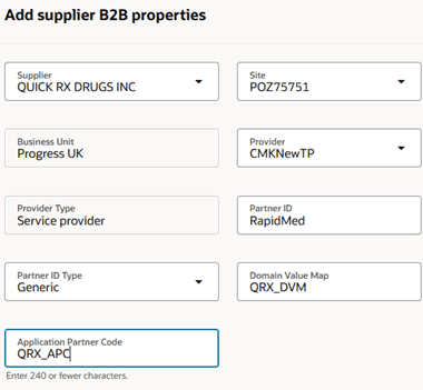

Here’s how you add Supplier B2B properties:
  1. Select Partners from the in-app navigation bar.
  2. On the Supplier B2B Properties tab, click Add.
  3. Enter the details in the Add supplier B2B properties drawer.
  4. Click Save.
Add Supplier B2B Properties

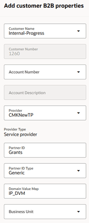

Here’s how you add Customer B2B properties:
  2. On the Customer B2B Properties tab, click Add.
  3. Enter the details in the Add customer B2B properties drawer.
  4. Click Save.
Add Customer B2B Properties
