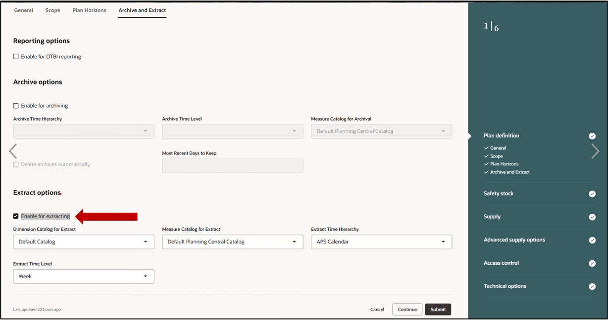

To enable this option,
  1. Open the plan and select the More Options icon.
  2. From the menu, select View More.
  3. From the Actions menu, select Edit Plan Options.
  4. On the Plan Definition page, under the Archive and Extract tab, select the option, Enable for extracting.
  5. Select the measure catalog you need for extraction.
Note: The measure catalog must be either the same measure catalog associated with the plan or a measure catalog that contains only a subset of the measures found within the plan.
  1. Select Submit
Enabling the option
Enabling the option

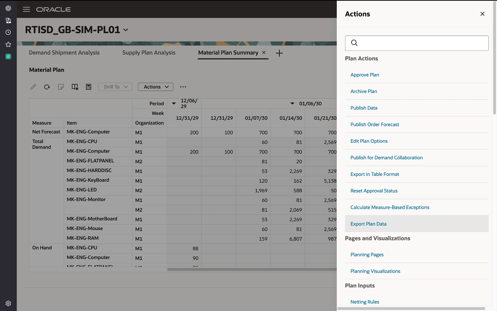

Using the Export Plan Data feature
  1. Op en the plan and select the More Options icon.
  3. From the Actions menu, select Export Plan Data
Actions Menu
Actions Menu

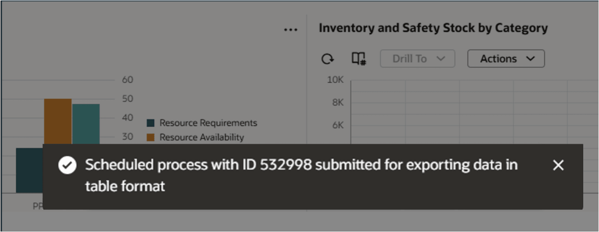

  • This action triggers the Export plan data scheduled process. This is confirmed by a message.
Confirmation Message

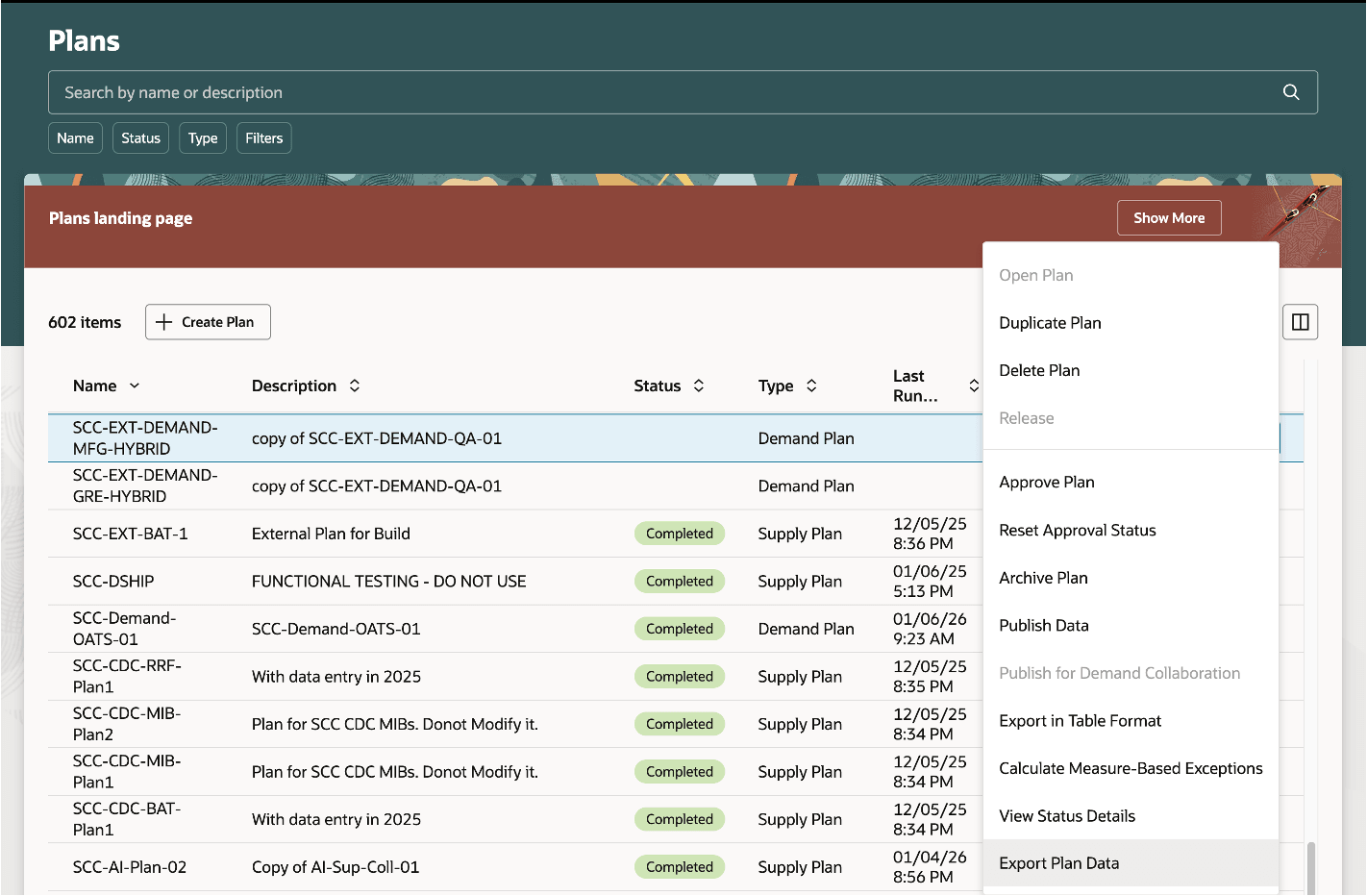

You can also export the plan data from the Manage Plans page:
On your plan’s page, click the More Actions icon. A page with all the plans opens.
  1. Find and select the specific plan you want to export the data from.
  2. Click the Actions icon for that plan.
  3. Select Export in Table Format.
  4. In the drawer, select the specific measure catalog to be used and the file type (CSV or XLS).
  5. Select Export.
A scheduled process will run, and a confirmation message with a Process ID will be displayed.
After the process is completed, check the Scheduled Processes work area. You can find the file in Tools > File Import and Export.
Exporting Plan Data from Manage Plans
