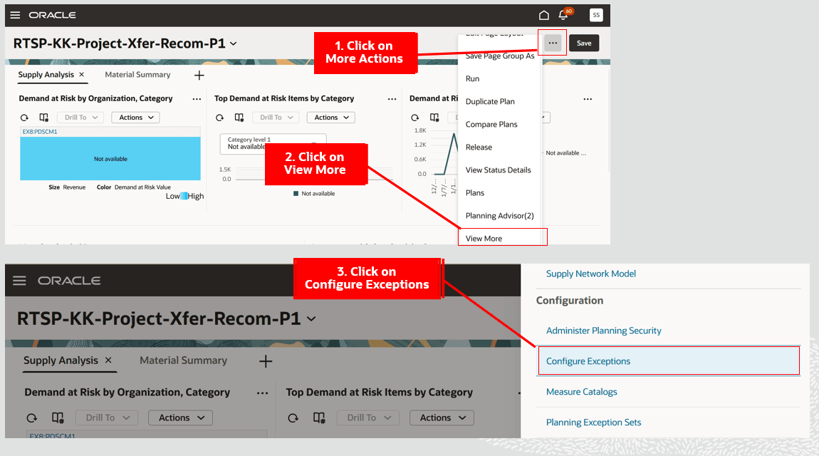

The Configure Exceptions page can be accessed from Plan Inputs, supply plans, demand and supply plans, replenishment plans, and sales and operations plans in the Redwood Supply Chain Planning work area.
To access the Configure Exceptions page:
  1. Click the More Actions (...) icon.
  2. Click View More.
  3. Click Configure Exceptions in the Configuration section.
The Configure Exceptions page opens in a new browser tab.

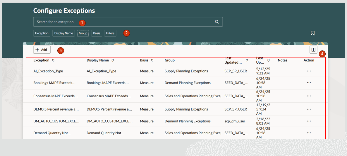

The Configure Exceptions page contains the following:
  1. Keyword search - Lets you search across the Configure Exceptions page. You can search by exception name. The search is case insensitive and performs a search using the contains operator.
  2. Suggested filters - Filters the Configure Exceptions page by Exception, Display Name, Group, Basis, Last Updated By, Last Updated Date, Creation Date, and Created By.
  3. Action toolbar - Lets you create and manage columns.
  4. Exceptions table - Displays the exceptions that have been created or predefined. You can enter Notes for an exception. You can also select an exception to edit, delete, or copy from the Action column.

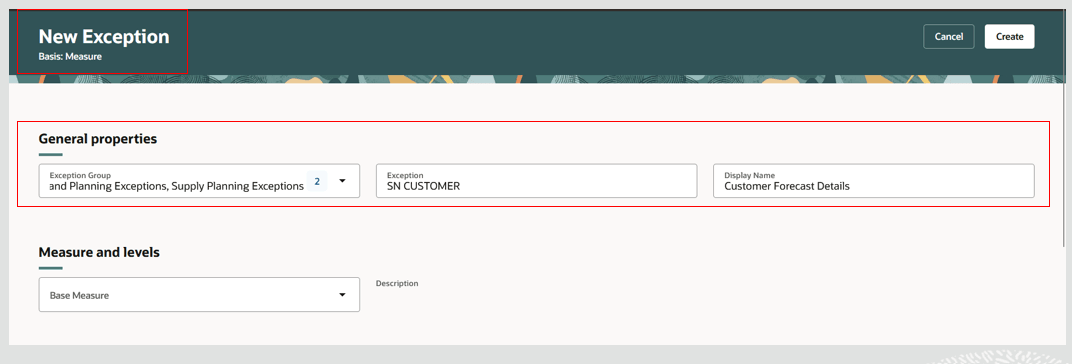

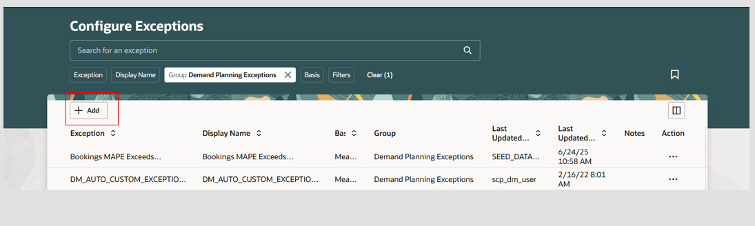

To create an exception:
  1. Click the Add (+) button on the Configure Exceptions page.
Create an Exception
Create an Exception
The New Exception page opens on the Configure Exceptions page in the same tab.
  1. In the General properties section, select one or more applicable exception groups and then enter an exception name and display name.
Enter General Properties for an Exception

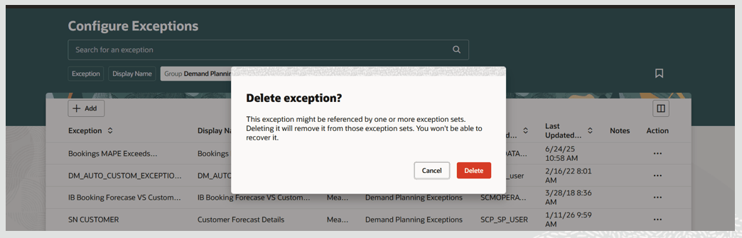

Delete Exception
You can delete only user-defined measure-based exceptions.

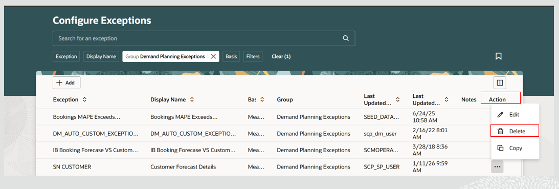

To delete an exception:
  1. In the exception row, click the Action (…) icon and select Delete.
Select the Delete Action
  1. A message is displayed, warning that the exception might be referenced by one or more exception sets and asking you to confirm the deletion of the exception.
Confirmation to Delete an Exception
  1. Click Delete to confirm. The exception is now deleted.

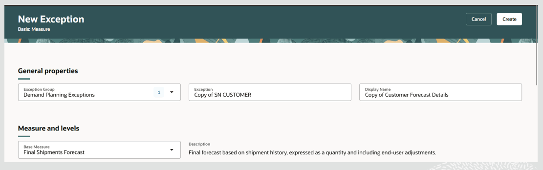

To copy an exception:
  1. In the exception row, click the Action (…) icon and select Copy.
  2. The page refreshes and shows a New Exception page. The exception name and exception display name default to the source names with “Copy of” added at the beginning.
Copy Exception
Copy Exception
  1. Update the exception name and exception display name and other details on the page as desired.
  2. Click Create.
The copied exception is now displayed in the table on the Configure Exceptions page.

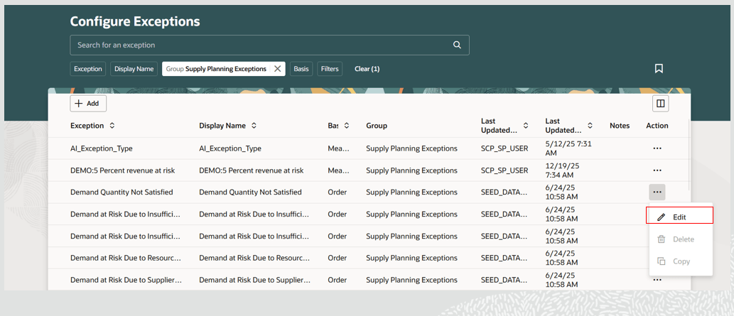

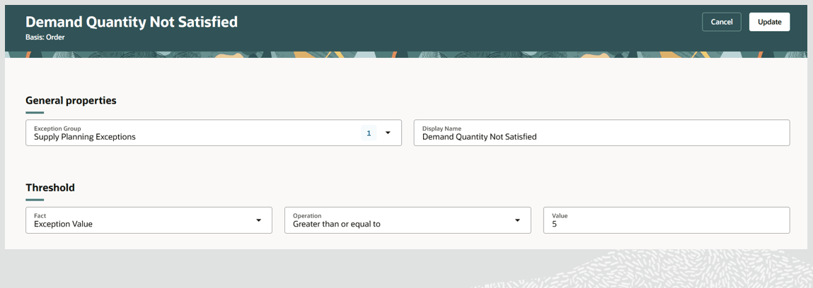

To edit an order-based exception:
  1. In the exception row, click the Action (…) icon and select Edit.
Select the Edit Action for an Order-Based Exception
  1. Exception details are displayed. For order-based exceptions, you can edit only the exception threshold.
  2. Select the applicable fact for the exception (valid choices are Exception Value or Exception Quantity or Exception Days), an operation, and provide a value for the threshold.
Provide Threshold Details for an Order-Based Exception

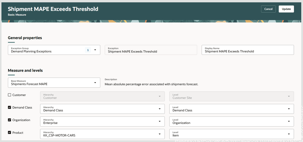

To edit a measure-based exception
  1. In the exception row, click the Actions (…) icon and select Edit.
  2. Edit the exception details as applicable.
    1. For predefined measure-based exceptions, you can edit measure levels, threshold, and notifications. But the base measure field can’t be edited.
    2. For user-defined measure-based exceptions, you can edit measure and measure levels, the threshold and threshold type, and notifications.
Edit Details for a Measure-Based Exception
  1. Click Update.

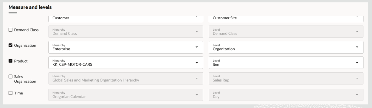

Measure and Levels Section
  • Select a base measure that’s relevant for the exception.
  • Based on the measure granularity, the associated dimensions, default hierarchies, and lowest hierarchy levels are displayed. You must select at least one dimension, a hierarchy, and its associated level.
  • You can change the hierarchy for a dimension and its associated level.

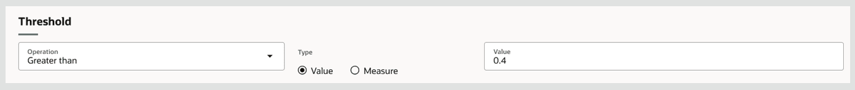

  • If the threshold type is Value, provide a numerical threshold to be compared to the base measure value during exception computation.
Threshold Type as Value

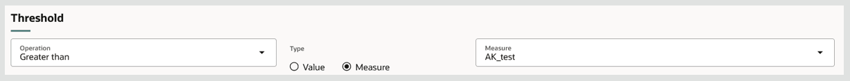

  • If the threshold type is Measure, select a measure whose value will be used as a threshold for comparison with the base measure value during exception computation.
Threshold Type as Measure

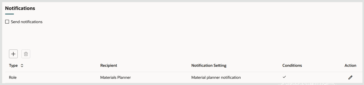

Notification Section
The Notification section allows to you to send notifications to individual users or to roles when exceptions occur.

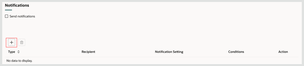

To create exception notifications and enable notifications to be sent:
  1. Click the Add (+) button in the Notifications section.
Create Notification Setup

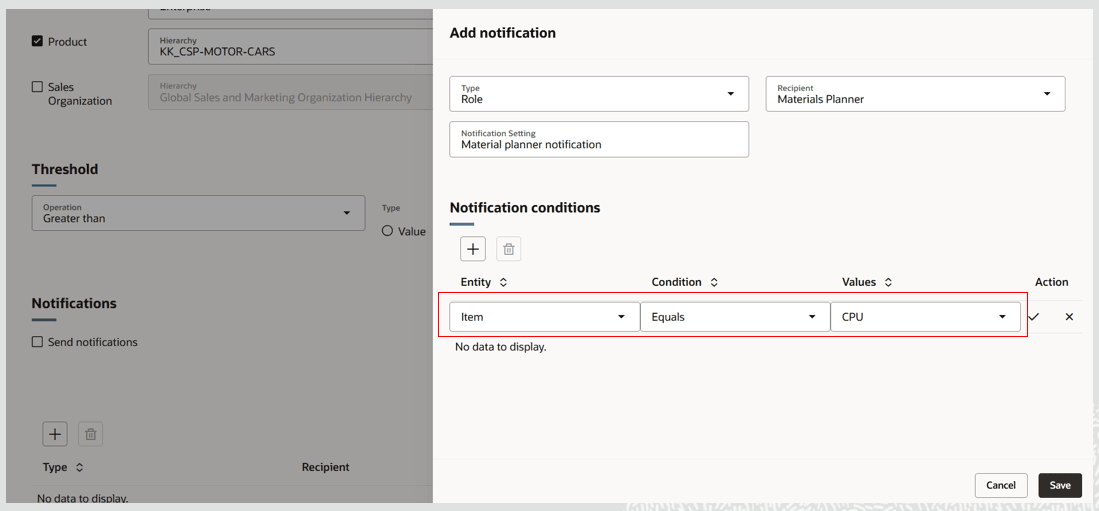

  1. The Add notification drawer opens. Select a Type for the notification. The Type can be Role or User.
  2. Select a Recipient based on the Type selected. If the Type is Role, select a role name as the Recipient. If the type is User, then select a user name as the Recipient.
  3. Enter a name for this notification in the Notification Setting field.
Enter Notification Details
  1. Optionally, you can also enter notification conditions, which specify what conditions need to be met for notifications to be sent.
    1. Click Add (+) in the Notification conditions section.
    2. Select options from the Entity, Condition, and Values fields (for example, Item equals a particular item).
    3. Click on the check mark to confirm the entered details.
Enter Notification Conditions
  1. Click Save.
  2. The drawer closes and the notification details and condition are created.
Notification Details Saved

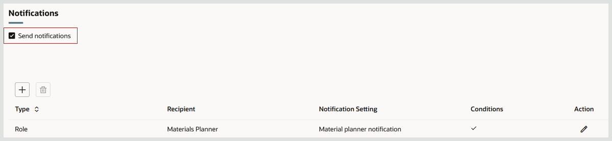

  1. Select the Send notifications checkbox in the Notifications section to enable the notifications listed in this section to be sent when the criteria are met.
Click send notification
Select Send Notifications Checkbox
  1. Click Create (or Update, if you’re updating an existing exception) on the Exceptions page to save the changes.
You can enter only one recipient for a notification. However, you can have multiple notifications if you need to cover different recipients and types.
