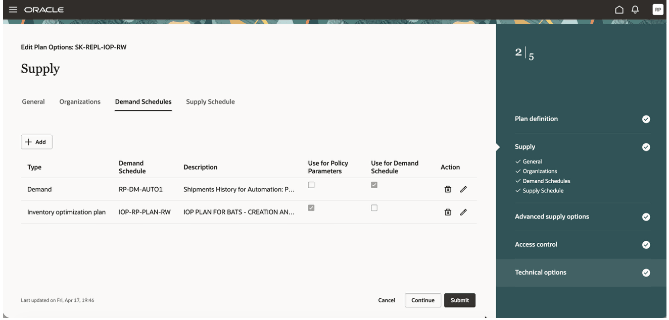

Add Demand Schedule to a Replenishment Plan
You must add an inventory optimization plan as a demand schedule to use its safety stock targets for planning supply and inventory in a replenishment plan.
To add a demand schedule to a replenishment plan:
  1. Select a replenishment plan from the list of values in the Supply Chain Planning work area plan selector. The Calculate Policy Parameters checkbox must be enabled for this plan.
  2. Select More Actions > Edit Plan Options.
  3. In the Supply step, select Demand Schedules.
  4. Select Add and then select an inventory optimization plan in the demand schedule drawer.
  5. Select Add to associate the demand schedule with the plan and close the drawer.
Notice that the Use for Policy Parameters checkbox is selected by default and the Use for Demand Schedule checkbox isn’t selected. Both of these checkboxes aren’t available to edit.
  1. Select Submit to save the plan options.
  2. You must run the replenishment plan and refresh with current data to use the Final Safety Stock Quantity measure from an inventory optimization plan as the Safety Stock value in the replenishment plan.
Replenishment Planning Plan Options Page
You can remove a demand schedule by selecting the Delete icon.
