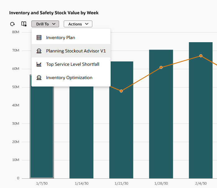

You can configure AI Agents such that you can access them directly from Supply Planning graphs and tables using the Drill To links.
Bar Chart Showing Two AI Agent links in the Drill To Menu

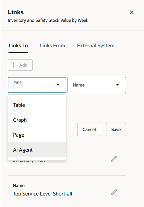

  1. Select Add.
  2. From the Type drop down list, select the AI Agent.

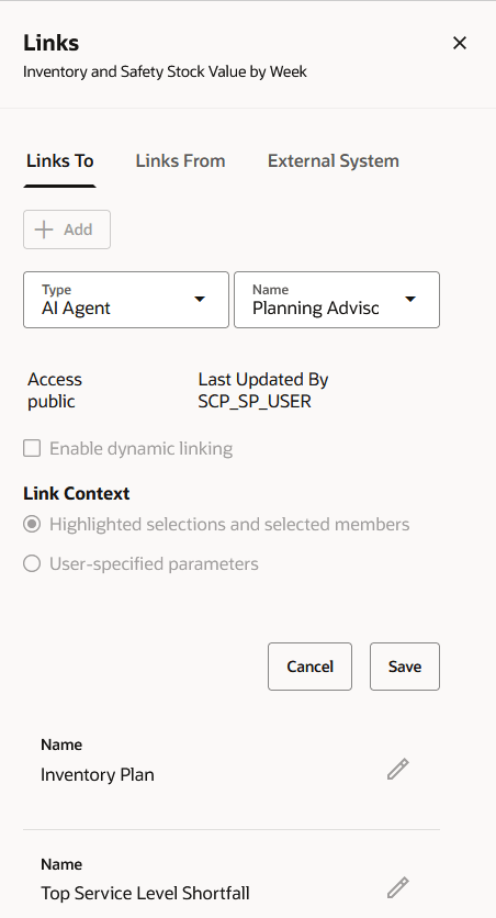

  3. Select the name of the desired AI Agent. The AI Agent list displays the published AI Agent Teams assigned to Supply Chain Planning.
A read-only Link Context section is displayed, showing that the context provided to the AI Agent is the highlighted selections and selected members from the graph or table. The current plan context is also provided.
Configuring AI Agent Link
  1. Select Save and then close the Links panel.
The AI Agent link is now displayed in the Drill To menu.

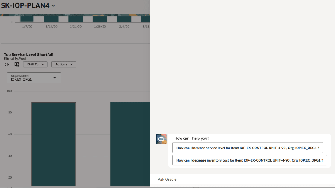

  1. Select the AI Agent from the Drill To menu. This opens the AI Chat, loading the configured AI Agent and passing in the selected context.
Chat Window of the Configured AI Agent
